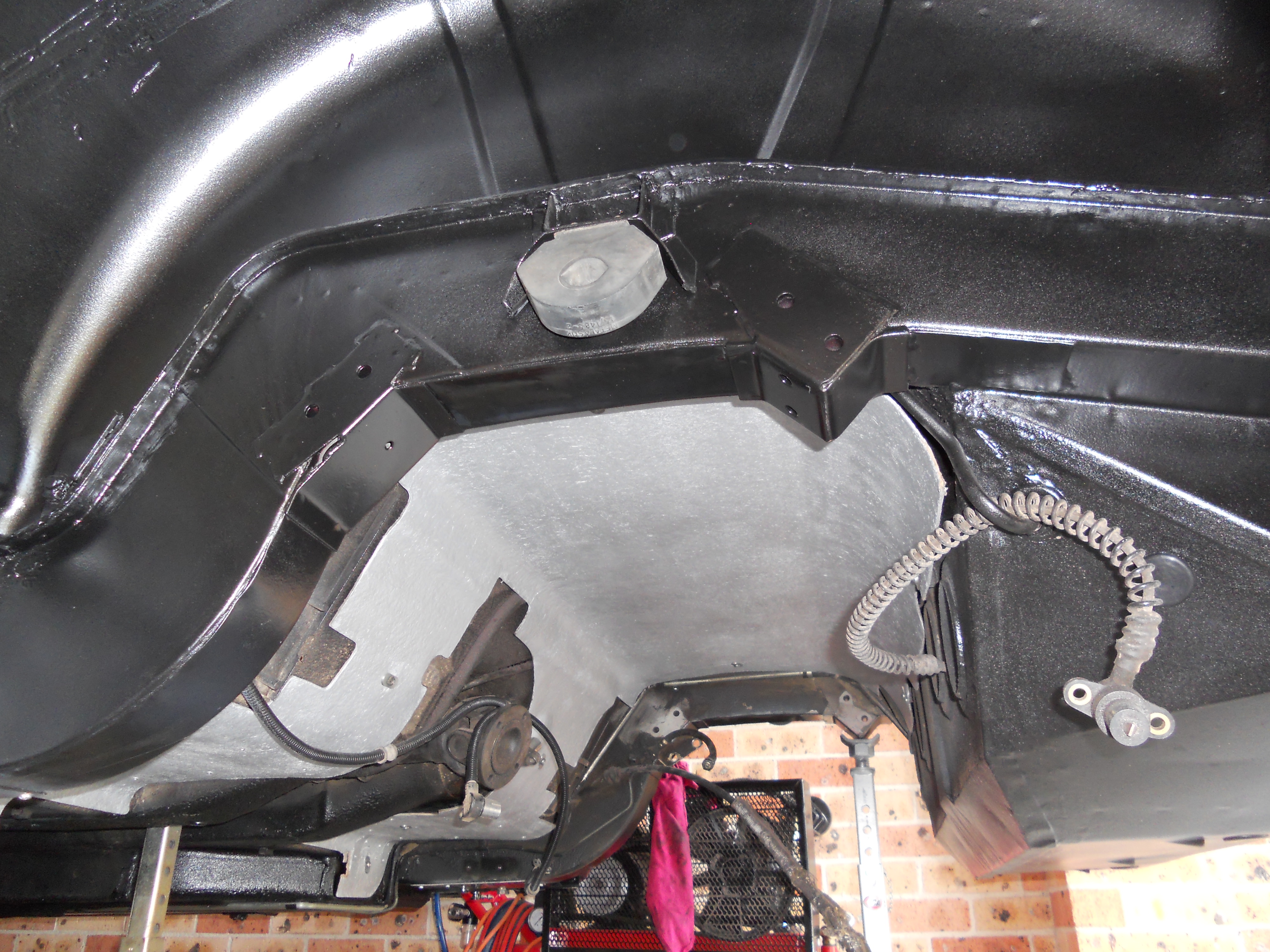

My axle heatshield was attached to raised brackets around the edges of the shield, you can see the raised brackets near the speed sensor and the screw on the far side, the rivet held a plastic white pipe retainer. Maybe it's model year dependent...
When you replace the foam used closed cell so it does not soak up the fuel small.

Warren, that under body looks awesome! Did you remove all the underfloor coating gunk and then use something different? Mine has some coating under there and I was considering removing it all (or better having it removed) and applying some good old Volvo bitumen (stays soft for ever and keeps water and stones away from even getting near the body).
Old Feb 28, 2017 | 03:37 PM
warrjon's Avatar
Posts: 4,638
Likes: 2,583
From: Vic Australia
I removed the underfloor coating from the entire car with a heatgun, paint scraper and wire brush. It took me weeks to get the underbody ready. If I were you I would have someone else do it.
