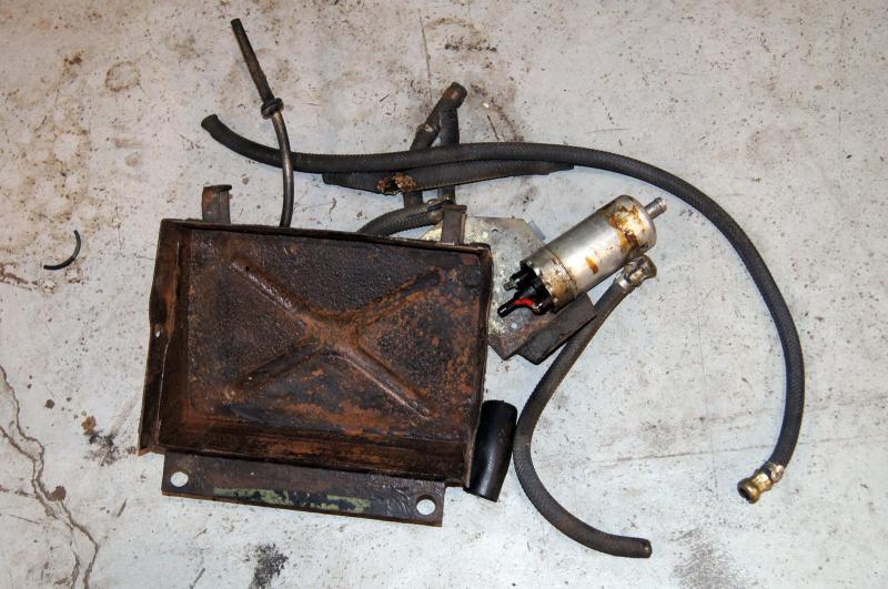

Turned out to be a backfire in the right bank. It cleared up after few starts.
I am still getting used to engine starting like new Honda and revving up in slit second!!! Damn, what a difference
P.S. some pics + junk I pulled.
P.P.S. just noticed that right side O2 sensor was unhooked and both motor mounts not bolted down... damn I am flaky or where!?
Attached Thumbnails Funny clunk in motor - trans area.-bagazn_done.jpg   Funny clunk in motor - trans area.-uzel.jpg   Funny clunk in motor - trans area.-junk.jpg
