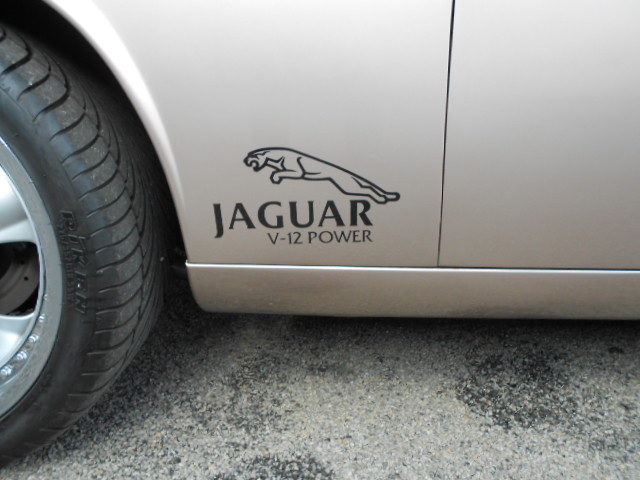

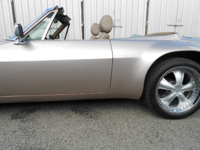

works for me , electric door openers, NO door handles, cant unlock if there aint a place to put a key. 22yrs and holding
Old Feb 2, 2016 | 06:08 PM
ronbros's Avatar
Joined: Jul 2010
Posts: 7,362
Likes: 1,241
1234
Attached Thumbnails Generic Lock Solenoids? opinions needed-jag-strips-10-22-2012-004.jpg   Generic Lock Solenoids? opinions needed-jag-strips-10-22-2012-005.jpg
