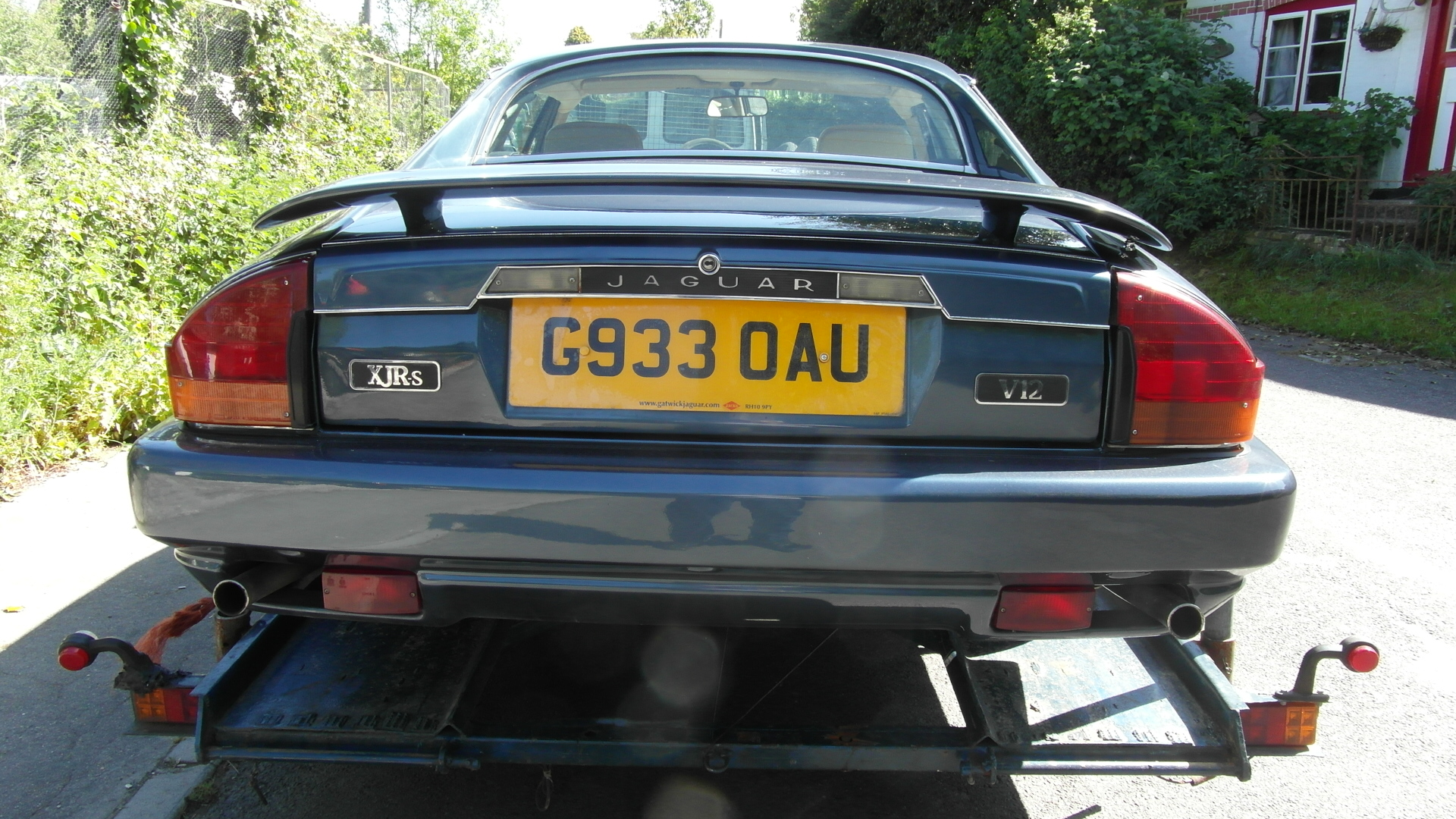

It finally got there yesterday! Huzzah!
The first 2 pictures show the car arriving back, all shiny and ready to unloaded.
The 3rd pictures shows it all loaded up again, ready to go back; bummer!
Looks very nice, handles nice and tightly, will not pull the skin off a rice pudding and makes funny noises, low oil pressure, oil leak.
