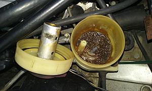

I got a flavor injector syringe for turkey from Dollar Tree and a bottle of brake fluid (not from Dollar Tree). I sucked all the brake fluid out of the reservoir, cleaned the screen and refilled it with new brake fluid. If I do that once a week four or five times, will the new brake fluid eventually make it to the calipers?
Or should I empty my kids piggy bank and get a real system flush? The brakes work fine. My piggy bank is empty, I spent it on another XJS. :-)

That's not going to do anything - you have to open bleeder valves and push fluid through for it to have any effect. If you're not familiar with the concept and practice of bleeding brakes this is one where you pay the experts.

I agree that the method you've described won't really do anything...especially since the system looks pretty well gunked-up. As mentioned you really want to push that old stuff out entirely.
A brake fluid flush is really just the same procedure as bleeding the brakes but you're not trying to get any air out ....so it's pretty simple, really. If you wanted to give it a DIY whirl we can walk you through the steps.

Place a piece of wood, phone book, wad of rags, whatever rocks you boat, UNDER the brake pedal so the "helper" CANNOT push that pedal ALL THE WAY to the floor.
All that GUNK is sitting in the bottom of the master cylinder, and when the "helper" gets to the bottom, that gunk cuts the crap out of the piston seals. Piggy bank get drained some more for a new Master Cylinder.

The turkey baster thing might help in a limited way. But, as Doug opines, the gunk there is formidable. A major strip, clean and replace might be the only way to get a clean system.

I would be taking the reservoir off and cleaning it out before putting new fluid into it. The last thing you want is that gunk going through the system.

If the car is a keeper, I would replace the master cylinder too!

On an ultra-rare car such as this 1975 XJS, I'd change the master cylinder (assuming I could source an original part) AND completely remove and clean the reservoir before letting any new fluid go through the system. Even if you're not changing the MC, definitely remove and clean that reservoir before flushing the system.

"On an ultra-rare car such as this 1975 XJS, I'd change the master cylinder" - that is exactly what I spent my piggy bank on. A December 1975 XJS with a VIN number before the first modification. This one however is a 1988 with a salvage title. A nice rust-free car with a new cooling system, but not rare.

I personally would pull that reservoir and clean it, its remote, so why not? Wash with alcohol, not water.

That turkey baster is useful to empty the reservoir before topping up it up again to start the bleeding cycle.No use in pumping all that dirty crap through the system. Drum brake systems were worse in getting the fluid dirty. Probably because the wheel cylinder itself seldom got hot enough under normal usage, to boil out any condensation. The caliper heats up more and usually prevents condensation. The water in the fluid can cause the fluid to boil under extreme use which renders the brake system useless.
