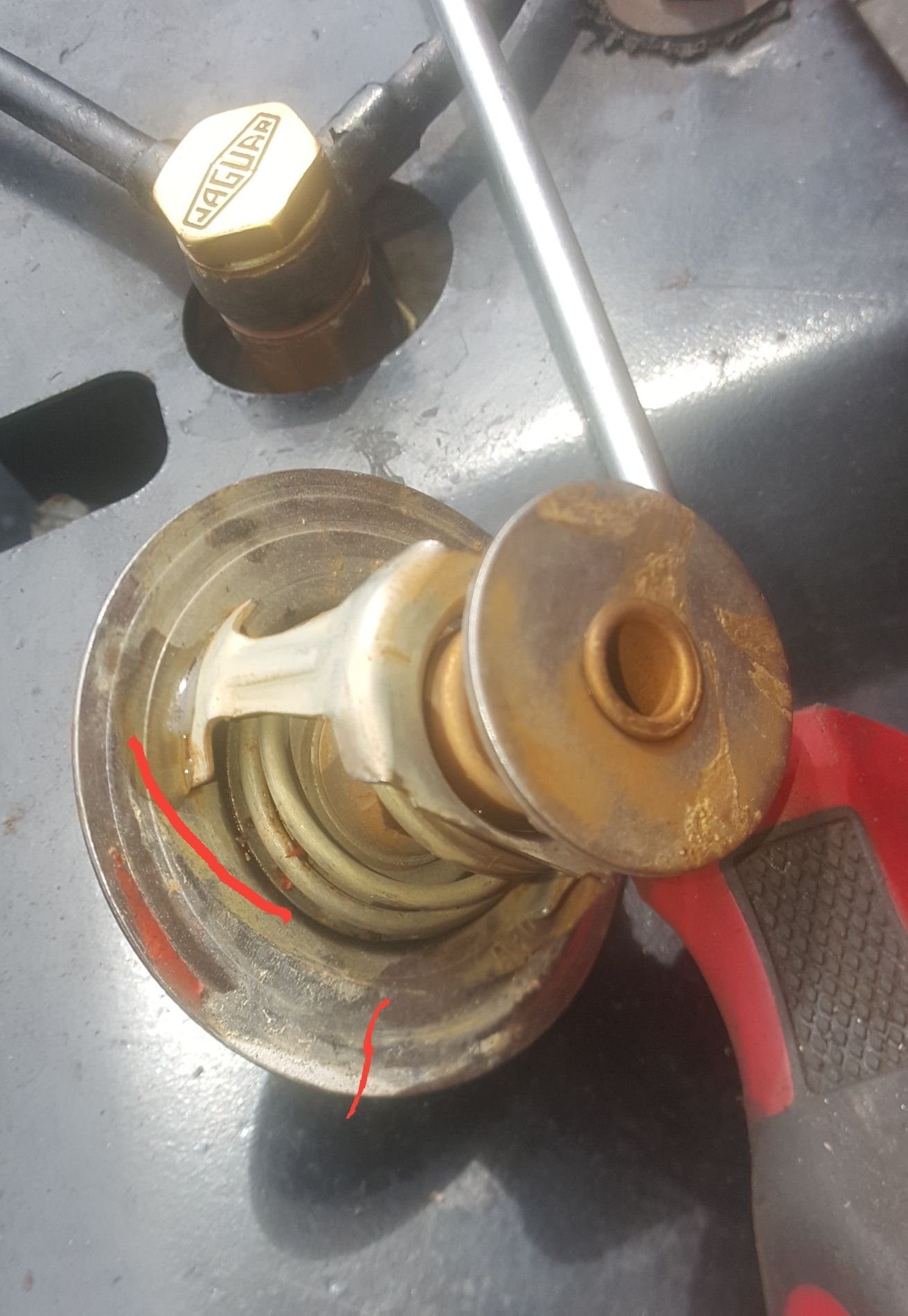

I always tell on my self. Hopefully it will help me change the way I work for the bettah! Yesterday did some stuff that had to do with steering and suspension. Turns out what I thought might be going on, wasn't and the problem... What I had experienced had to do with my own shoddy work or not coming back and giving work done a second look (bearings)... I need to work better. Get better at this stuff. Stop rushing, for one.
Yesterday I went in to try and re-bleed the system, check hoses and such. I tied into the fire hydrant for flush water,(neighborhood kids liked that) during which I drained the coolant. I looked a little while thinking my car WOULDN'T have a rad drain plug (1990), didn't find one, so I used the low hose.
Q: can the car be properly drained/flushed with the nose up? Or does an XJS need to be flushed running, level on the ground?
I drained and caught as much as I could. Messy. But no big deal.
I then removed both thermostats. Plan was to flush for a while with thermostats OUT. And this is what I found. It looks like the RH thermostat was NEVER properly seated in the small groove that runs around the block side of the thermostat casing. That when I went to place the cover (2yrs ago), it had fallen out of its groove and got pinned between the two faces of the thermostat casing BEFORE I could place the outer face. 2+ yrs!!! NEVER leaked, overheated or ran hot until I did a top end refresh 2 weeks ago - intake and cam cover gaskets. Used RTV and a gasket on the thermostat, which probably explains the no leak. I felt and looked onto the casting for the thermo and there is no way being THIS out of line, the thermostat could have ever have sealed or blocked completely the inner coolant flow/direction port as designed. Bugger.
I used some red markings. If you look closely you can see witness marks that show how FAR thermostat was from being centered in its seat. Gasket had indents where misaligned thermostat sat for 2yrs. CRAZY SHODDY.
So, I reused old gaskets with a smear of RTV (no leaks) and carried on.
Telling on myself again - nose up, I started up the car and filled it slowly as described. Thermostats in of course. Slowly slowly and things started heating up. Got steam coming out of the bleed, followed by geyser of air and coolant, and then pure coolant, and a bit bubbling out of the reservoir. Capped reservoir and continued filling (couldn't over worry about coolant on the street - feel wrong about it but HEY!) at which I went with the bleed screw taped on a 12mm socket and got it covered. Then capped the main tube... Done????
MISTAKE - can you BELIEVE that I never went and tightened DOWN the bleed screw!?!?!? Drove 12+ miles. 80+degrees and the car ran much cooler (like it used to) for a while, then started getting hot again. Got to my destination to realize that I had FORGOTTEN to tighten down the bleed. Thankfully it was still there, loose, but there! For my neglect I had lost more than 3/4 of a gallon of coolant between Staten Island and Brooklyn - AND MOST LIKELY HAVE TO REPEAT THE WHILE PROCESS,,,, feeling like a dope. Not toooo terrible tho. My girlfriend is laughing at me 😂
