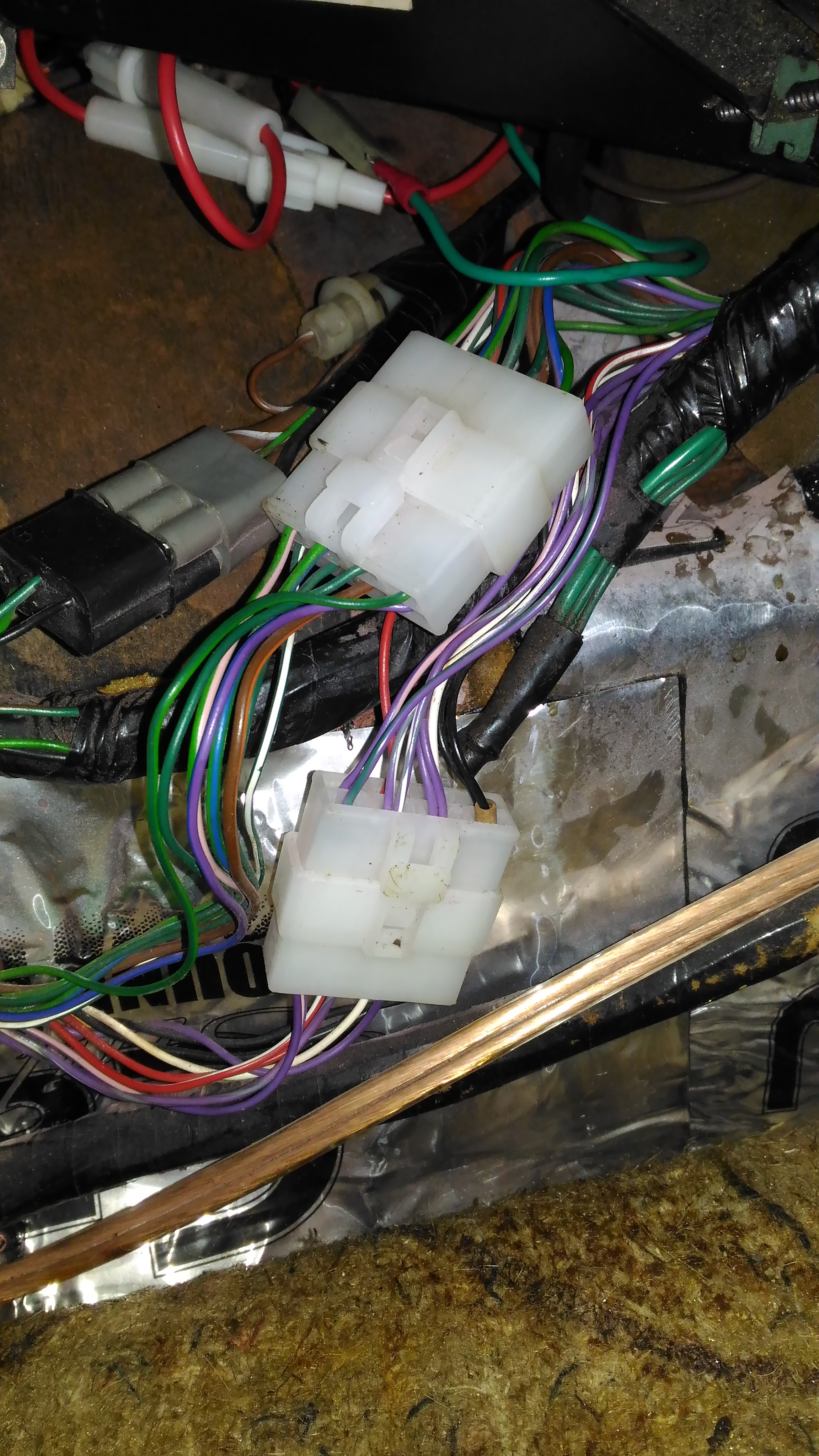

If its inside the car I use a general purpose automotive connector, these are cheap and reliable if not subject to weather and dirt.
Outside I would definitely use a sealed automotive or military connector.
I replaced these a few years ago as they were full of old coolant from a leaky heater core.
