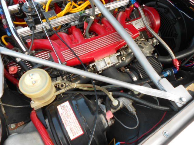

rear body flex area, this stiffins it up!
pic of my cross brace on XJS that is a cross the upper body above the shocks, it does stiffin up the body structure , along with the diagonal braces , also there is a front cross X type front of radiator!
it is surprising how much flex is in the XJS unibody, pic of rear section that can flex(i think this got it covered now).
