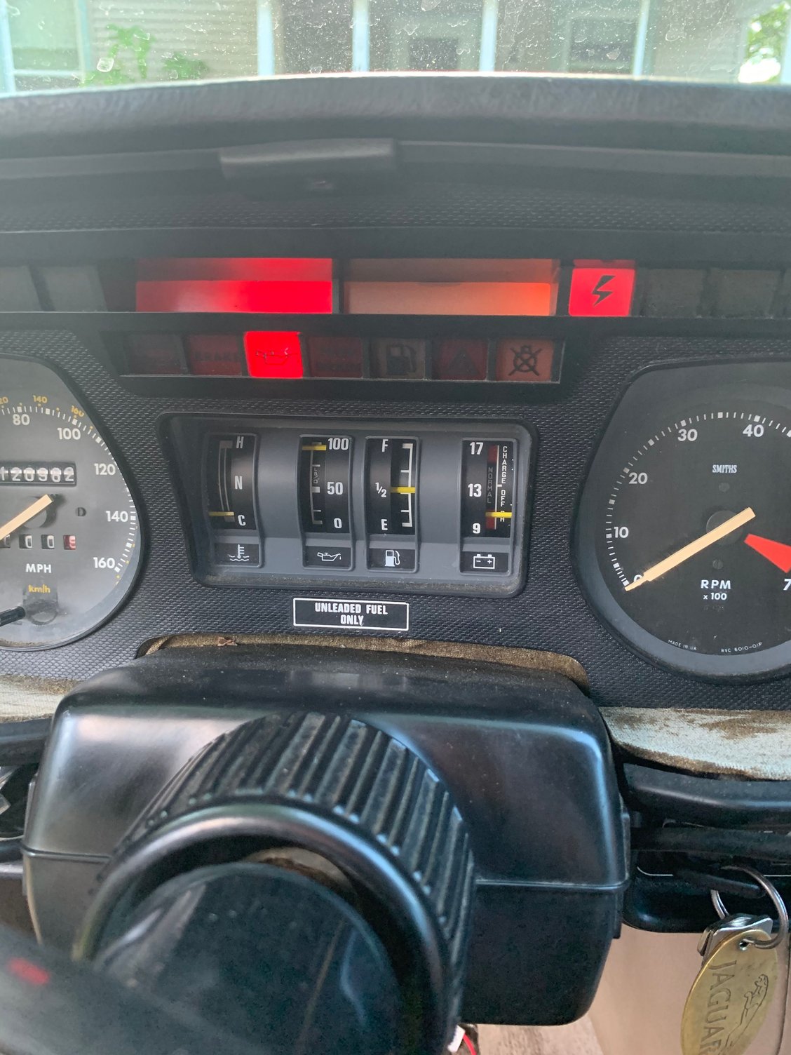

As the title says, Im currently having problems with my directionals and hazard switch. The directionals worked fine since Ive bought the car (about a month ago) today after driving I noticed I got no click noise from the flasher, and the turn signals were not coming on. After checking the fuses, that turned out to be okay, with the exception of a little corrosion on the block. I did some research and read too check the hazard switch to see if its functional, as it could be a reason for the turn signals not working. When I clicked it in, I heard a noise under my dash that sounded like something shorted, I believe its one of the wires going to a fuse. After doing this my instrument gauges do not work, my radio does not work, and my climate control. Did I blow more fuses after using the hazard? I believe the switch functions by grounding two wires. Any help would be appreciated, Im still learning with Jaguars.

Now thinking the hazard switch is not properly working. A diagram shows two clips behind the radio that route too the switch. When I smack the dash my rpms slightly jump along with my speedo. Is there any spot I should check in particular for a short or lose plug. Any advice is greatly appreciated

Weird **** happening now, I replaced fuse 3/4, gauges came on, after I started the car and turned it off, everything was dead again. But now for some reason my hazards work but my directionals dont come on when I hit my blinker switch.
