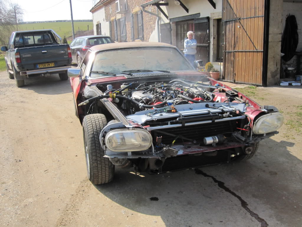

Grant's memory is 100% correct, of course. There are tubes that the rams fit in. Remove the rams and into the tube goes a long double ended stud. Onto each end of the stud goes a round washer-type thing that fits over the tube. Do up the assembly so the stud is held in the tube bolted up with a washer each end. this will leave a bit of threaded stud protruding forwards. Onto these the bracket on the HE bumper bar bolts.Tthe same arrangement front and rear bumper.
On this pic you can just see the tubes half off the shot, each side of the car above and outboard of the oil cooler:
On this shot you can see one tube empty and one tube with the stud and washer in place:
