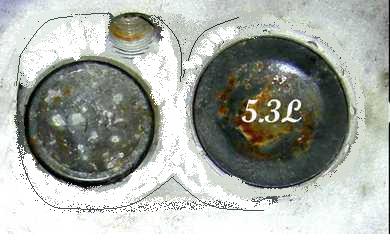

Question - has anyone successfully machined the combustion chambers of the 5.3 HE head to open out the pocketed exhaust valve? The chambers are simmilar to the LS7 except the HE exhaust valve is recessed in relation to the intake.
The 6.0L looks slightly better flowing than the 5.3, but I am sure this can be improved further.

What I am talking about is re-shaping the that chamber to smooth the contors around the exhaust valve, remove the steps and have a gradual radius from the bowl out.
This pic kind of shows but it is hard to mock up in Paint

OK warren, looking at the 6L chamber it seems as tho you could bring the wall out to the gasket edge and blend the hard corners of the exhaust recess. (yes it would lower comp.ratio slightly,but acceptable).
examine,the area where the valve comes close to the edge of liner,and maybe chamfer it??

That is exactly what I was thinking - smoothing the hard edges and then polishing.
I am not too worried about the CR as I will either turbo/SC or increase the displacement either way I will need a larger combustion chamber. I have estimated if I go 6.1L (93.1x75mm) the chamber will need to be increased 14cc for a CR of 10.0:1. Or to go 8.5:1 for turbo the chamber will need to be 53cc.
I estimated the 6.0L with CR of 11.5 = chamber 6cc bigger than the 5.3. So I have quite a bit to play with.
