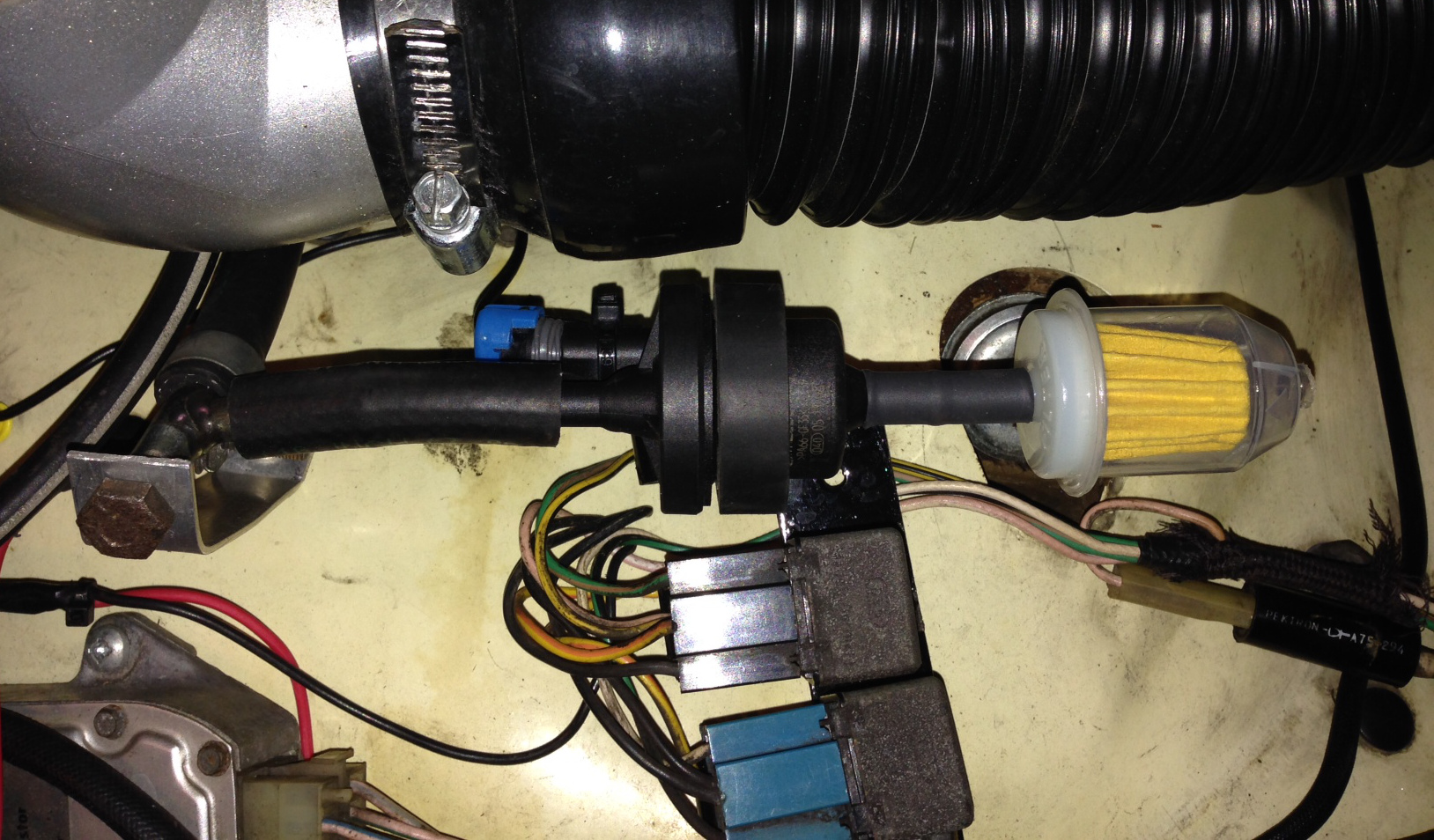

First of all, I lied :-), or rather, got confused. My AAV is questionable, but my SAV was definitely kaput. The car never had a problem starting during the warm months, but now that it's cold again I really had to work the throttle for about 30 seconds or so to keep it going.
My temporary answer is pictured below. This is a pic of the right side of the engine compartment. You'll see a hose coming from under the large silver piece (part of the cold air inlet). The end of the hose you can't see attaches to the large port on the bottom of the right hand throttle body. The hose "tees" into an electric air valve that is supposed to go into a Mazda. At the other end is a yellow filter which is open on the right side to let engine compartment air in. The whole arrangement is somewhat sloppy, but those are the parts I had on-hand.
Since my 45 second timer is also broke, and I've removed the cruise control with no intention of ever putting it back in, I've wired the air valve to the cruise control on/off switch. This is just a temporary expedient until I come up with a 45 second timer.
I've found that with this arrangement I get about 200 more RPM right after start with the air valve open. Having said that, I have also found that I get about 300-400 more RPM by just having the the hose open to the atmosphere, i.e. no air valve or filter. The air valve may be a little small...not letting enough air in...and when I redo this modification I'll use a larger air valve and a larger filter.
As I said, this is a temporary measure until I can come up with something more automated. If your 45 second timer still works you can use it to open/close the air valve.
FYI, when I had my AAV out, I soaked it in cleaning fluid and had it working pretty well...when I'd stick the bulb end into hot water I could watch the piston move as it's supposed to. I could be that it's just about worn out, in which case I'm happy being able to get some extra air into the engine with the makeshift SAV, otherwise I'm not sure what I'd do.
