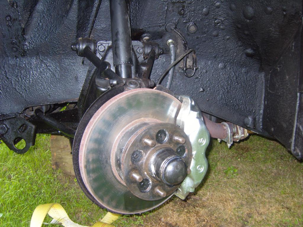

Hi Sainmatt
I have just been through a similar 'Nightmare' myself, putting my 1989 XJS V12 back on the road after an 8 year layup.
She had just gone through an MOT where all the Brakes were passed as working fine.
But after a number of Test Drives to sort out a 'rattle' on the Exhaust, I was on my way home doing 70mph when I noticed a smell of burning and then minutes later, clouds of white smoke were coming from the NS Wheel arch.
Followed by Total Brake Failure! The Pedal went right to the floor! and I was very lucky that the car did not catch fire and explode in a fireball.
This was the result of a Sticking Front Caliper, which made the Brake Fluid Boil and I lost all the Brakes.
So bearing in mind you are driving one of the nicest Jaguars ever made, that probably cost around 50 grand New, it doesn't pay to cut corners, or You will either Kill or Injure Yourself and or Somebody else!
I faced the same dilemma as You, as to whether to rebuild the Calipers but the easiest and the better way is to buy new (Service Exchange PX Your Old Ones For Rebuilds)
Don't just stop there either! Put on New Front Brake Hoses And New Brake Pads and get yourself 5 litres of New Brake Fluid.
But before you fit the New Calipers undo the Bleed Nipples on the Old ones and pump plenty of fluid through to get rid of the Old Brake Fluid and Flush out any impurities in the system. (which is why to buy a 5lite can)
Don't re use the Old Fluid or even put it through twice and whatever you do, keep it off the Paintwork.
Its going to cost you a few bucks but if you have got your Brakes Working, don't be in denial that everything is Ok because what ever happened before, is going to sooner or later happen again!
And just remember the next time you may not be so lucky!
What you need is peace of mind, so don't 'skimp' spend the money! and then you can relax and enjoy the car.
That includes New Brake Pads and New Hoses, even if the Old ones look Ok! Anything to do with Brakes, is a place where you don't cut corners.
'Do it Once and Do it Right! (Credit to Grant in Aus)
As far as Jacking her up is Concerned, I would never Trust Axle Stands, as if something slips you are 'Toast!'
Instead I have a Big Block of Wood which I put under the middle of the Steel Front Beam.
Then when the Car is lowered down, both of the Front Wheels will be off the ground (so slacken the wheel nuts off first)
This is by far the easiest and the Safest way I have found to do the job, as then you can work on both sets of Brakes at once.
As I was also going to have to bleed the rear Calipers, I did a very similar thing on the back, with a big block of wood under each of the back Axles but don't jack it up or block it up on the rear diff.
Use a substantial Block of Wood!, I am using a 12inch X 12inch Block of Oak!
When you put on the New Calipers, put in the New Brake Pads BEFORE you even attempt to Bleed the System, as the one thing that you MUST NOT DO! is anything that is going to send any Brake Fluid up to the Master Cylinder, or there is a very High Risk that you will mess up the Valves in the Master Cylinder. And that will be VERY EXPENSIVE to sort out!
You may get away with it on any other Car but on an XJS its like Russian Roulette! So don't be tempted to risk it, or you may end up with an XJS that Brakes Violently to one side without any warning!
