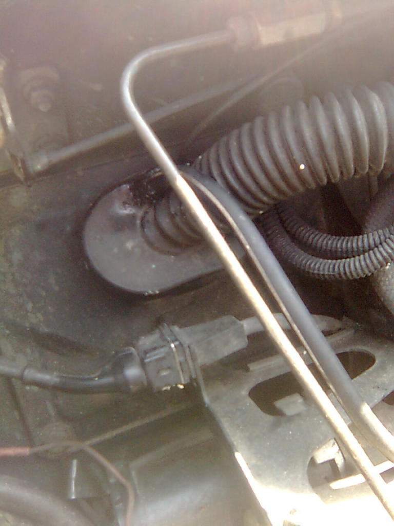

As someone who has lost 2 ECU's from water ingress in my 95 AJ16 car, I have two comments;
1- seal the wiring harness entrance with silicone. The water comes in thru here when you wash the car or when the a/c water drops make their way thru the cables all the way down to the connectors and ECU
also buy the Ford XG-12 synthetic electrical grease and smear a thin layer over the connectors and pins as it is specifically designed for that pourpose. Dielectric grease is NOT meant to be used in connector pins. The Ford XG-12 is repackaged Nyogel 760g if you want to look up its properties and usages. This is what Ford under the name of XG-12 and Masserati use on their ECU and all their multi pin electrical connectors to specifically prevent water damage.

Spikepaga,
Not sure I understand your photo!!
If your ECU is located in the same spot as mine....Passenger side of car inside engine compartment basically on the right front fender well below what looks to be an eletric motor and brake lines?????
I was cleaning the engine compartment and got water on the multiple pin connector..Both sides of Male/Female.
Cleaned off with contact cleaner, Wifes hair dryer and it fired right up.
On a really huge rainstorm ~ a month ago which I was driving on I-75, had to stop/slow down couldn't see.....I never had any issues!!
Can't tell from the photo what you are pointing out... Is it the Connector??
Suggestion for the coating w/electrical grease is a Great Idea!!
