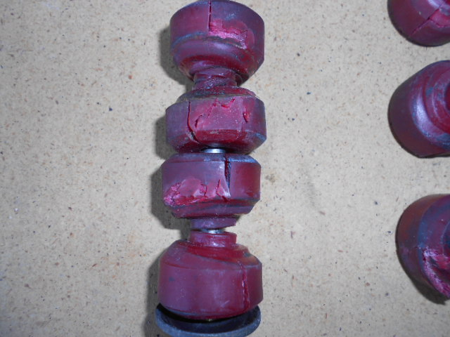

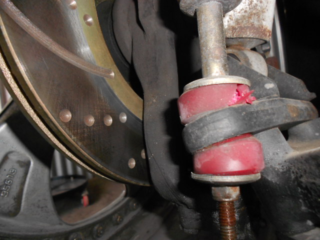

i had to replace my anti roll bushes(easy to do), my frame bushes seem to be OK.
i dont care for poly bushes , mine were 2-3yrs old and cracked apart!

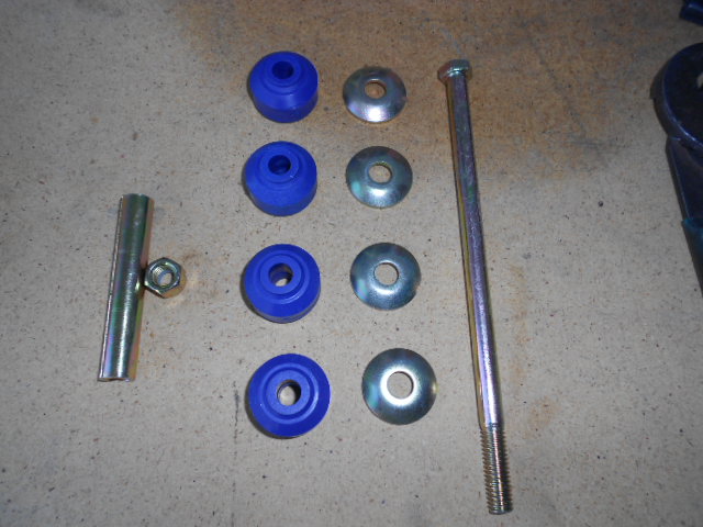

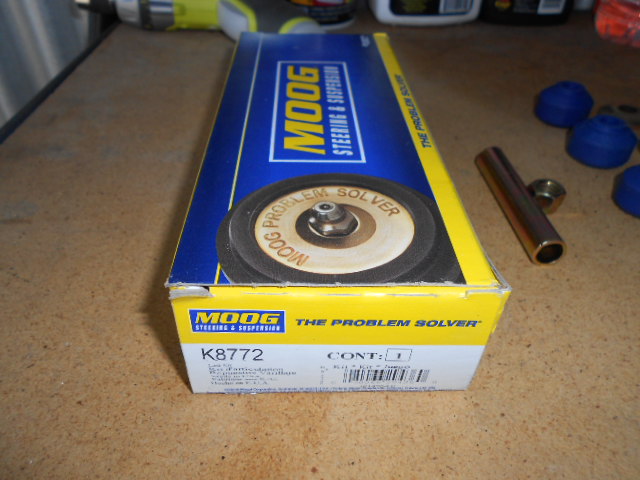

my new bush kits from MOOG USA.
altho i had to shorten the spacer tube and buy shorter bolts, all else fits fine.
