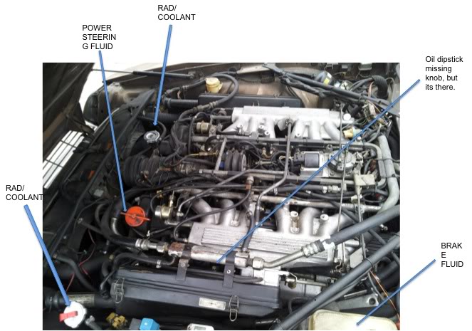

Hey Guys...I couldn't locate the dipstick for the tranny fluid. Here is my engine..
Old Jun 14, 2012 | 12:44 PM

The big red one is oil fill!!! Don't put power steering fluid in there!!!
To find the power steering fluid, look at the red oil fill cap, then follow the side of the engine block down. The power steering pump is mounted at the bottom-front of the engine and the black cap is pretty much directly below the oil fill.
Jag hood struts $12 each from Rockauto, this is no mystery. Supposedly the Honda ones are also under $20 and they push the hood open further but I can't confirm. I've already got plenty of room unless I'm pulling the rad.

Trans fluid is located at the very back of the engine, within that mess of wires under the passenger's side cowl strut. Basically look on or almost on the firewall directly in front of the passenger.
