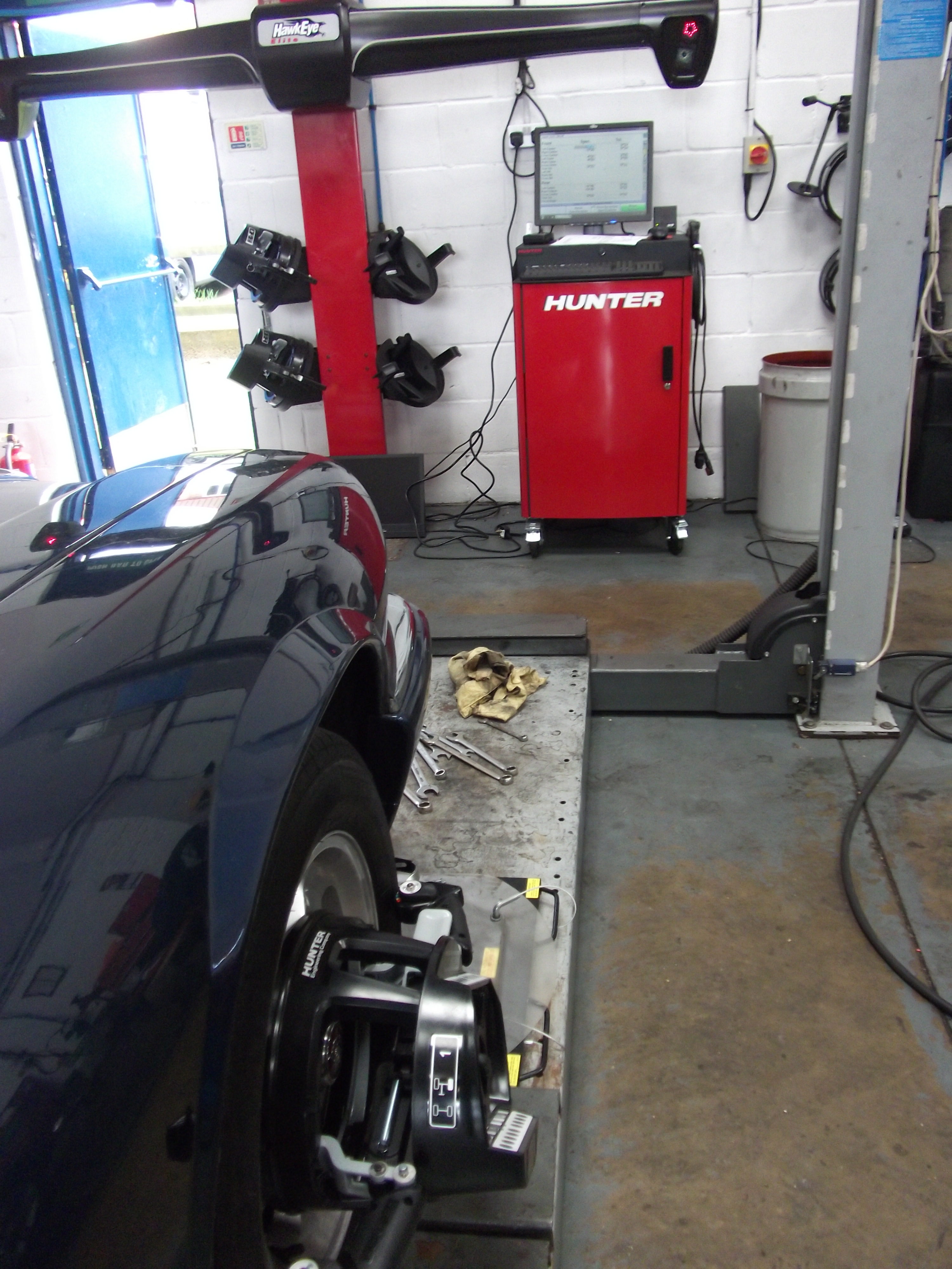

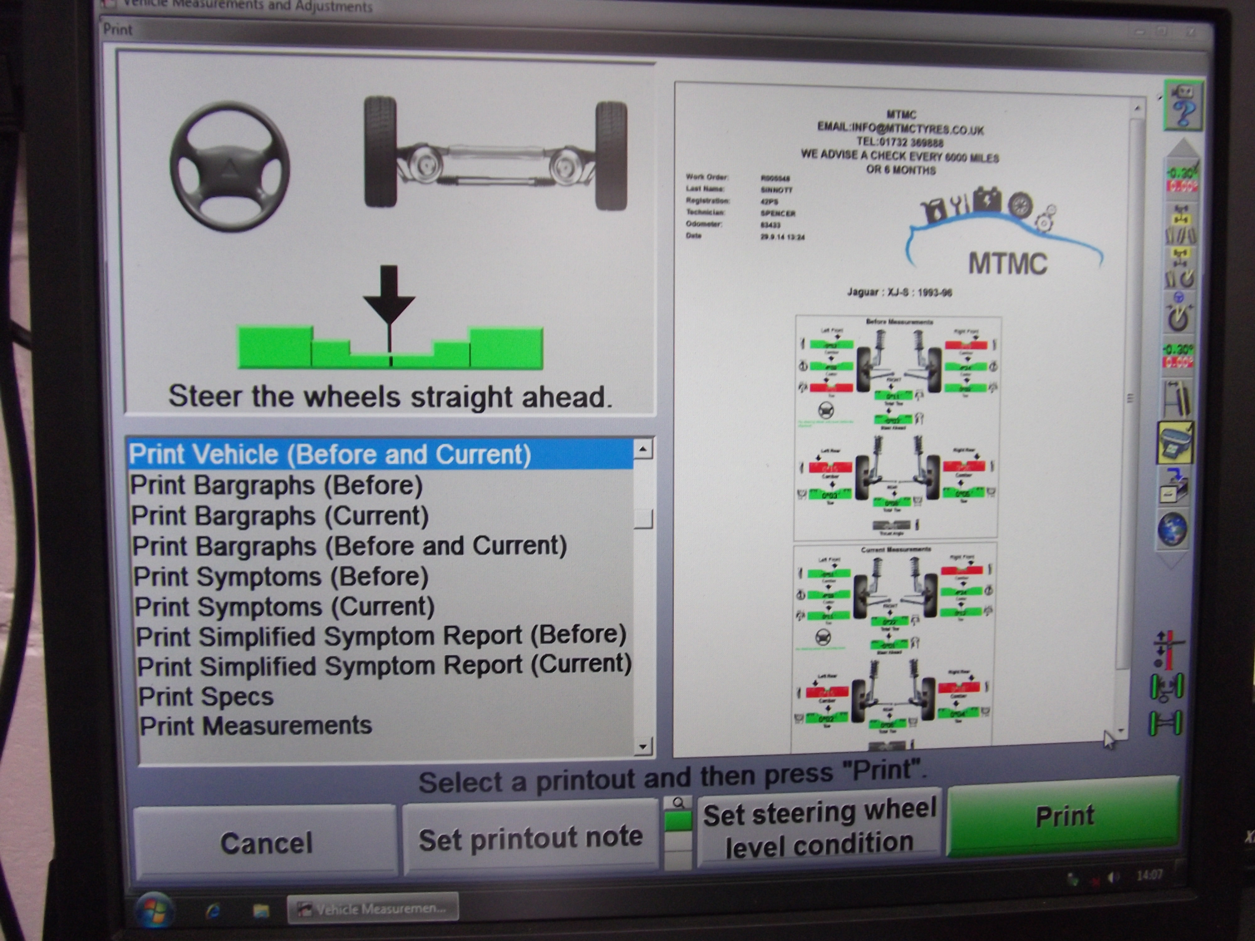

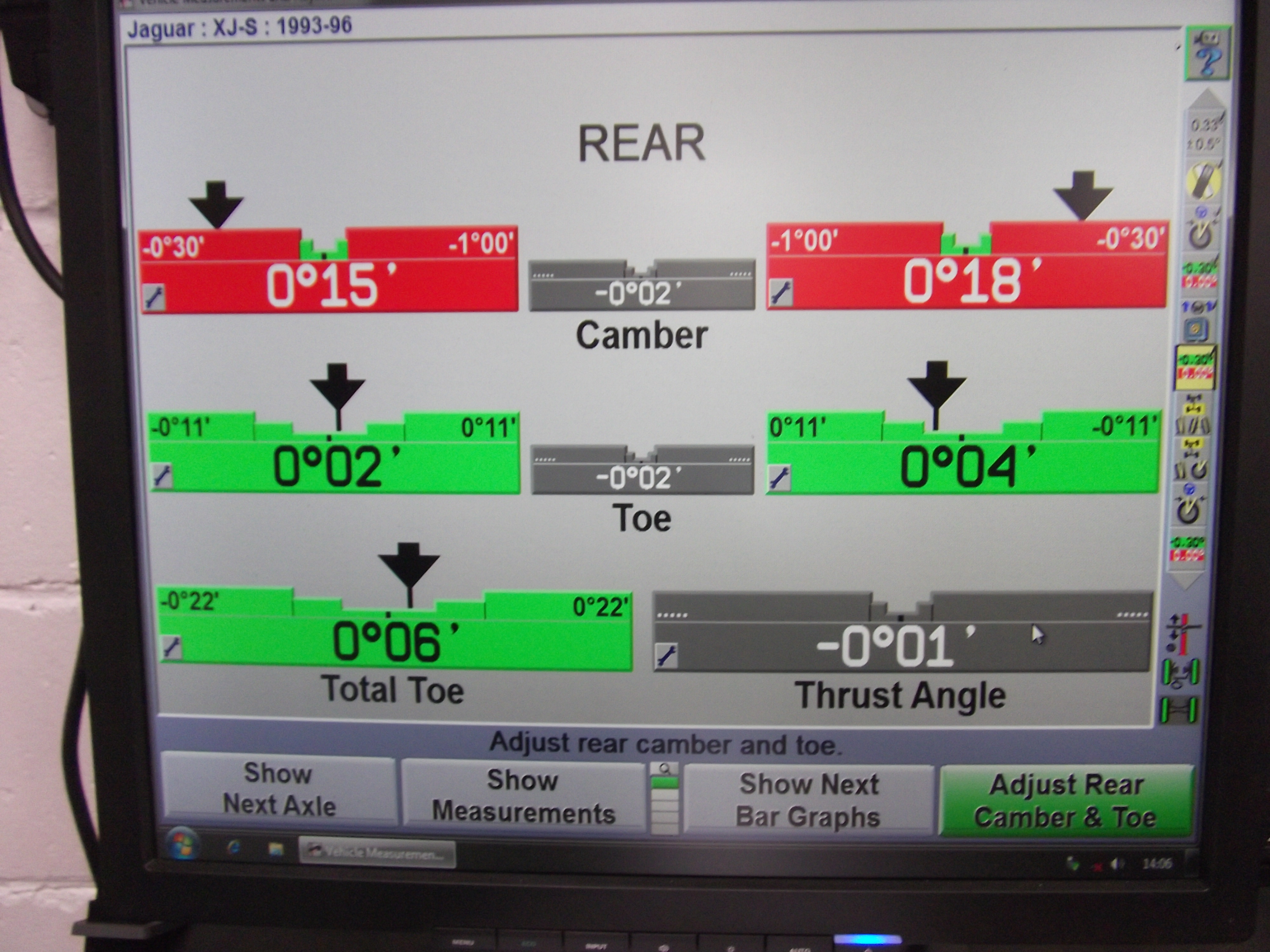

Greg,
For my XJS, I use MTMC in Tonbridge. The pics below are from my last XJS visit there. The software is very comprehensive. It even advises the operator to use Jaguar tools to tie down front and rear subframes at correct height as part of the procedure. The bed itself is so sensitive that for some cars such as Lambos they've had to close the bay doors, turn off the compressors and all stand still whilst they take the readings! I guess that's what you get if you spend £50,000+ on a Hunter alignment bed!
For my x350, I used ProTyre in Fareham as I was having my rear lower wishbones fitted in that area and my mate had "trained" their technician exactly how to set up an x350 (which is critical to setting wheelbase length correctly first). They use similar software and printouts.
Paul
