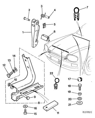

So I just changed the engine and its running great. The problem is I can't find the bag with the hood and grill hardware. Does anyone known the size and thread count of the hood hinge bolts.
Number 12 in picture

My '85 was 1/4UNF.
The '86 was 6mm fine.
The '88 had 2 of each, so a hingechange in a previous life me thinks.

My '89 is 13mm AF on the head, that should make it an 8mm. Imperial would have been 5/16"
Not sure 1/4" would have been up to the job.

OOPS.
I buggered that up badly.
Thinking of the wrong bolts.
8mm or 5/16 is correct.

They turned out to be 5/16 fine thread.
Thanks for your help
