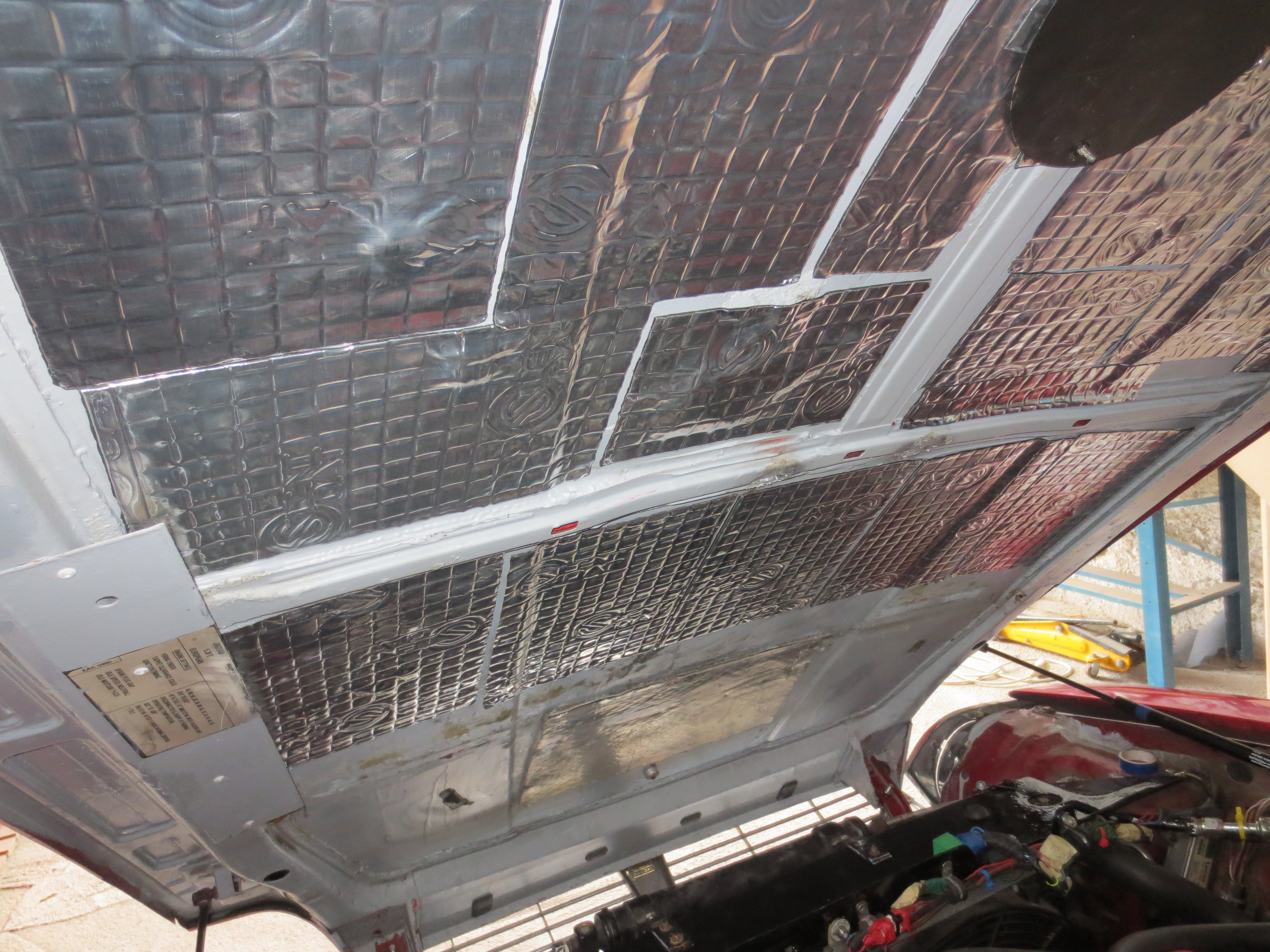

This is, as far as my experiments and measurements have shown, 100% true. I will in due course post some details, but in outline, I recently did some experiments with holes in a spare old bonnet (hood) to simulate louvres. The first time I fitted the bonnet with the holes, I found the underbonnet temps that I was accurately measuring were WAY lower. Bingo, I thought.
Just to be sure I covered up the holes with cardboard and did a comparative test. Only a VERY small difference in the temps, at most 3C. Disappointed does not even begin to describe my amazement at this result.
So I got to thinking what was the only difference between the normal bonnet and the old one, when the holes I had cut were blocked off. And it was the OEM insulation, which is about an inch thick, and hangs down here and there from its fixings.
So I replaced the normal bonnet and removed the OEM liner. Underbonnet temps come down by 7 or 8 degrees, a LOT more wind noise without the liner though. So why the temp drop? I believe two causes:
  • The upward facing rear lip of the cross radtop panel shuts against the OEM liner, without the liner, speed-rammed air can flow above the panel into the engine bay far easier
  • The liner itself blocks off air circulation as it semi-rests on bits of the engine here and there (eg injectors, aircon pipes, etc.
So I removed the radtop panel and reduced the height of the vertical lip by about 6mm, and in place of the OEM liner fitted some modern butyl rubber-based insulation called Silent Coat. Thirty self adhesive panels from Amazon at about 30 UKP, so not at all dear. A breeze to fit and only 2mm or so thick. Results:
Car quieter than with the OEM insulator
Under bonnet temps stayed lower than before.
From all this I conclude that promoting more air flowing into the engine bay from around and above the radiator is the best way by far on our cars to reduce under bonnet air temps, and exchanging the OEM liner for a thin modern version is an easy way to do it.
Greg
Greg
Got some of this Silent Coat and replacing my hoodliner. Does the sticky side hold in the heat or did you use 3M #80 spray gule as well?

It held on like a drowning man to a life raft! Be very carefull to place it exactly first time as it grips straight away.
Yes I gave it a good go. Measure 5 times to Fu*k it up once... So made paper template from measurments. Offered template up and had to make large adjustments by folding the paper card and taping it to the hood. Spent most time getting this right. Just did one side as then mirror the pattern. Cut out the sheets and found I could make it fit with 10 sheets. Worked very well, I use a paint brush and roller to flattern it back and then I hot the Silent Coat roller today and finished off the edges.
Yes it is the stickyest stuff in the world as an off cut stick to my shoe sole....
Test drive today and workwd really well, much lower temps pn top of the hood 45 not 65 °C. Engine stayed very cool and the silent coat stay on very well. Higjly recomend this stuff of you are doing the liner and can be done while on the car if planing is very thourogh and you know what piece goes where first time.

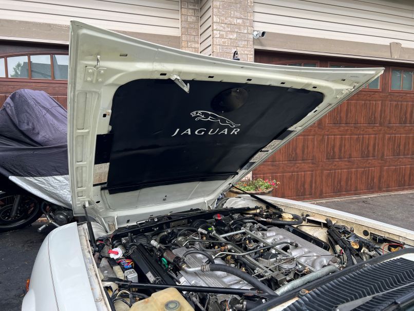

If you all are looking for a nice looking quality bonnet liner, I got a great one with a jaguar logo on it from Nicole here: https://www.hoodliners.net/collections/jaguar.
