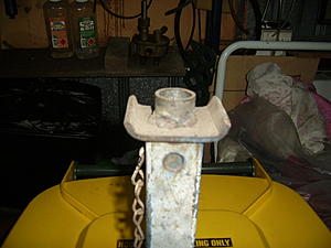

I used standard jackstands, and simply welded a piece of water pipe onto the platform of 2 of them. This "tube" slides neatly over the jacking points, so when you are pushing and pulling at anything that is stuck, the car CANNOT fall off the stands and bruise the skull.
