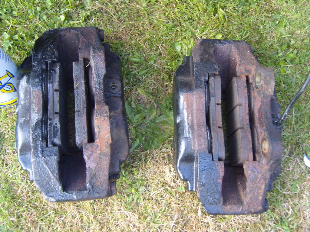

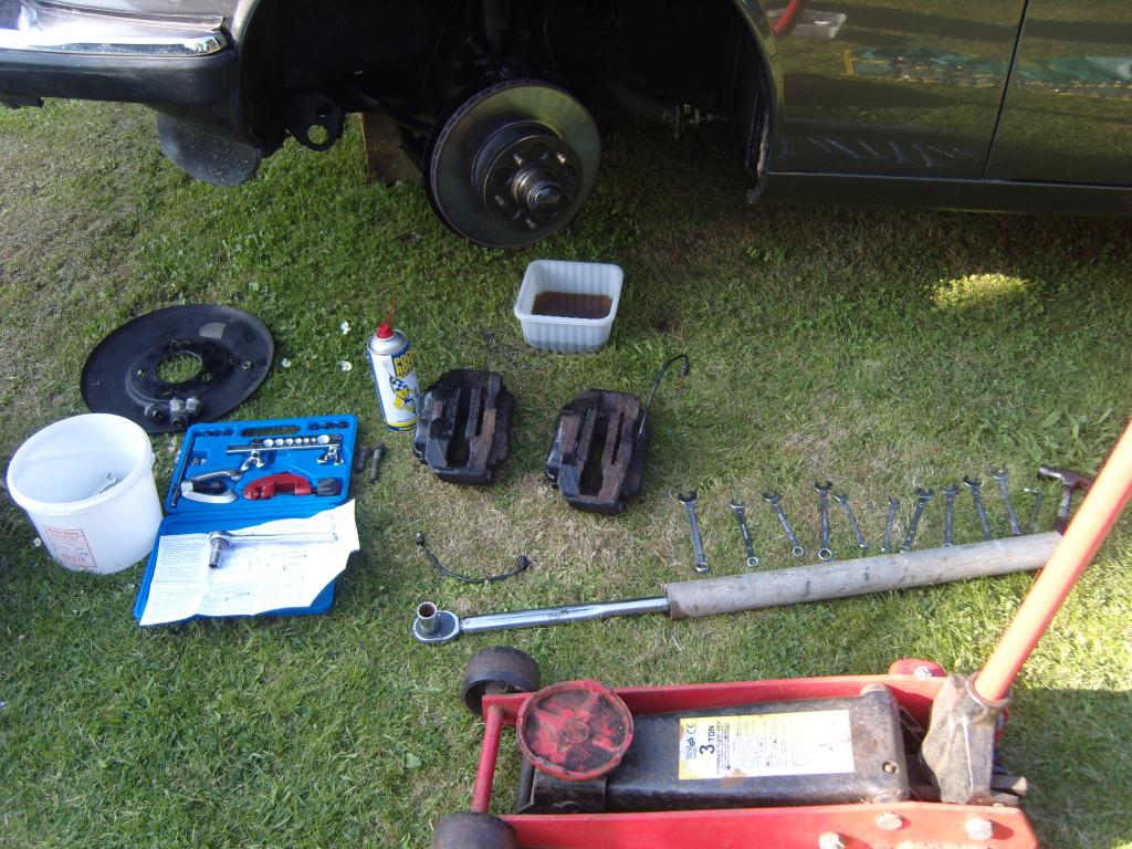

Getting the Calipers off was a piece of Cake! (Not!)
Torque wrench connected to Scaffold Pole with a Hydraulic Jack underneath and when that didn't work, I put a spanner on the nut and Hit it with a 7lb Sledge Hammer!
The Spanner Broke but the nut came undone! So in my book that's a Result!

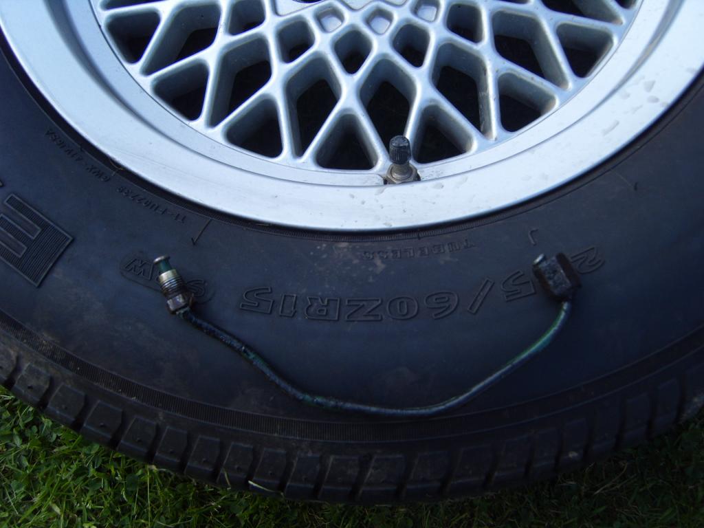

Not so with the Brake Lines! The Hard Lines under the bonnet are fine as I was very Careful like you said.
But the Lock Nuts on the Flexibles are Rusted Solid, so its going to be an angle grinder job!
Finding some new lock nuts is going to be a problem, as they don't include them with the hoses.

Great stuff. But your torque wrench is now most unlikely to measure torque properly, so do not trust it for that purpose! You need to buy a breaker bar for the future!

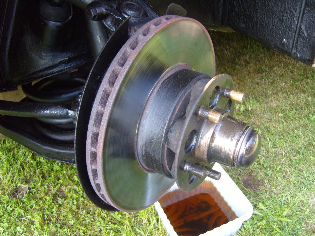

OB,
Just a couple of thoughts:
- I never use a torque wrench to undo nuts. It's designed to do up nuts and indicate when the effort has reached a defined level. Throw it away now, buy a new one and only ever use it for doing up nuts.
- those discs and pads look very good, plenty of even meat on the pads and nice even conract area on the discs. I'd reuse them.
- still don't know what year car you have there, but the manual is clear on the bleeding process
Good luck
Paul

I've only ever used the Torque Wrench, for doing and undoing the Road Wheel Nuts.
I'm not a proper Mechanic and if you need anymore proof of that, I buy all my Spanners in the Pound Shop!
Surprisingly they seem as good as the expensive ones, until you hit them with a 7lb hammer and most of the time they don't break.
Though not in the way that my Car has been recently doing!
I'm about to spend a small fortune to-day and Greg would never forgive me if I cut corners and didn't put in new pads.
So if the GF has to do without her Pina Coladas so be it, she will have to get hammered on Absinthe, like the rest of us!
