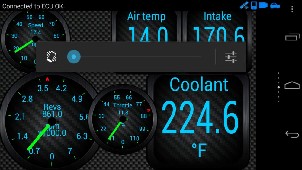

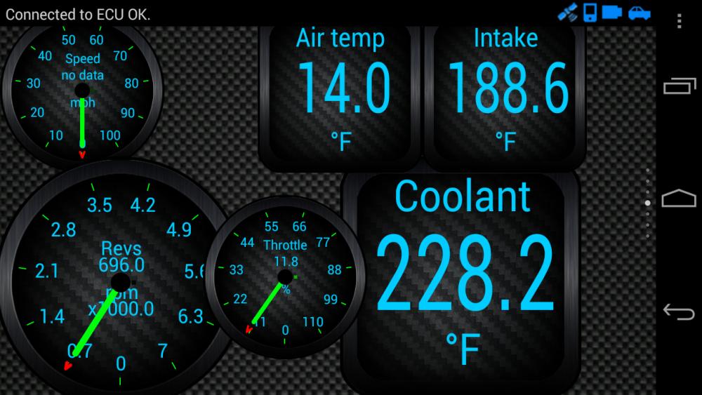

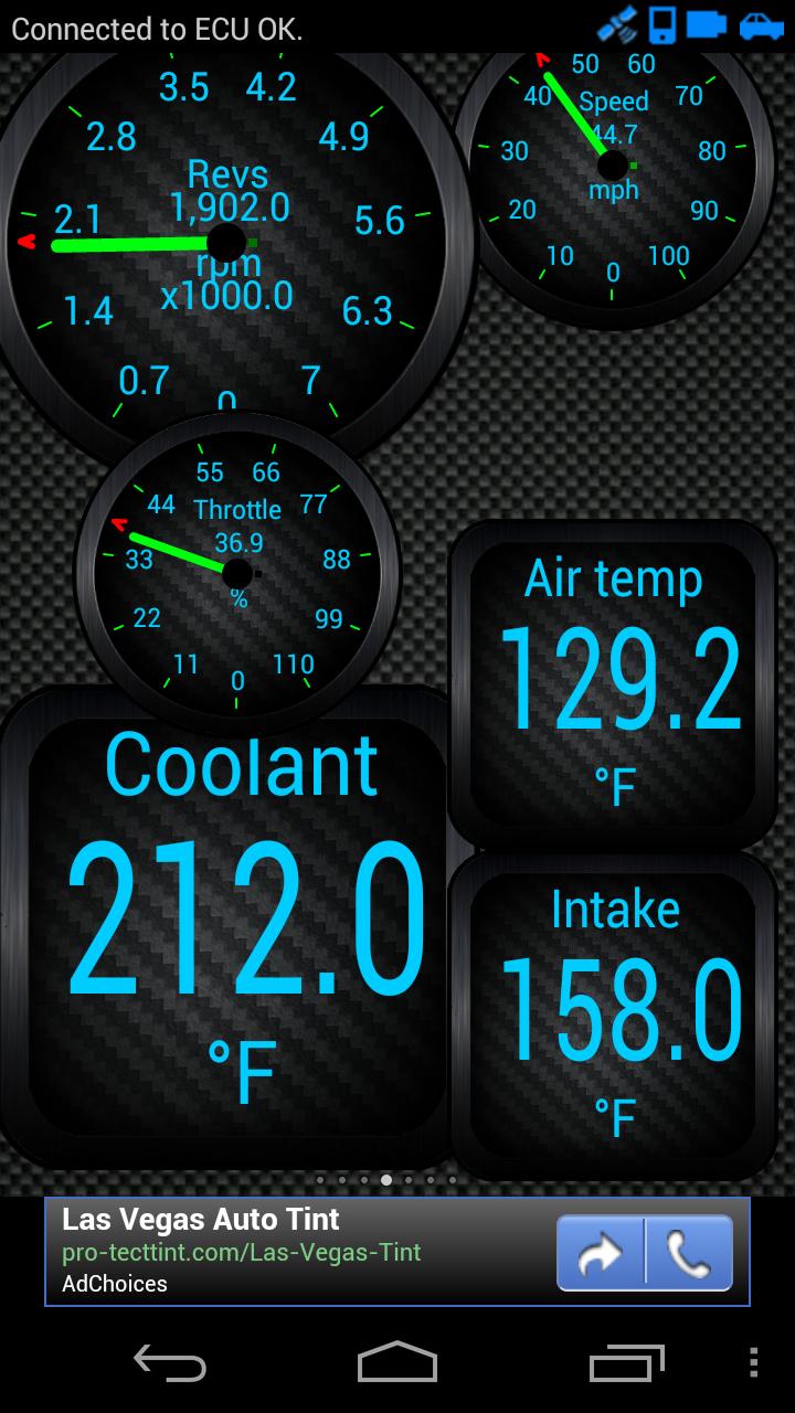

These are the Temps I am getting from the past several days. When gauge at the "N" Coolant is at 195F. 228F is the highest i've seen, but the gauge has never been into the red. I have noticed that the AC is effecting the temps because if I start the car from cold without AC on then drive in the stop and go traffic the gauge never goes leaves the "N". Soon as I turn on the AC the gauge will leave the "N".
