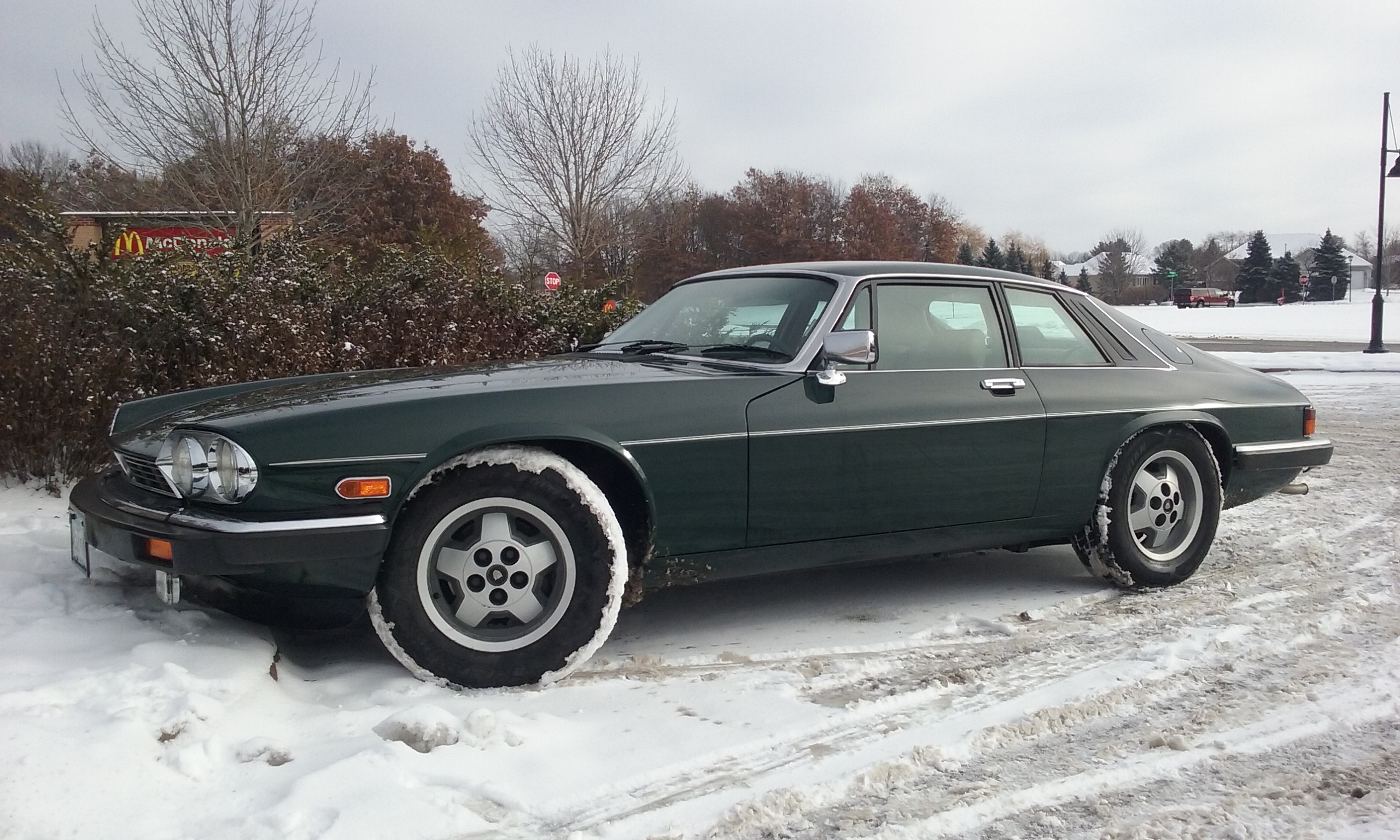

OK. This post isn't entirely serious. I just pulled out my 1988 XJS and drove it in the snow. Half my life is over and half the year is almost winter, winter and still winter in Minnesota. So only driving my Jaguars in the summer is not an option. I can't drive boring cars for six months straight. Sorry Saturn.
Did anyone own a Jaguar XJS long enough to know how fast it rusts out? In the 1980s my dad owned a new Talbot Simca 1308 GLS that rusted out in three years. When you stood next to it quietly, you could hear it rust. My old 2001 Dodge Neon on the other hand had the exact same rust spots for four years and they hardly grew at all.
I would like to get at least ten years of fun out of my salvage title XJS before the driver seat falls through. I bought it as my winter Jaguar so my other Jaguars could remain summer cars. On days when it actually snows and the salt trucks are out I will still drive my Saturn.

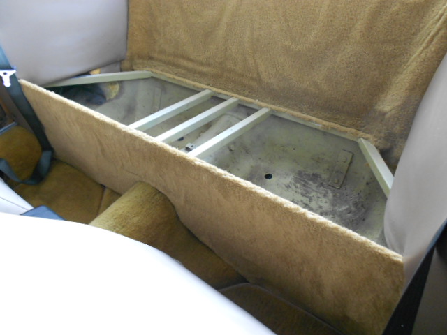

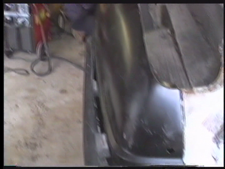

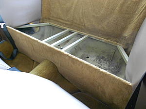

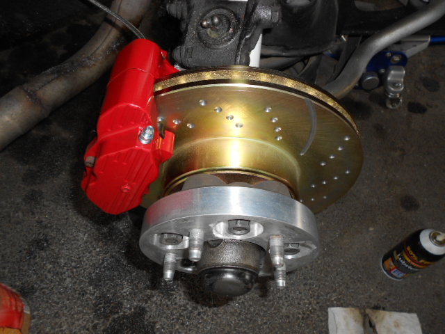

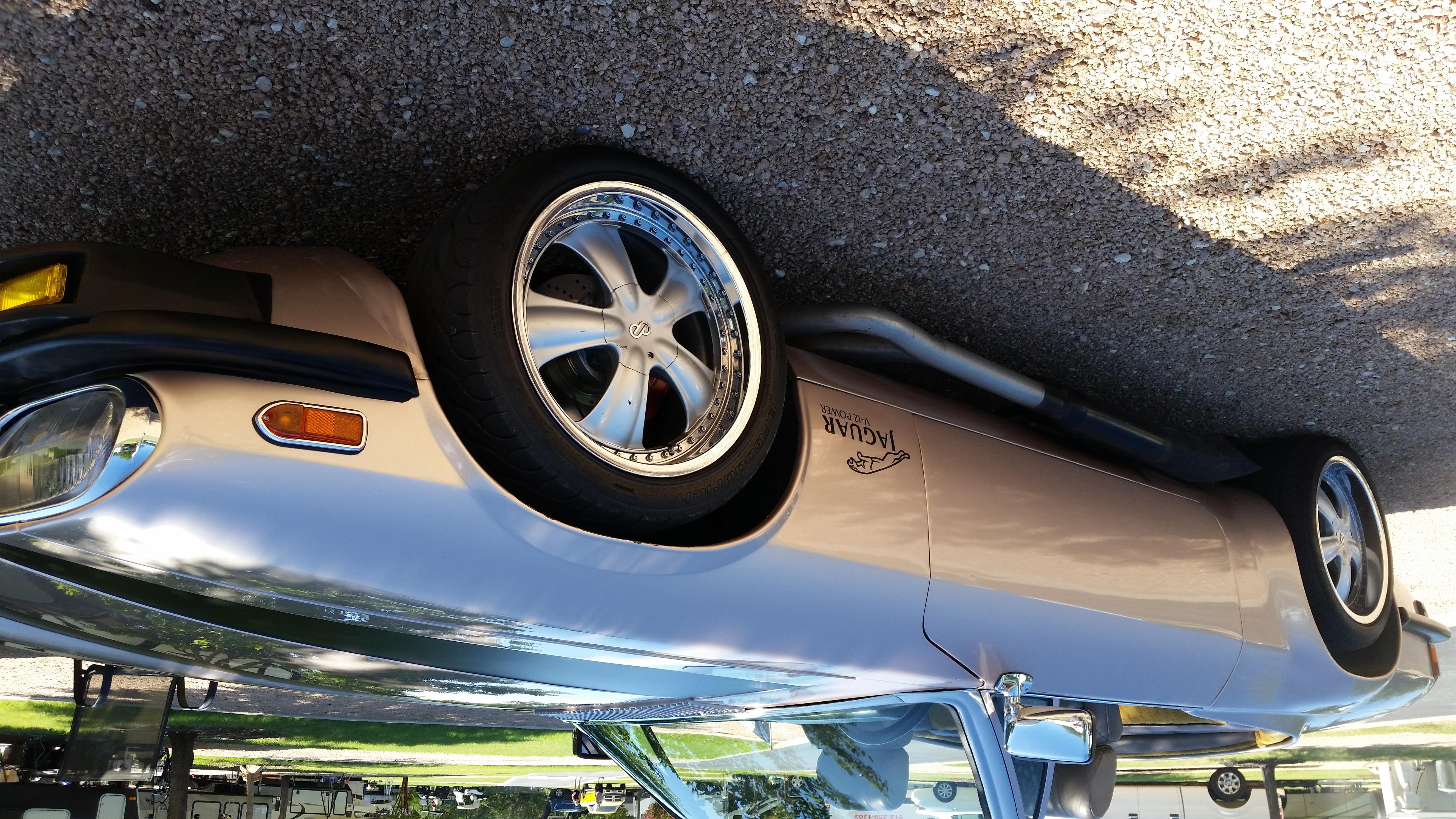

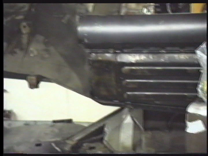

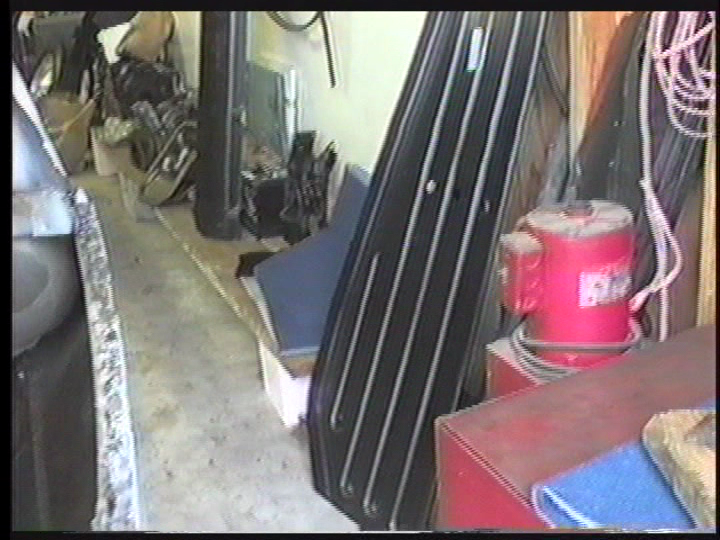

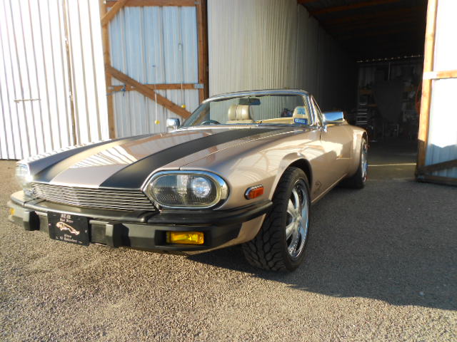

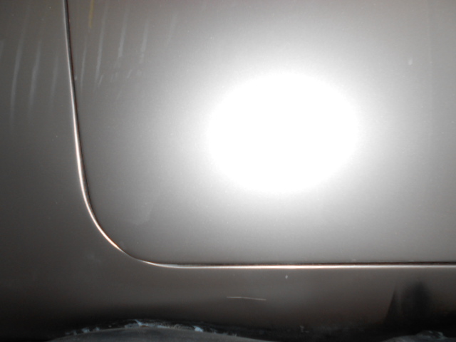

some pix of my XJS 1978 spent winters around Kent UK for 8/9 years!
when it came to USA 1986, pix of what needed to be done !
nothing left of floors or body sides, NEW 2 of everything right and left, sills , floors , front /rear valances, all 4 lower corner pieces, even hood/bonnet was rusted thru, wiper motor box, and metal lower door panels, with custom lower door frames. redone radius body mounts, and bushes
note; door rear corners round, heaven knows what else!
also complete rebuild of Pre-HE engine, transmission 700R4, front & rear suspensions, brake upgrades.
all cavities sprayed with Wax Oyl twice.
now little off topic; the A pillar posts were stuffed with foam,(guess what happens from temperature changes and condensation over time ,it NEVER DRYS OUT,) so i cleaned them out also,( i'd rather air flow thru them than have them rust thru).

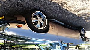

did i mention new fuel tank, hi-impact plastic, all lines and fittings,ETC.
pic today ,23 years ago (NO rust any where), always been in Florida & TEXAS.
