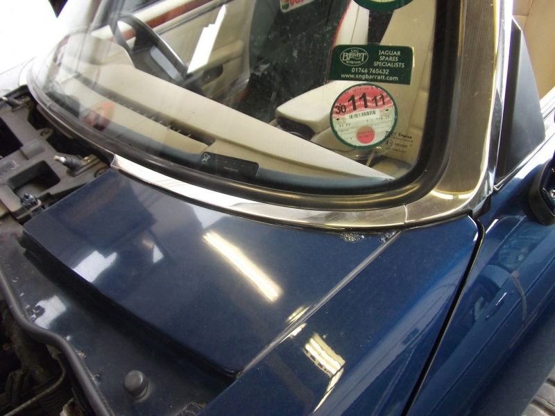

Hi, I bought an 1988 XJS Convertible in 2001, so it was then around 13 years old. I knew it was a bit rusty, but ended up discovering it needed new subframe, floors, sills, shock mount areas and work to the chassis legs from the front back to about halfway along the floors, and work to the tunnel. That’s all done now, but it’s taken 20 years!
I still will need to tackle the windshield legs (or whatever that area in the lower corner of the windscreen surround, behind the chrome) is called) at some point.
So, under British conditions, which probably means salty winter roads, the car took around 13 years to go properly rustic.
I would say though after all this time and the heartache over bills and dilemmas, on balance I’m happy I’ve kept the car, but there was a period of around 5 years starting just after the initial spend that I was fed up with it and had it just sitting in storage.
To me, these cars are full of character and they carry some nostalgia of all that was great about the ‘70s and ‘80s. They’re not really good for cabin space, fuel economy, speed or practicality in other ways, but somehow that doesn’t seem to matter much when it comes to enjoying the car.

Rustafarian,
Well done on embracing the challenge!
I would say that if you've got even the slightest rust bubble appearing just in front of the chrome edge at the lower corner of the windscreen, then you really need to tackle it right now!
A tiny bubble there is indicative of rust in the windscreen flange. It creeps unseen gradually rotting out the flange. The real problem is that it also progresses unseen under the deck panel in front of the screen, into the plenum chamber, into the upper corner of the inner wing and then starts rotting out the A-panel.
We always say that if you can see a small bubble, you possibly have a big problem. And even if you can't see a bubble, you still might have a problem!
I had the smallest bubble and I was very lucky compared to many that I've seen
So, get those chromes off (carefully, as they distort very easily!). And see what you've got underneath.
Good luck
