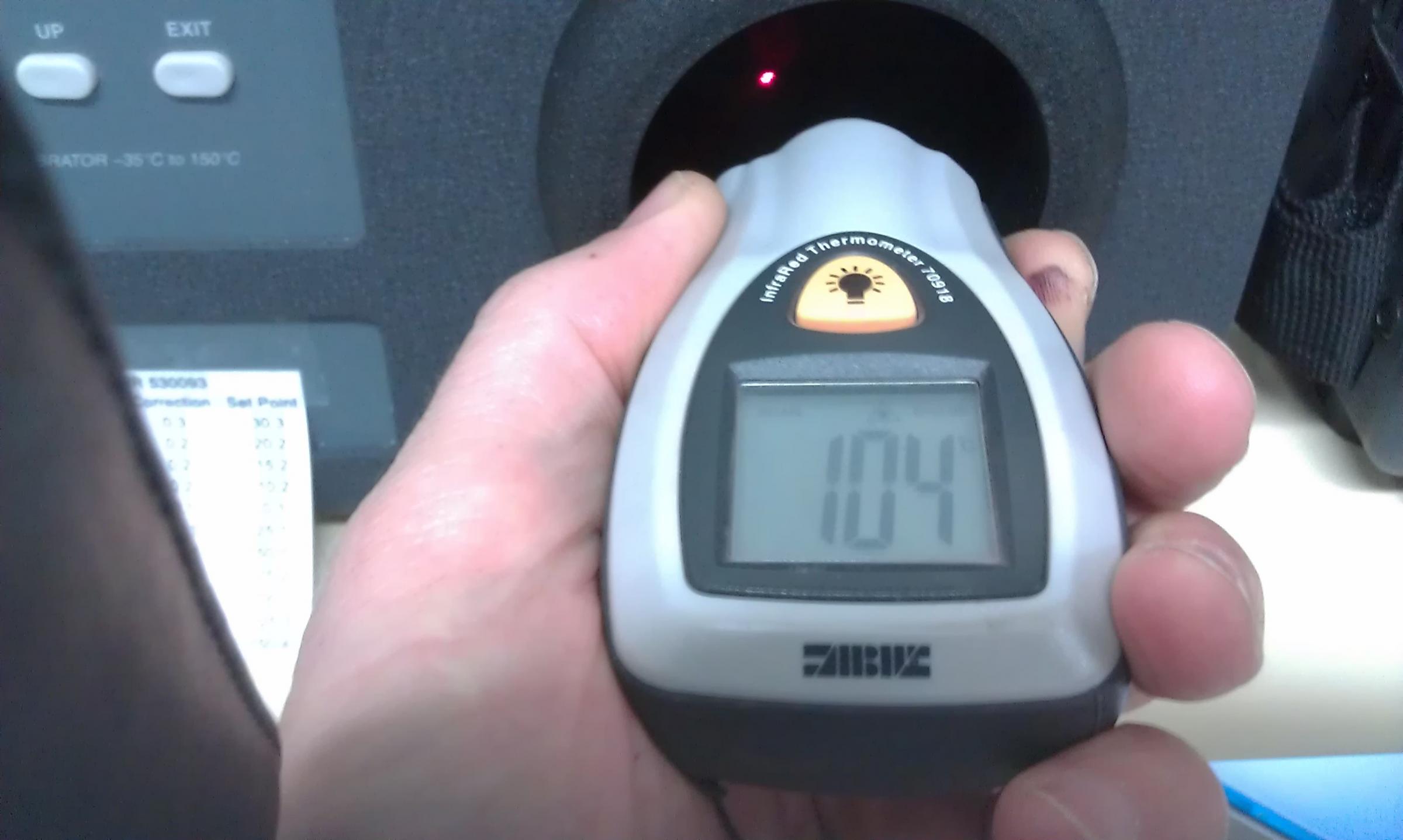

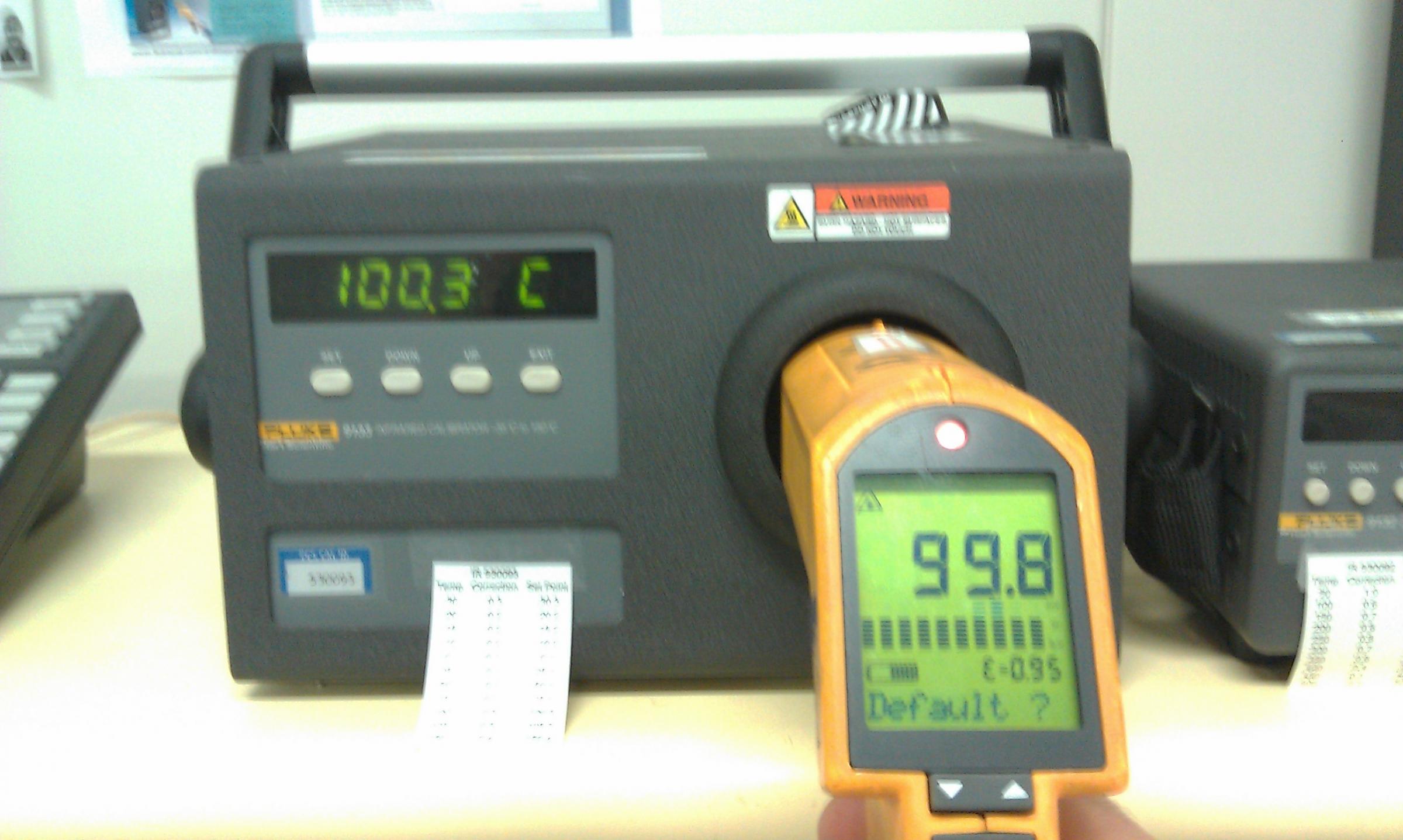

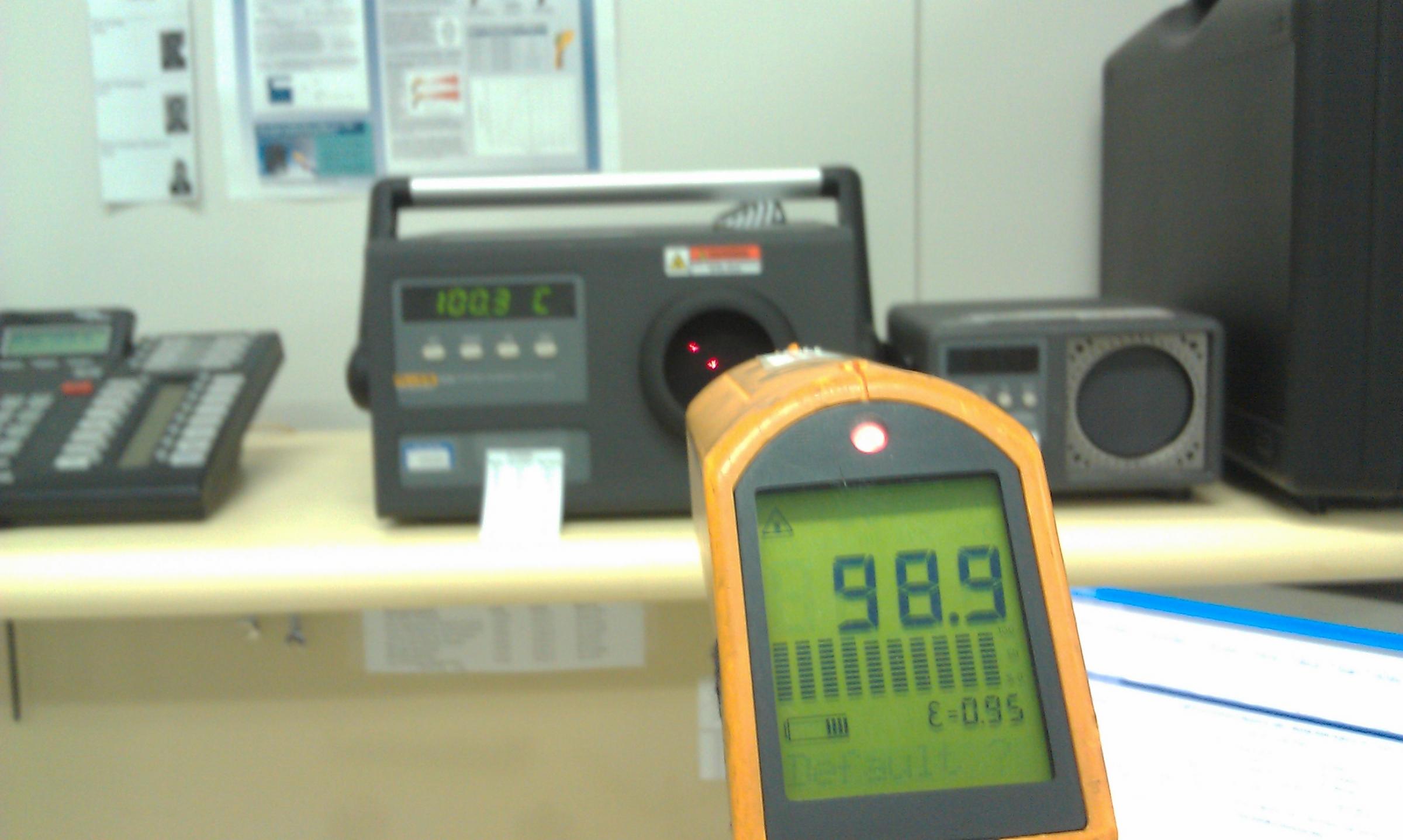

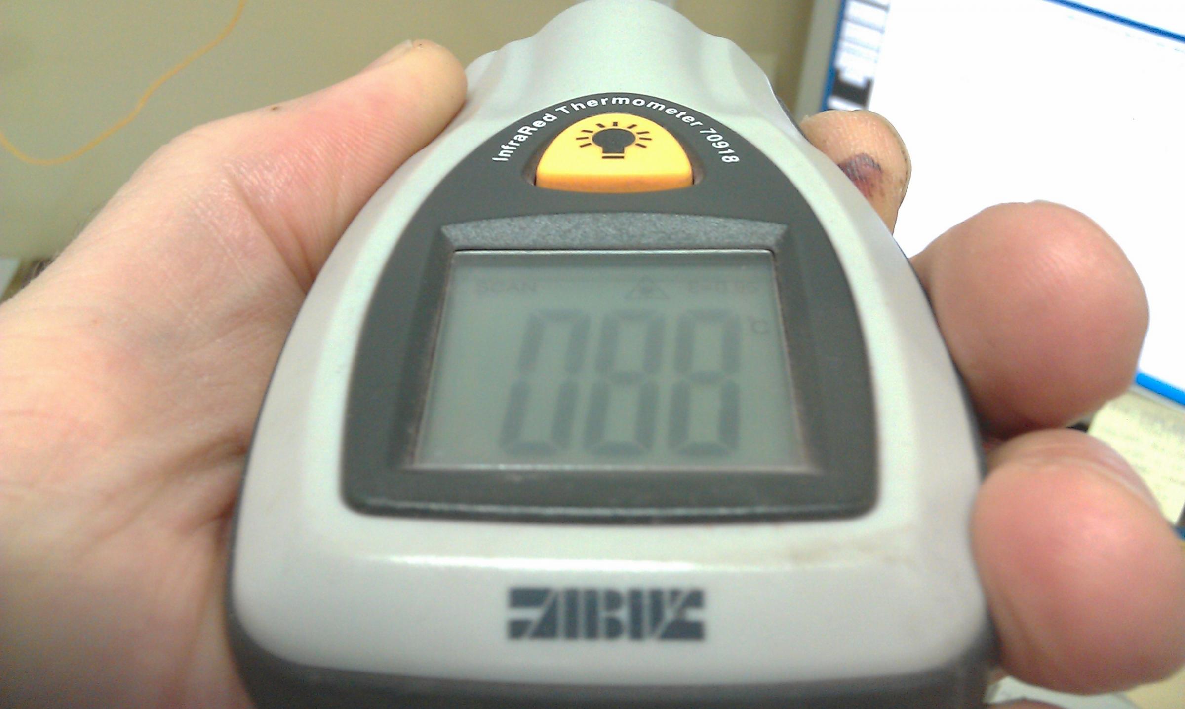

First picture here is my IR at 30mm reading 104°C moving it to 330mm from the surface the temperature dropped to 88°C a difference of 16°C, quite a significant variation just moving the IR 300mm. The next pictures are the Fluke 570 at the same distances the temperature variation 1.1°C which is still out of tolerance for that unit.
So if I point my IR to the water rail and it reads 88°C is my temperature 88°C or 100°C, I do not know, so if I point it at the water rail and it reads 100°C the temperature could be over 120°C. Remember I am using a very stable calibrator with a black surface.

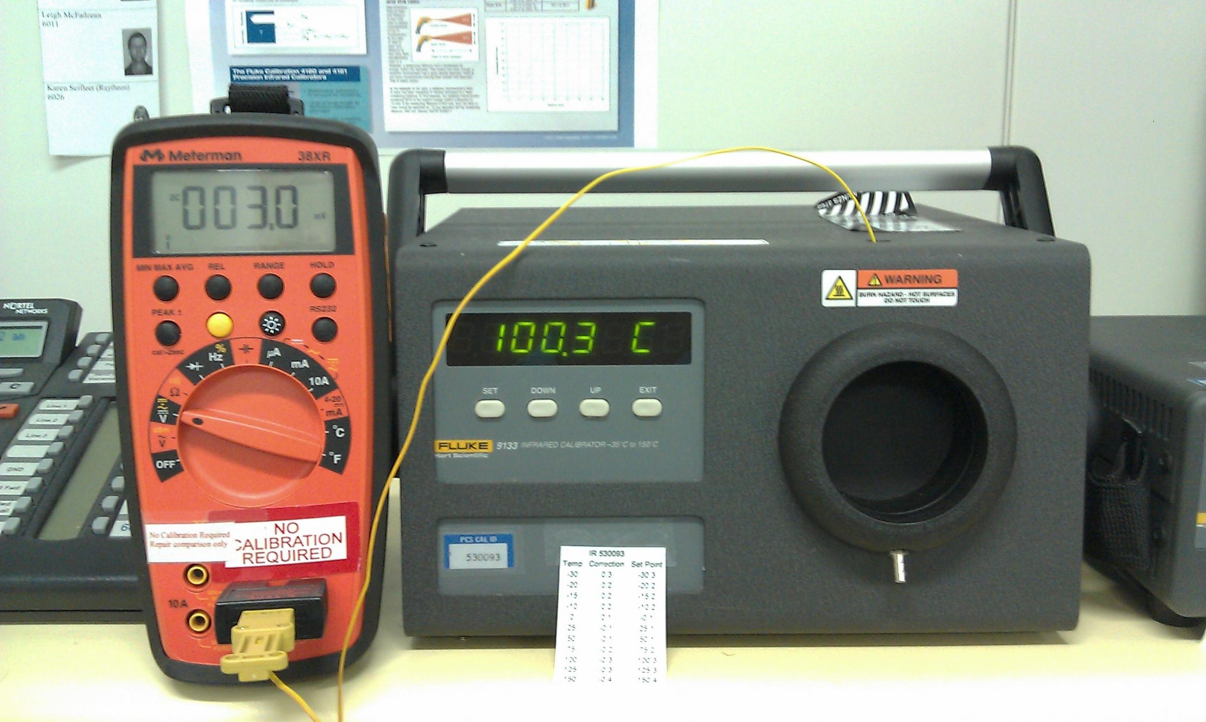

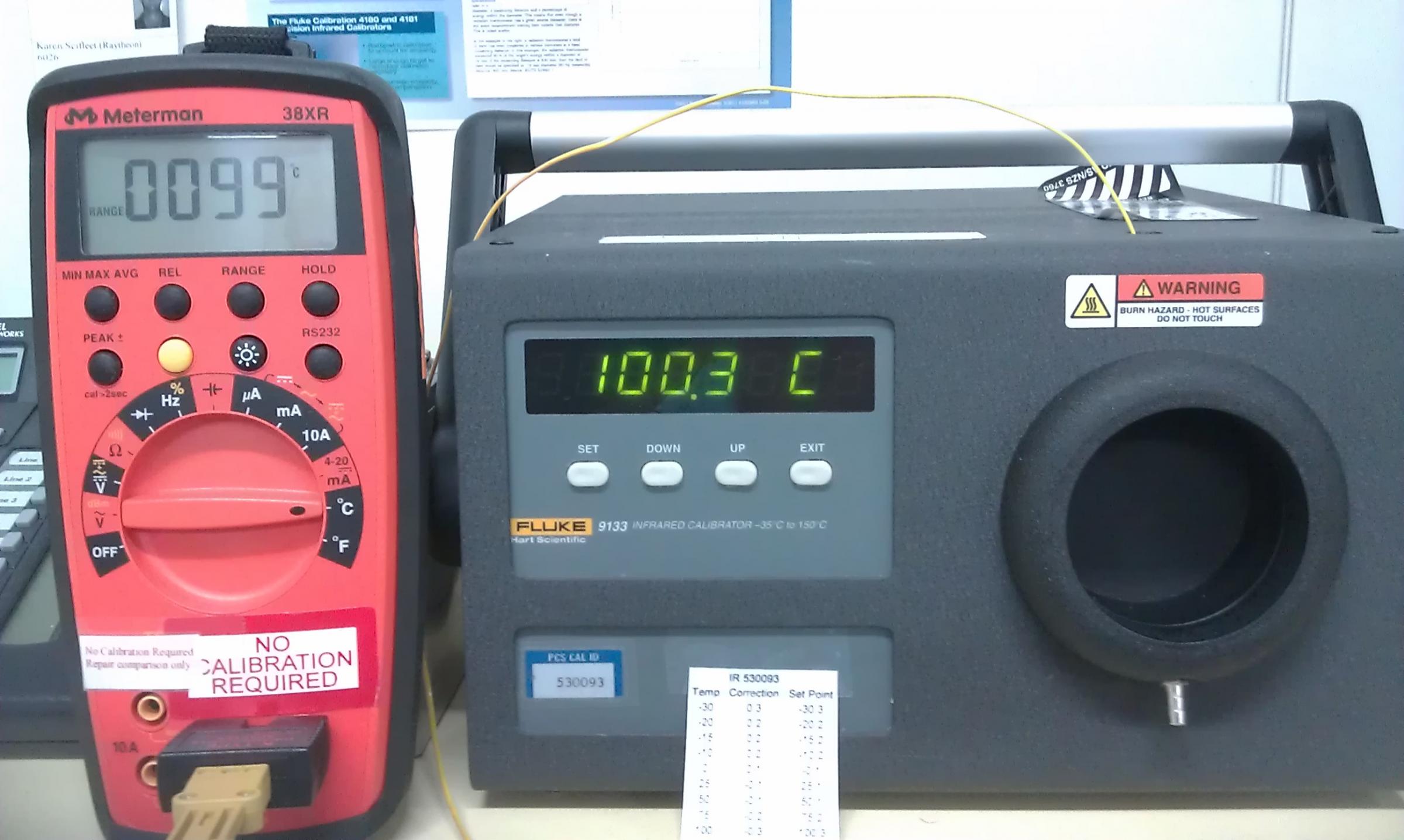

Now lets look at using a K type thermocouple and a digital multimeter (DMM). The meter I am using has a temperature input, you don’t absolutely need this but it will make the reading more accurate. These meters have a built in temperature reference. If you use a meter that does not have this facility then you can measure the voltage but you will need to know the ambient temperature where the meter is. (so don’t sit the meter in the hot engine bay).

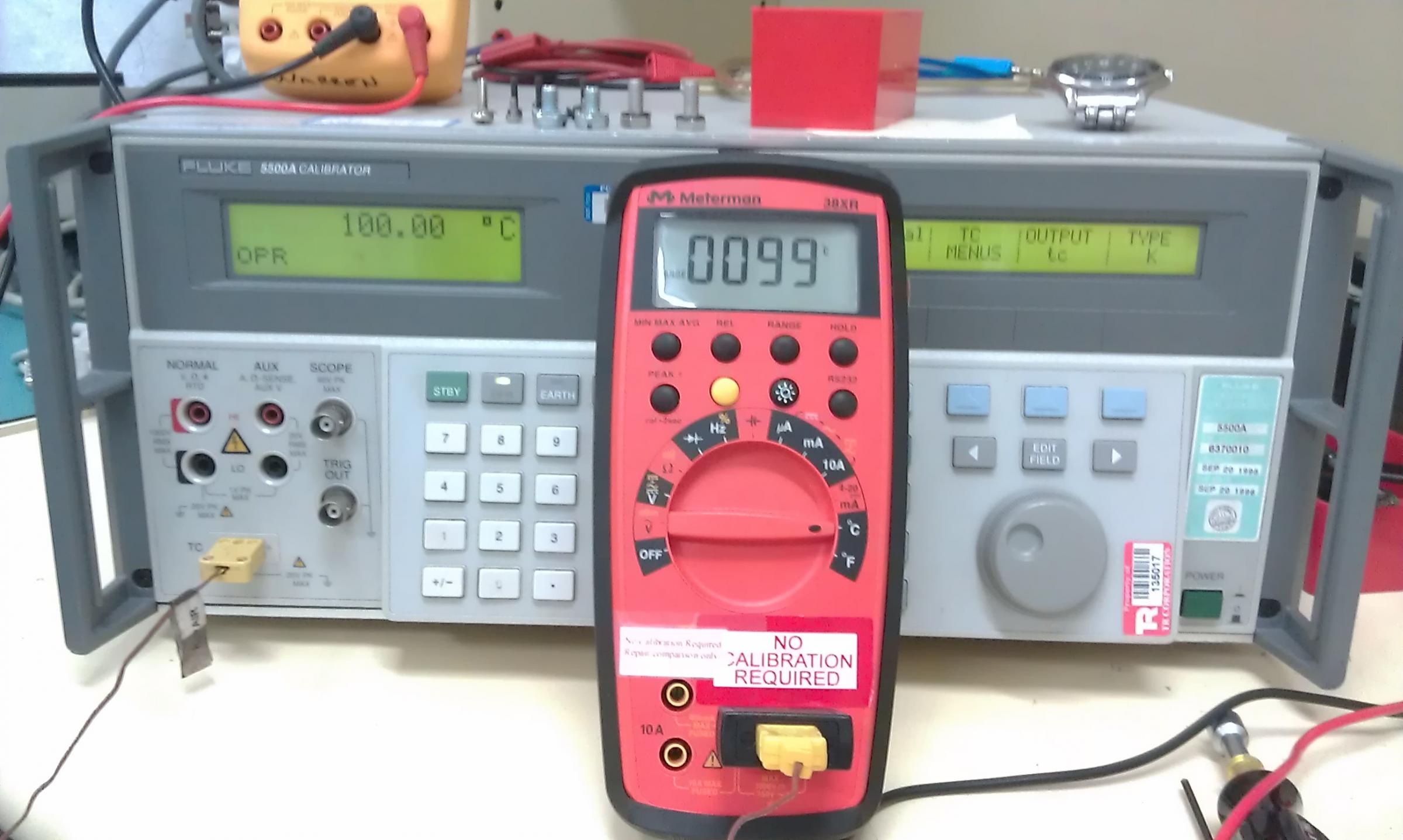

The fith picture is of the meter connect to a Fluke 5500A calibrator to check its reference (I only did this as the meter is faulty, but it was all I had in a regular handheld).
The sixth picture is with the K type thermocouple in the thermowell of the calibrator so I am happy this is accurate and if I put this under one of the hose clamps on a radiator hose the temperature will be accurate.
Not everyone has access to a meter with Temperature function so lets look at how we can make a measurement using a regular DMM. In the seventh picture you will see the meter is reading 3.0mVolts, if we look up the K type thermocouple tables 3.0mV is 74°C now we need to add the ambient temperature which is 22°C so we have a temperature of 96°C. Not as accurate as the Fluke 572 or using the Temperature function on the DMM. But far more accurate than my IR thermometer, and the uncertainty is a lot better, I do not have a 16°C variation.
