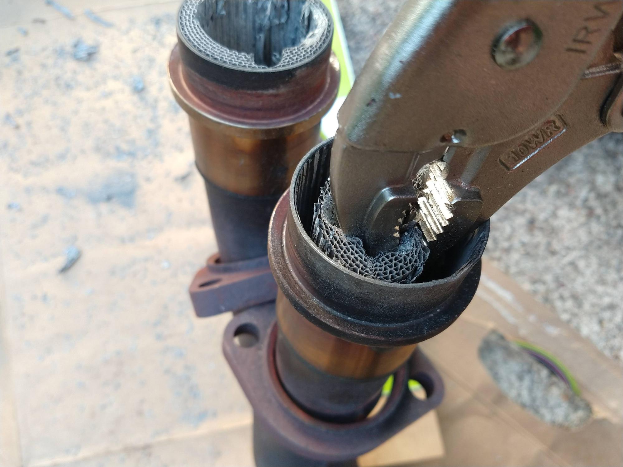

I'll get ya more pics tonight for each step, but it's pretty simple - takes about 30 minutes. I use a 3/8" bit and cordless Dewalt drill with needless pliers. Essentially, I start by drilling 3 holes, triangle pattern, then it's just a matter of using the needless nose to grab and twist the little bits of metal out.

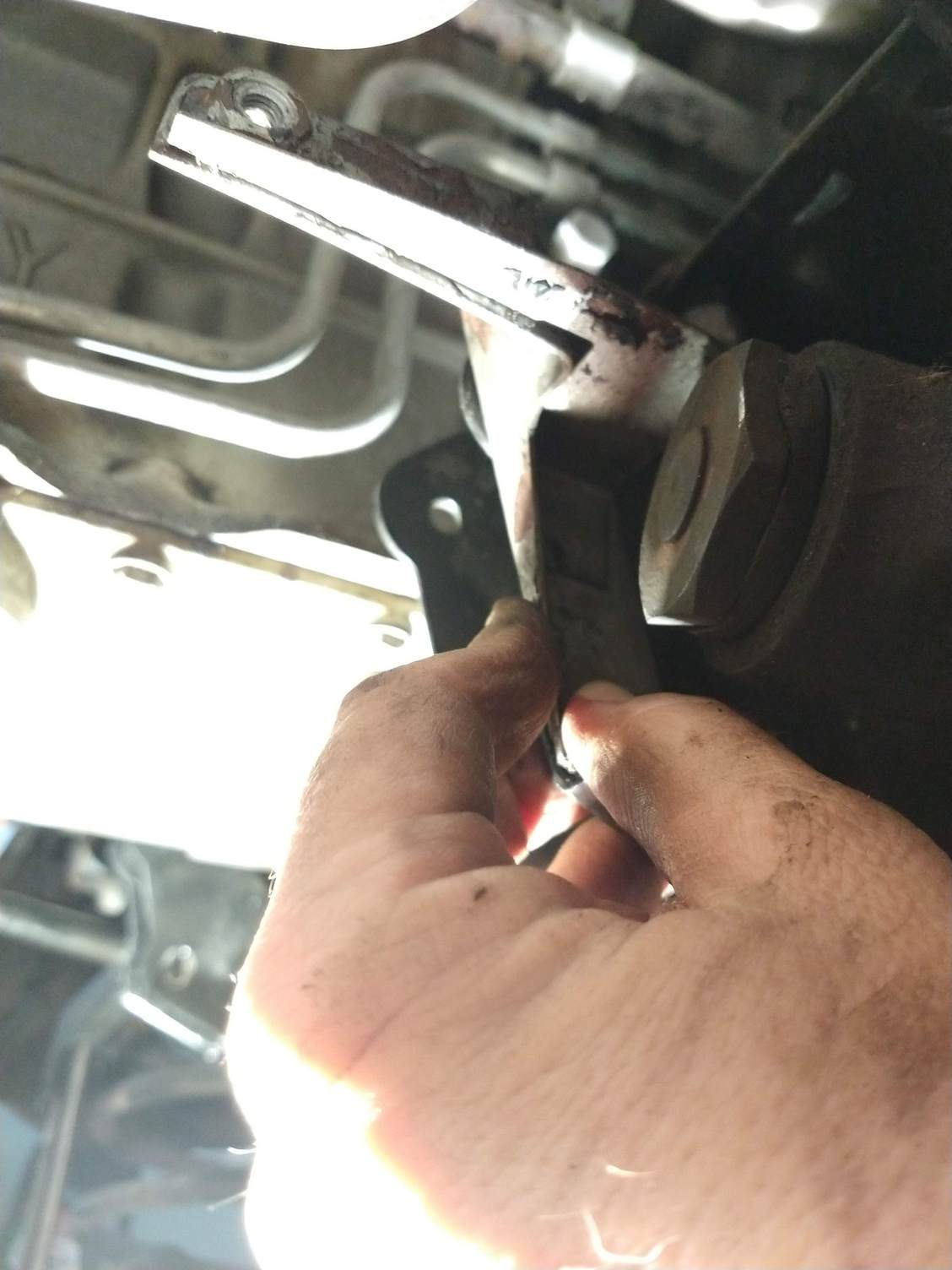

Thanks. How hard was it to remove the downpipes in the first place? Is it feasible to do this as a stand alone project, or do you have to remove so much other stuff that it's only worth doing if you're tackling other items as well?

This project started to replace a leaky P/S hose that lead to a "while I'm in there" fix of the suspension. The first thing I did was to loosen up the intermediate pipes and all the other exhaust clamps - the thought here was to be able to have a little wiggle when getting the pipes out. My passenger side one fell out as it was pretty rusted at the rear exhaust clamp. Next was the removal of the air cleaner housings, then I removed the remote coolant tank (rusty as heck) - this may not be necessary for just the down pipes. Those two things make it pretty easy to get at two of the nuts on the driver side pipes (LHD) with a 9/16" speed ratchet. It probably helps to squirt a little WD40 or such on the long nuts, but mine were about half-way off to begin with so came off really easy. Passenger side was pretty much the same, but just had to remove the air cleaner housing to get the space. The other two bolts you gotta come up from underneath the beast. I used about a 2 foot extension with a deep socket to easily get at the rear bolts, but switched to a regular 9/16" socket to get at the forward two bolts. These were a little tricky to find, but there's just enough of a hole to get up in there - a strong floor lamp really helps find the space. If I remember correctly, there are a couple of heat shields and a mounting bracket on each side that get in the way a bit - below is a picture of the passenger side mounting bracket that gets in the way. I can't remember if the rack gets in the way, I had already dropped mine before going after the down pipes. Then it's just a matter of wiggling the down pipes - the exhaust flanges kinda flop around and generally just get in the way, but a little wiggle goes a long way.
1989 XJS V12 passenger side (LHD) bracket that gets in the way when removing down pipe

Finally got the chance to remove the other down pipe honeycomb. Took a different route this time as I had some time to think about things. Screw the 3 hole triangle thing, takes too long. Drilling as many holes as you can - the key is being able to get the drill bit to grip into the honeycomb and blast it out. Then it's just a screw driver to ply the metal tube from the side and a crescent wrench to yank it out.
1989 XJS V12 down pipe - drilling out the honey comb
1989 XJS V12 down pipe - piece of honeycomb cake now
1989 XJS V12 down pipe - crescent wrench to grab it
1989 XJS V12 down pipe - rip it out
