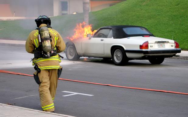

i feel like it needs said that if you lose one whole bank due to marelli failure, UNPLUG THE CORRESPONDING FUEL INJECTORS BEFORE YOU TURN YOUR JAG INTO CRISPY BITS!

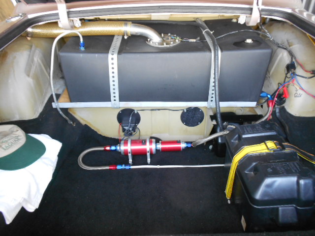

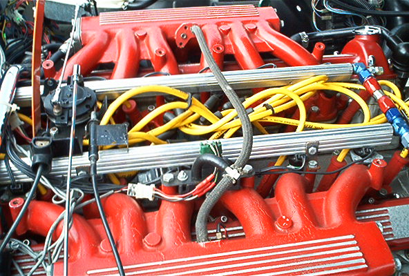

or when doing a complete rebuild,, you have no rubber or neo hoses that can burn, no injector hoses, injectors mounted in O-rings, all fire resistant lines ,all metal, even in the trunk and fuel pump+ filters..
when you gonna do it might as well do it right!
and YES a fuel fire driven by a hi-pressure pump can get very interesting quickly.
when doing your own car you are not held to, somtimes poor, factory engineering.

Default pix fuel system
some pix of my old system.
Attached Thumbnails infamous marelli falure now trans not shifting-trunk-xjs-fuel-system-union-jack-001.jpg   infamous marelli falure now trans not shifting-mazda-jag-rodst-025.jpg
