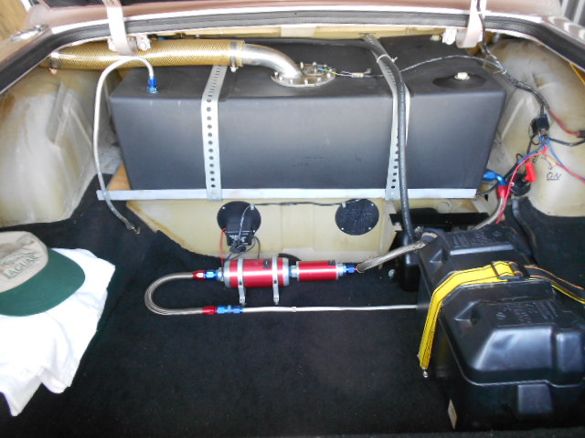

the very reason i modified my complete fuel system(16yrs ago).
i used custom aluminum rails, with HI-pressure O-rings on the injectors both ends , and ALL fuel lines are hi-pressure Aeroquip SS hoses.
i have seen some serious engine fires, and the costs of repairs!

Beautiful work, but if your only goal was to prevent an engine fire, you went way overboard :-).
