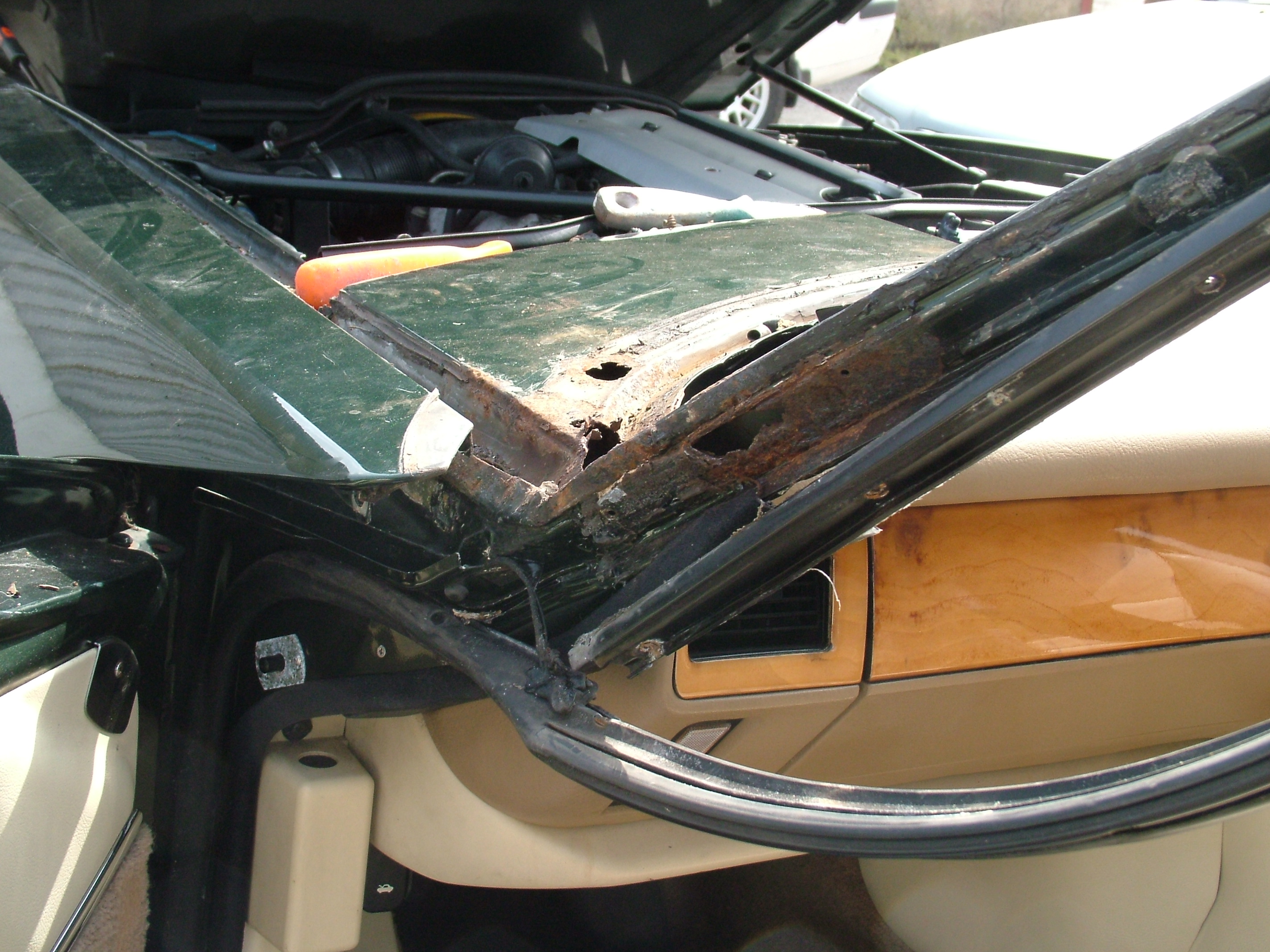

Some years ago PTJS1 posted some horrifying photos of windscreen surround corrosion on facelift XJSs. It really is worth removing the stainless trim and having a proper look and fix.
Here is one of the full horror movie stills! And believe it or not, externally the car looked perfect.

Nasty. Very nasty.
I am slightly (slightly, not completely by any means) assuaged by KWE's statement that "This problem gets even worse with full facelift cars (1993-on) which nearly all have the problem." The horror-snap is also a full-facelift, judging by the lack of glovebox. I can also detect no bubbling of paint in the scuttle at all.
Still, wouldn't hurt to check. How does the chrome come off?

Hate to be the bearer of bad news but the leak described is, one of several I had which turned out to be the dreaded scuttle rot. There was NO blistering of the paintwork around the window at all. Someone had in its past bodged a repair round the windscreen using filler and masticking in an off cut of sheet metal! then painted it.
I REALLY hope I’m wrong but even the drip pattern looks the same.
Definitely take off the chrome and have a look. If you need pictures let me know, I took loads when I did mine.

Hmmm. Can't say that's cheering news, but at least I know where to start, so thanks. From what I've read, you have to remove the interior trim and then drill out rivets to get the metal off, which then has to be re-attached with more rivets or screws or old chewing gum.
For what it's worth, water poured down the A pillar channel cascades down the drain, along the channels just under the bonnet, and out and over the light just like it should. So there wouldn't be a big blockage. However, I'm tempted to take Greg's advice on other threads and just block the top. If that stops the leak then I'll definitely know there's an issue in the pillar....

My car had had the tops blocked off and the actual pillars were in ok (not brilliant but ok) condition.
Even thought the scuttle is not much higher then the leaking area, the leak in my case was directly due to scuttle leaks.

In my case the big hole just below the window line. The pic I uploaded perhaps wasn't the best but that's the bottom lhs of the front window. This should be solid bodywork, mine wasn't.
Water was coming in here dripping in down behind the dash and running along the inside of the dash to the corner and then exiting into the foot well.
