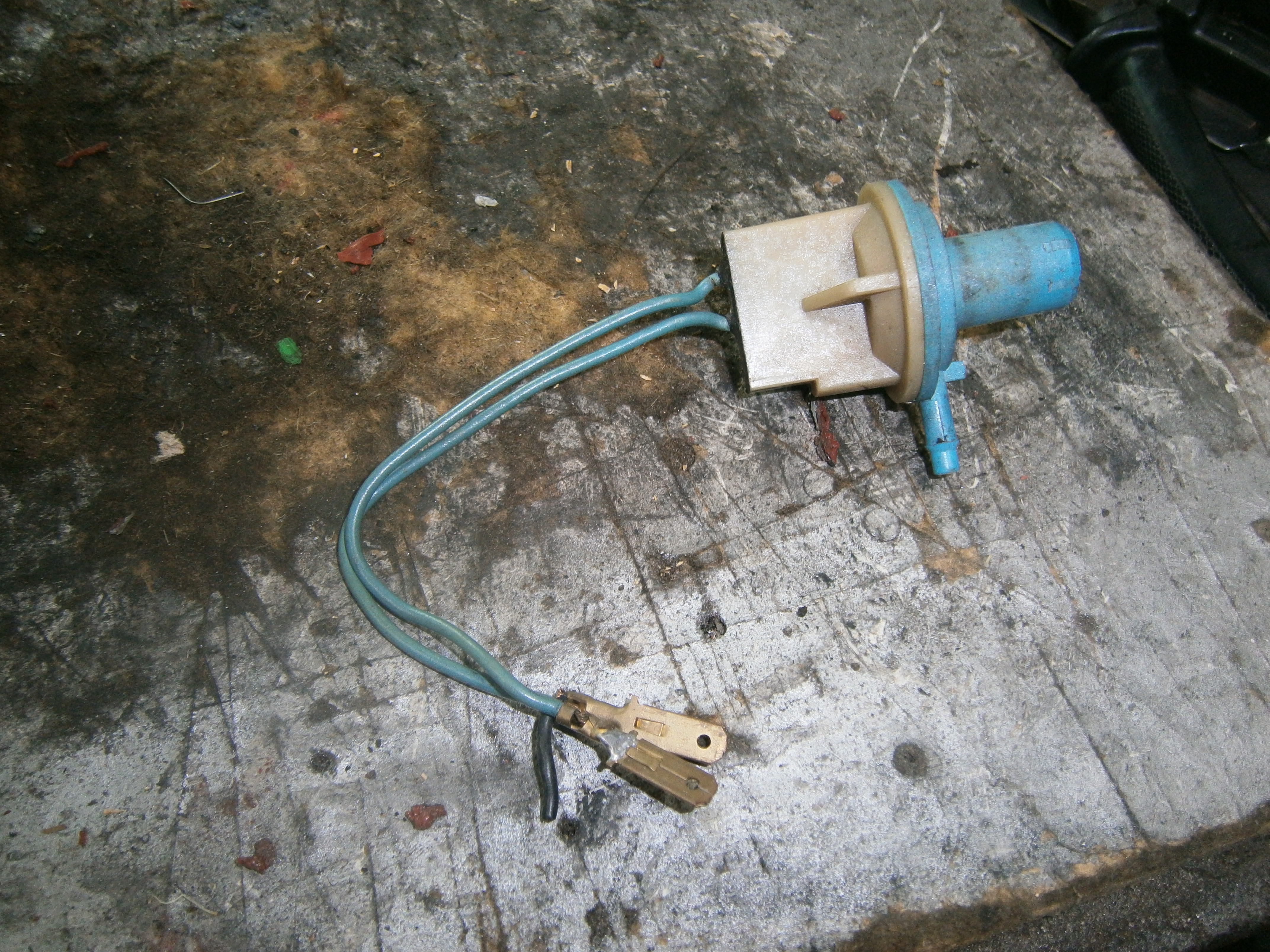

I now suspect the fuel load vac/electric switch is inop. It richens the fuel as vac drops as throttle opening takes place, thus allowing a smooth increase in revs. Much like an accelarator pump in a carby.
It is generally located near 5A spark plug, intake runner.
There are 2 versions, and we get this one.
As to why you get issues at light throttle, not sure about this item, but maybe a number of things all add up to one problem.

Good evening
After coming home from work I decided to list up the inputs you had supplied
1. TPS output not smooth
2. Throttle syncronisation not OK
3. Faulty vacuum lines or vacuum line connections
4. Ignition advance vacuum capsule failure
5. Ign Amp shielded wire fault
6. Ign Amp condensor fault
7. Ignition timing check
8. Coolant temp sensor @ B bank thermostat
9. Air temp sensor. Plug is not secured by a clip wire anymore.
10. Dizzy internal parts failure
11. Fuel load vacuum switch @5A, light blue. Found it. Will ROM tell me how to check it ?
