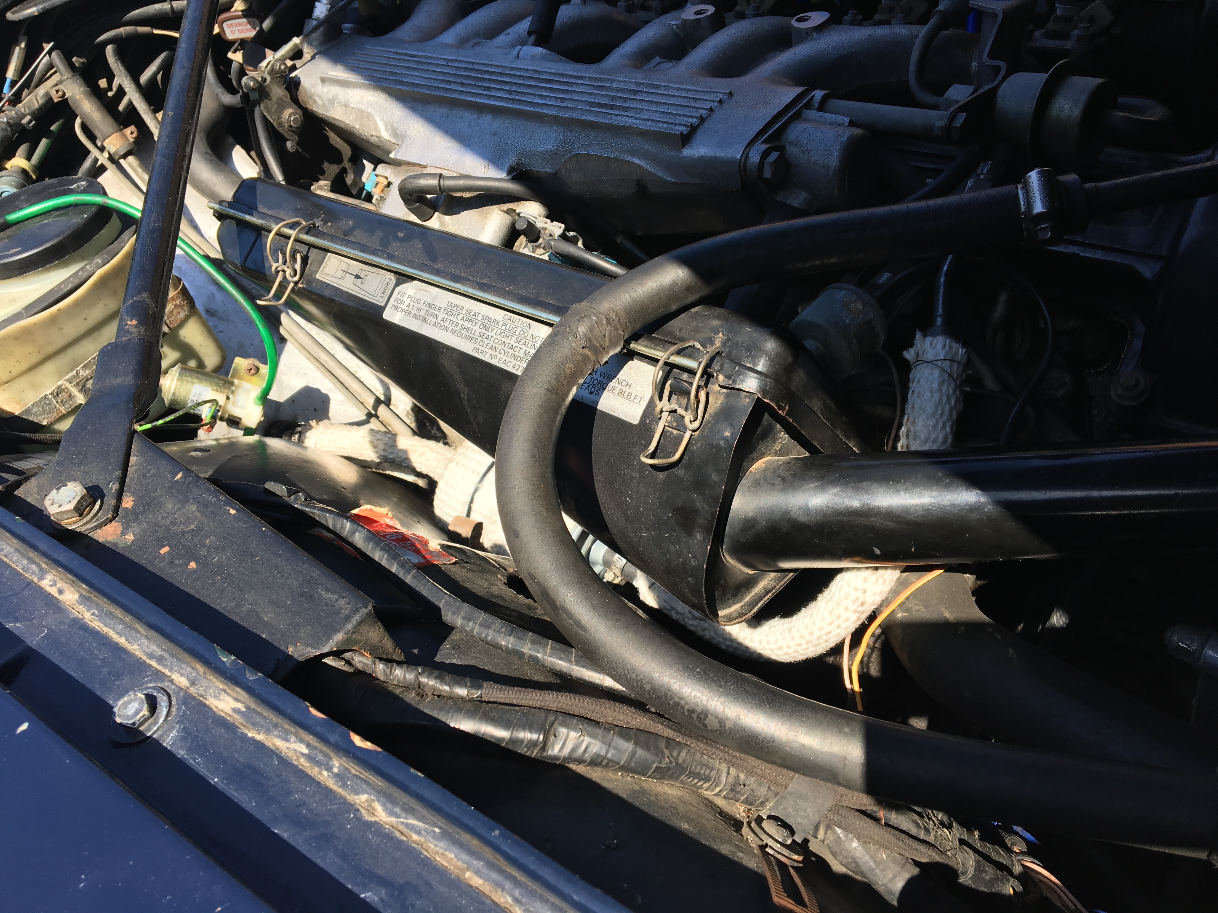

Old Jun 2, 2018 | 08:23 AM
leo_denmark's Avatar
Joined: May 2016
Posts: 783
Likes: 265
From: Middelfart
Back again...
I did actually change the fuel filter Wednesday, but I found the state and routing of the fuel line after the filter to be too bad to use even for a test drive.
The hose was as close as 2-3 cm from the exhaust manifold. It still had the heat protection sleeve in place, but still not good.
New hoses mounted, new Bosch filter moved up a bit and a good distance kept to the manifold. I heat wrapped filter and hoses while I was at it, can't harm as long time as the fuel tank is cooler than the engine bay air...
Engine started and allowed to heat up. Engine stopped and allowed to deliver some heat to the fuel lines for maybe 3 minutes. No issues when I started and took it for a drive, but then after appr. 3 km it started hesitating and backfiring badly, and this time got it on video. I had to push the accelerator almost to the floor before I got propulsion. After that it drove fine again, so the intermittent part of this issue is for sure real...
Ambient is 28-29°C today, probably the warmest weather I have tried to drive car in.
I opened bonnet at return to feel/smell for fuel leaks and was surprised to find air filter boxes really hot, but they will of course be heated by sucking engine bay temp air through.

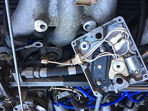

Old Jun 2, 2018 | 12:27 PM
Joined: May 2016
Posts: 783
Likes: 265
From: Middelfart
Originally Posted by Grant Francis
The condensor capsule inside the Ign Amp needs to be removed and trashed, if you have it still installed.
Basically something is failing when it gets hot, and that is making me think electrics rather than fuel blockages.
Greg
And you were right, both of you. I removed the condensor, and did 3 drives 25-30 km long with 15-20 minutes pauses, and it runs well !
It must therefore be either the condensor or something I have disturbed in the neighbourhood of the amp.
Thanks !

The issue has returned after 3-4 drives and 250ish miles.
First time it was my wife, that experienced it. It drove well for a short 3-4 miles drive, but acted up on the return drive after 8 hours, so the engine was neither cold or warm. Ambient temp has dropped to 17-20°C, not warm at all.
Second time was today, where I have done the 17 miles commute to work. Hesitation/bad throttle response started after only 1,5 miles, so engine bay was still cold. The thermometer had only just started climbing. Pushing the accelerator pedal helped as usual. The last miles in city traffic (after motorway driving) was just as troublesome, so temperature may not be as big a factor as I thought.
I think I will go for a new TPS as it seems extremely connected to throttle position. I have the small red TPS, any suggestions for a source for this (preferably inside EU as Danish import tax fee is 20£...) ?

Old Jun 18, 2018 | 07:28 AM
  #33
Joined: May 2016
Posts: 783
Likes: 265
From: Middelfart
Thanks Greg
You're right: My handling of the ignition amp is likely likely to have disturbed the failing parts and thereby causing them to work for a short period. I will try to find a known good amp to borrow for a test.
Rookie question of the day: Where is the socalled dreaded wire located ?
I thought it was the wire going from rearward facing side of my ignition amp, but this wire is actually 2 wires with a shield grounded securely under one of the amp's fastening bolts, but I should as far as I understand it be looking for a single lead co-axial cable in same style as used for antennas ?
BR Leo
