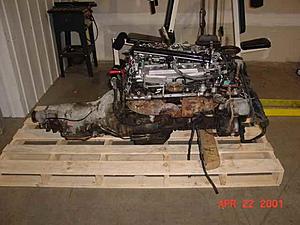

I am trying to determine how much it would cost to get a spare V12 engine and transmission from either coast and ship it to Minnesota where I can not find any. Does anyone know how long the combined engine and transmission are and how much the monster weighs?

Trans is a typical GM TH400 dimensions and weight - about 27". I think it's around 150lbs with a converter. It's a beast. I don't have the V12 length, but I'm guessing about 32". Weight should be around 850lbs for a fully dressed engine.
Call it 1,000lbs for both and about 5' long.

Engine and GM TH400 box together 7 feet long.
Engine weight 680 pounds
gearbox 150 pounds.
