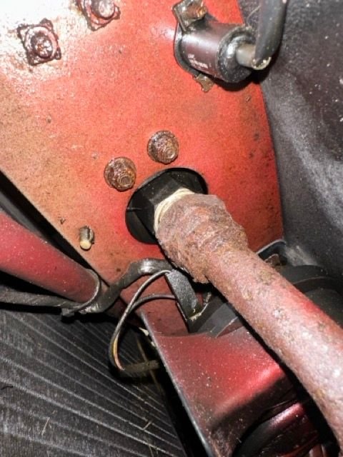

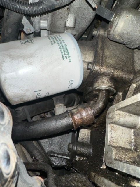

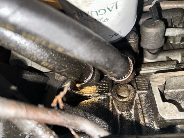

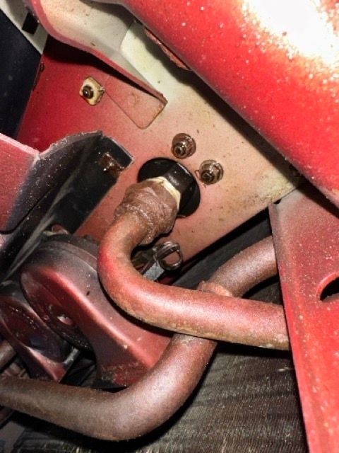

Thanks Paul, I've add some photos from todays work
You can see the we have metal connecting pipes to the cooler itself and then flexi's to the oil filter plate

I think what Orangeblossom meant, in post 4 above, is that he cut the two flexible lines exiting the oil filter casting (ie the lines to and from the oil cooler) and joined them together, thus short circuiting the oil cooler circuit in and out of the oil filter casting.
In detail, he unscrewed the two cut pipes exiting the casting, the took the metal ends with their cut pipes to a hydraulic shop and asked them to make a single pipe with the metal pieces attached one to each end, then screwed this asembly back into the casting. Job done.
Then you can remove the redundant lines and cooler matrix and sling it.
