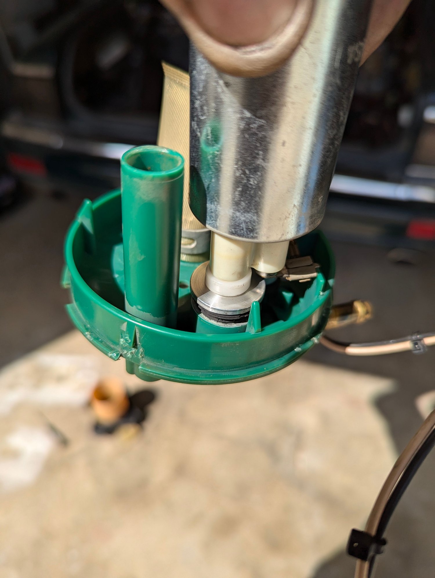

Pump housings were both broken internally, had to modify them to stop them leaking. Good pressure now. Lots of photos if anyone needs them.

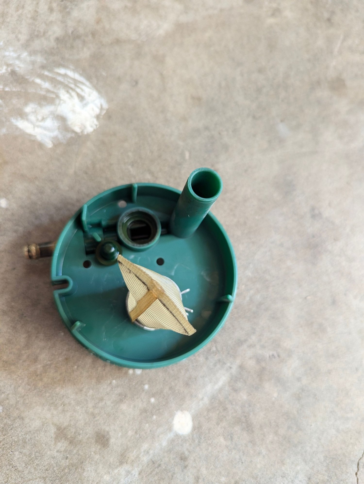

Should not be a gap between pump and green plastic. Seal had blown out  Piece of plastic broken off, PO must have left it out.  Not sure if aluminum part is original.  Both pump housings had same problem.
Aluminum bottle cap fitted to prevent seal blowing, working so far.
