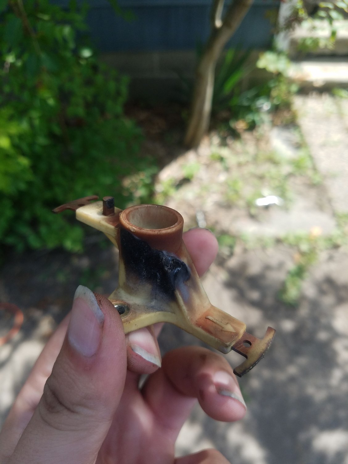

Old Jul 30, 2017 | 07:07 PM
  #40
NyanFloyd's Avatar
Joined: Apr 2017
Posts: 37
From: Taylor Michigan USA
Well I got the cap, rotor, wires and plugs replaced and Im going to try starting it tonight after the battery charges for a bit. I bought a crank sensor but im going to try it without the new sensor for now and go from there. The rotor and plugs looked pretty fried after I pulled them out so it might just be that. If she still doesnt fire, Ill do the crank sensors and coils next time I get home for a weekend.
