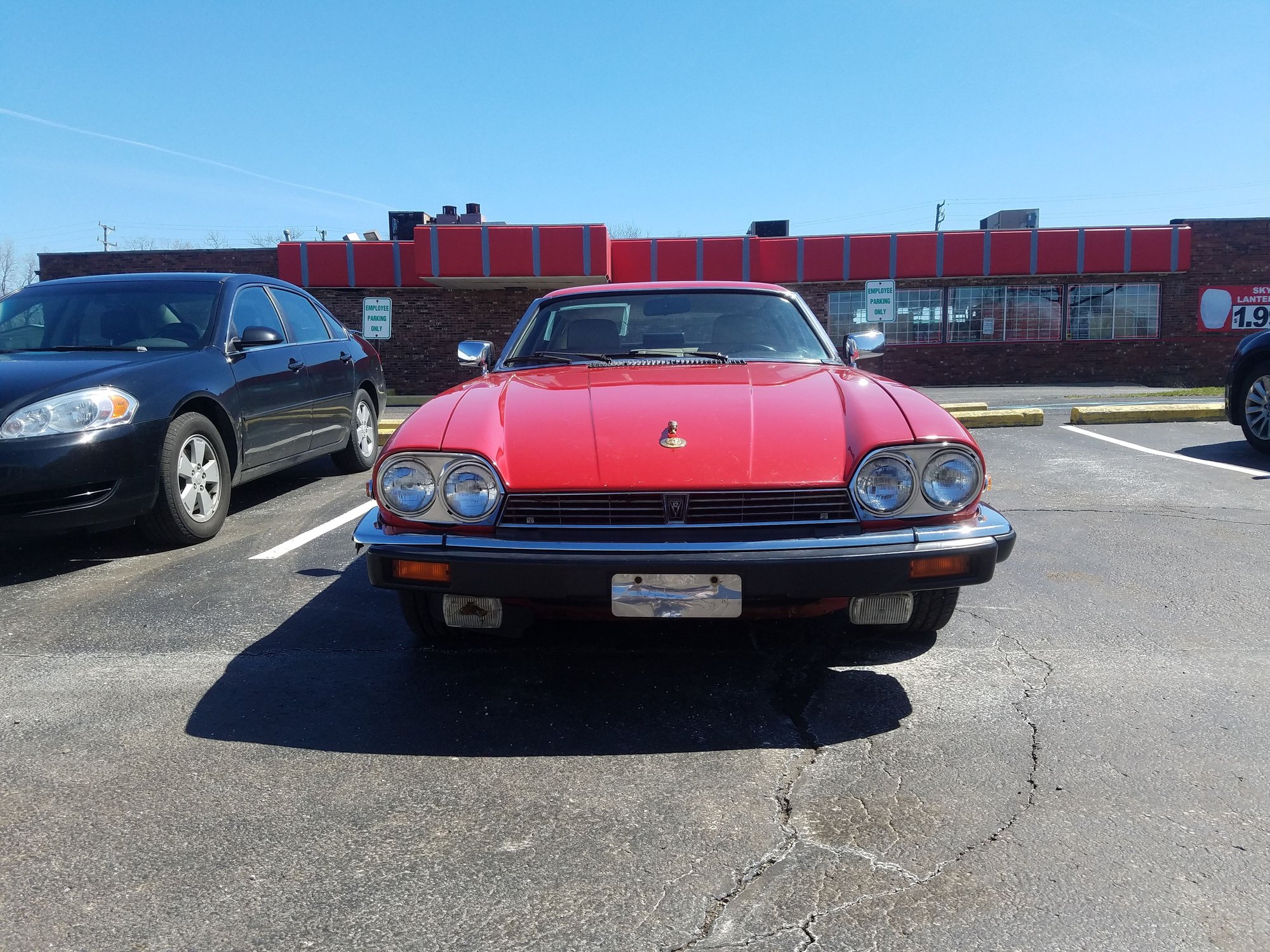

Picked up a red '91 classic collection for $3400. It runs and drives good, but the battery isnt charging so im suspecting either a bad ground or a bad alternator. Gonna put fresh belts, battery, and alternator on it and see if that fixes it. Also the power steering doesnt seem to work. Im wondering if it just needs a fluid change or if I need a new pump.

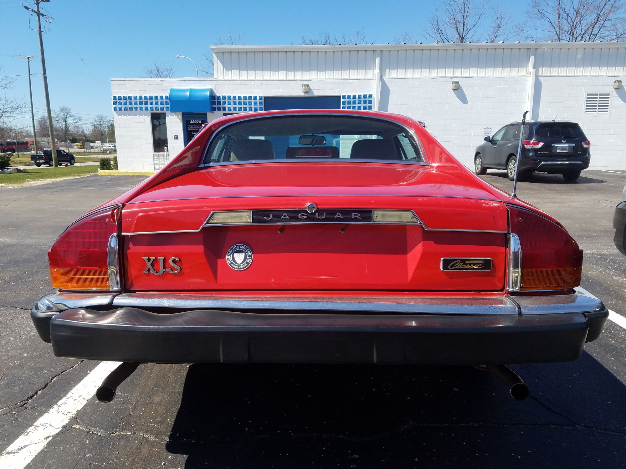

Is fixing that bumper going to be a lot of work?

Im not too worried about that, Im planning on doing the bumper delete. Getting the chrome blades will be the hardest part.

Beautiful car! Love the coupes! What color code is that? Interior Camel?
Looks like when the original owner was asked "Leaper or growler?" they answered "YES!"

Yeah, I dont see many of them with both. Check me if im wrong, but I heard somewhere that less than 300 classic collection coupes were built in 1991. Not sure the exact color code on the exterior but its not metallic. Interior is a beige color with red ribbing on the seats. Car is being stored at a friends house till I can get it charging reliably, but ill swing over there and get the codes for ya where is the spec plate located on these? Glovebox? Door sill?

The color should be "Magnolia" code is AEM, Classic Collection cars featured AutoLux leather with contrasting piping. Also Elm instead of Walnut burl wood.

Nice car at a great price! I have a 1991 Classic Collection Convertible, strange we have different hood emblems. Mine is a gold plated Growler that sits flat on the hood.

I would think that a P.O. has added the leaper at some time in the past above the gold growler.

Leaper over a growler always looks like kitty with her food bowl....
