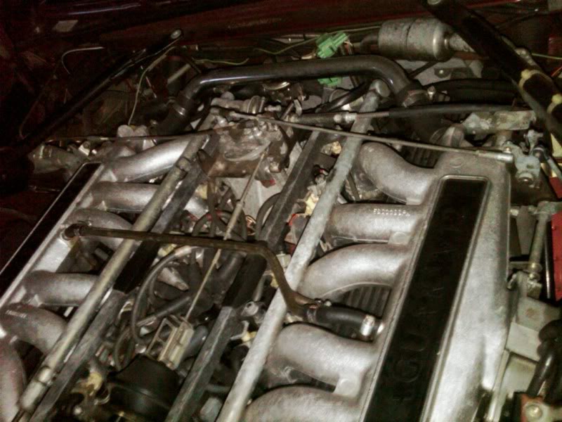

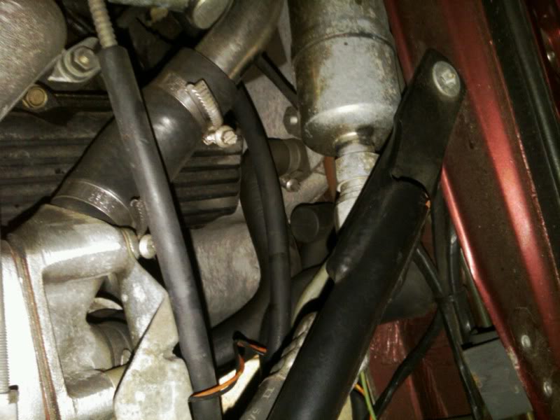

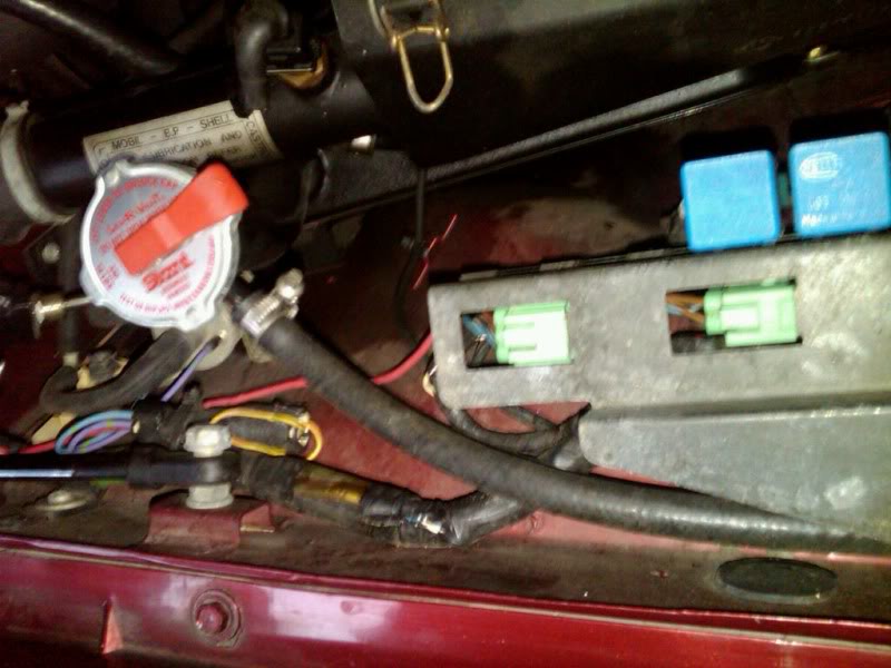

Sorry for the double post, but I just found two more terminals in the engine bay, on the firewall.
Each is about 4 inches under one of the two black diagonal brackets shown at the top of this photo:
Under the bracket on the right, there is a black L-shaped boot:
Under the left bracket, there is another one of these L-shaped boots. I pulled this one off (see the exposed gold-colored nut and bolt):
Is this what they look like on a 92 xjs? These don't look like normal battery terminals.

Mccalist, the studs that you are showing, those are grounding studs. So, don't connect the positive to that stud or you will have lots of arcs and sparks (as you have already found out).
Yes, I do understand that the battery is disconnected in the rear of the car. But, at the same time, if you can add a second battery to the circuit, that first battery doesn't matter.
Now, for the relays in question. I want you to go to the relays located on the drivers side fender well (the 6 shown in the first 2 pics you posted). Remove one of the relays. Now, look on the relay. You should see some numbers on the relay (1, 2, 3, 4, and 5). I want you to match up the "3" post to the spot where the relay was pulled from. Now, using your motor cycle battery, connect the ground to any metal part of the body. Now, stick a small piece of wire into the "3" slot and then connect your alligator clip to that piece of wire. This should put power into the car. Don't try to start the car, do just enough to get the trunk open. From there, you can connect up the normal battery and be back in business.
If you pulled the row of relays up, you should see a fairly heavy gauge wire running to that strip. That would also be another viable point that you can connect the positive of the motorcycle battery to. But, the wire trick is much easier to do.

Mccalist's Avatar
Posts: 10
It's fixed.
Thank you all for the help!
For future reference, I couldn't identify terminal 3 on the relay, so I took a chance on the exposed gold-colored bolt shown with the arrow above. This is a positive terminal.
Just hooked that up to the battery and voila.
