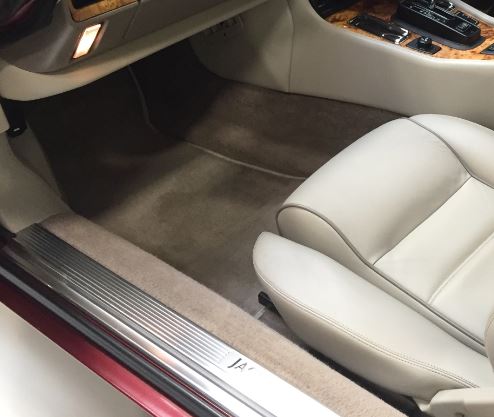

I have a 95 Celebration and I wondered how the chrome kick plates detach from the vehicle. Are they glued on or bolted/screwed on? Some cheap OEM ones have come up on Ebay so may as well swap them out

So far as I know it is adhesive, along with the plate itself running lower and being held in place a bit by the door gasket.
Don't know how strong the adhesive may be, possibly need a heat gun and you could possibly get away with some basic interior prying type tools, just be careul not to bend it?
