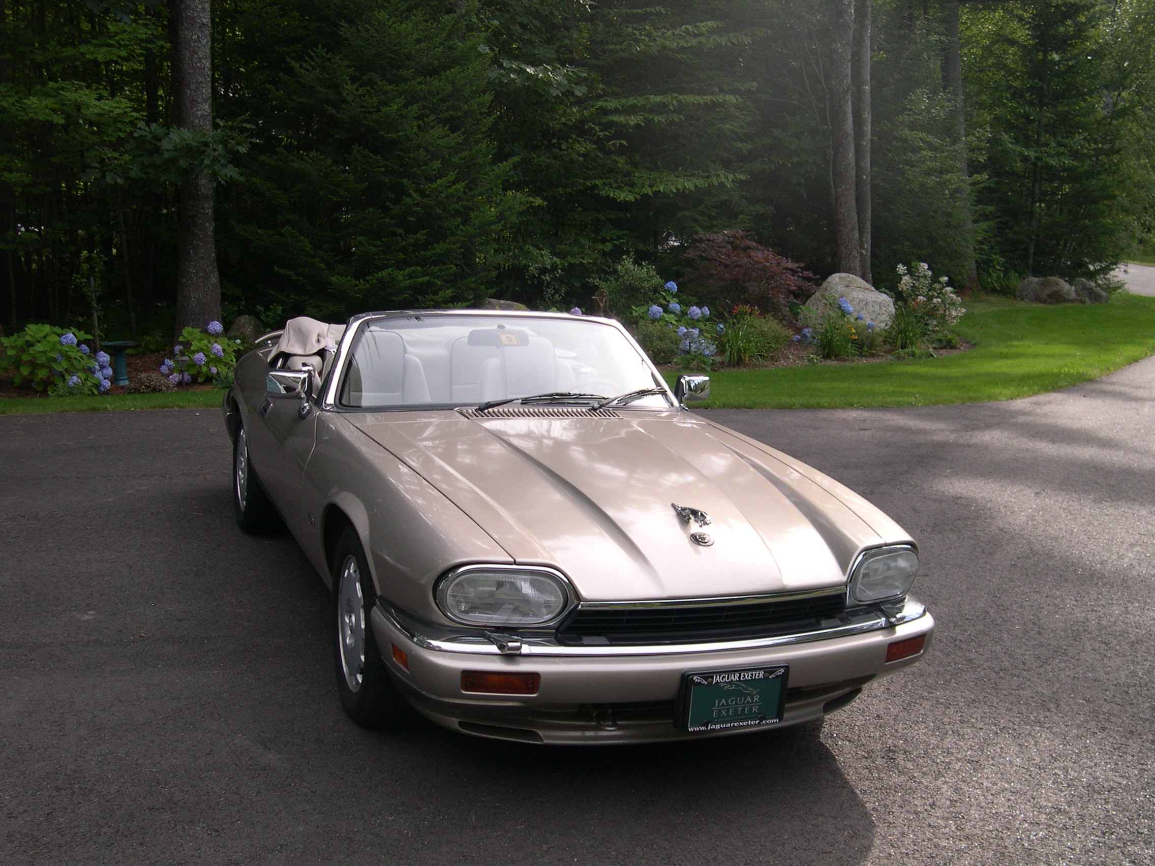

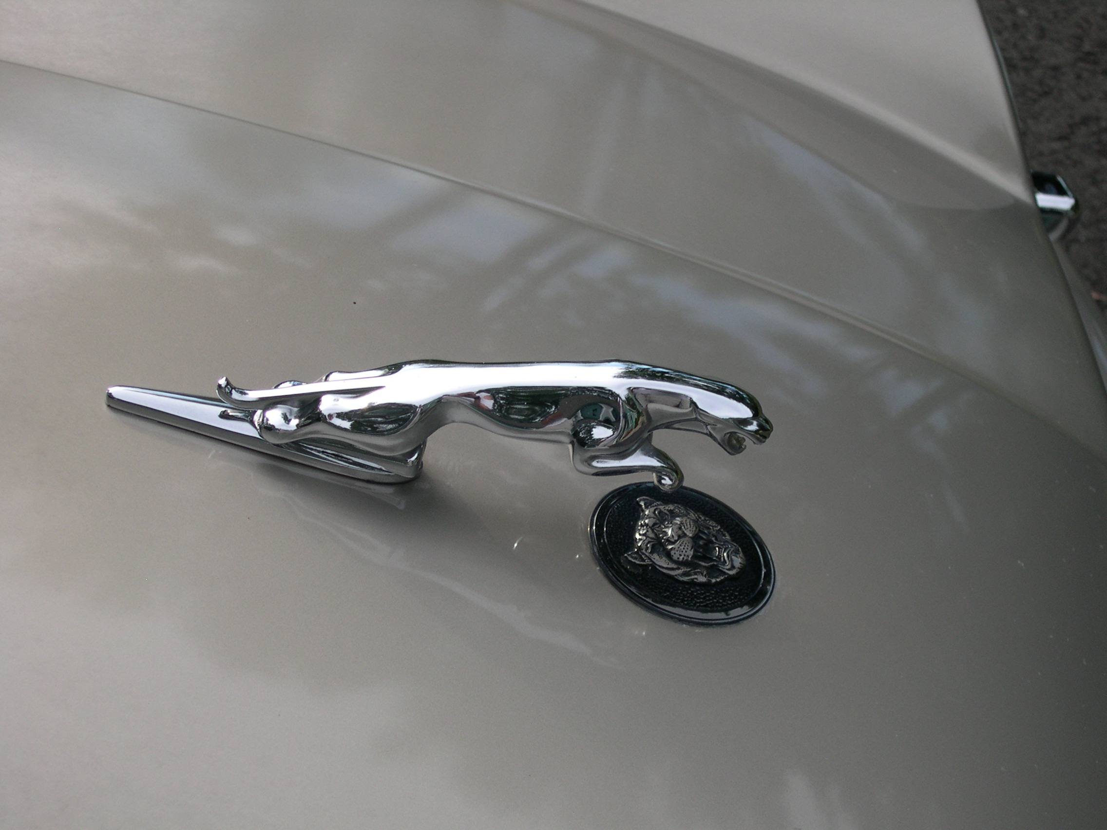

I've got both the leaper and growler on mine.
(See attachments)
Attached Thumbnails Leaper Installation-dscn4151.jpg   Leaper Installation-dscn4147.jpg
