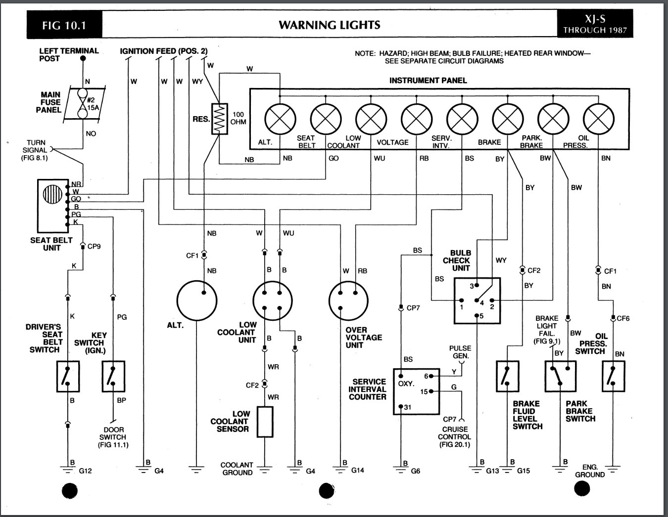

As seen in the diagram Jaguar installed a resistor in the warning light circuit. I have always presumed that the idea was to provide enough resistance to excite the alternator in event of a bulb failure.
DD
