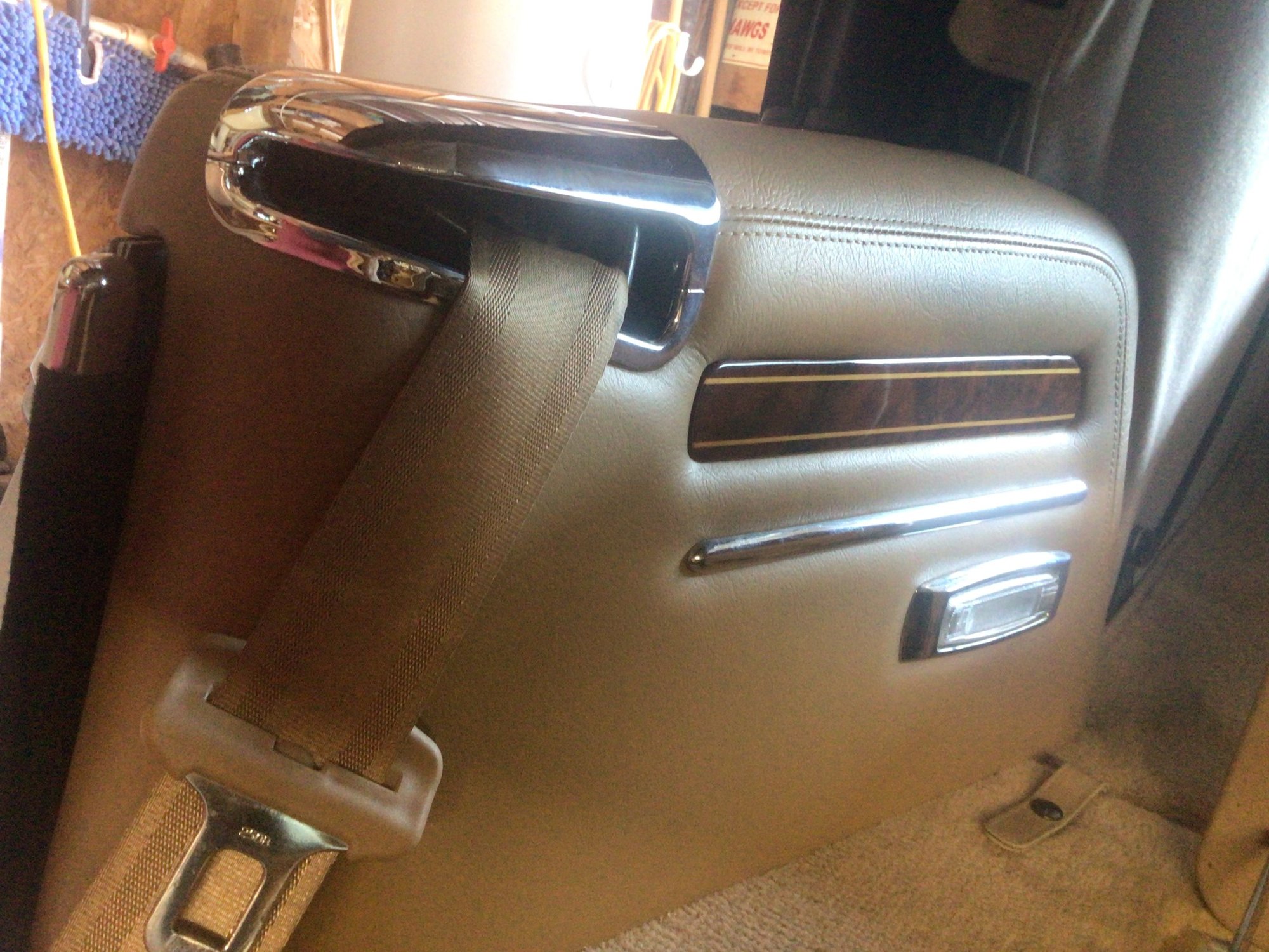

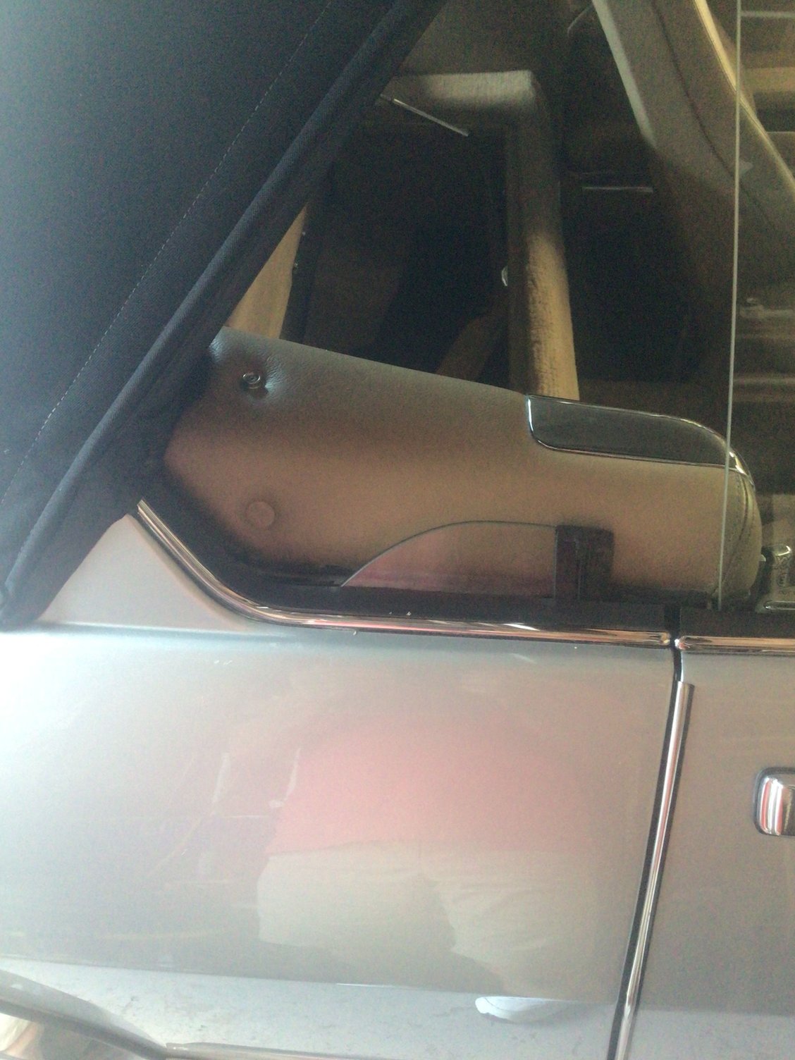

Hi Vee,
I’ve gone through the threads but can’t figure out how to remove the interior panel to access the right quarter window motor. I don’t want to break or damage any of the interior by just pulling on it.
thanks

Hi Vee,
thanks
Cool! You have an XJS!?
I looked at your profile and don't know the year make and model...
First, have you checked fuses and relays? Have you tried applying a little voltage directly to the motor? If so,,,

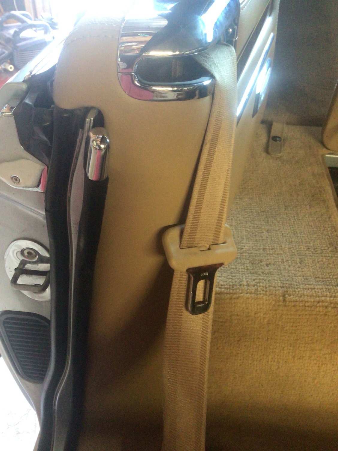

The rear panel behind the seats, on a convertible? Open the top/hood... Move the seat back forward, you'll see 2 or 3 screws in a decorative button up the pillar. Remove them. Up top, on the panel near the window, a couple more screws. Remove those as well. My panel is tucked in pretty well into/under molding and stuff around the door seal trim-ish, and what your going to want to do is a little light prying and some wiggling. Move the seat belt so the buckle and strap provide some slack. Pry the little tab OUT from under the tread plate and keep wiggling. Keep an eye (if it's a convertible) on the area where the window meets the waste seal. It'll come out. If the window is stuck up, getting the waste seal to come out from between the seal and the window on the inside might be a little tough.
I haven't described ANYTHING on the forum in a long while. I hope this makes sense and helps. These cars are pretty tough, in most cases ya almost have ta TRY and break something. I love my XJS

there are no screws only one plastic tab that is on the top of the panel behind where the glass would be if it were up. I can’t pry it out and don’t want to break it. I assume there is a special tool to remove it. I have no clue how to get the panel off.

Feel down the panel behind where the seatbelt is hanging, there are three plastic 'poppers' there that need to be carefully pulled out. On my '92 there is a screw on the top need behind the window. Some have a plastic popper in place of the screw. Pull the panel upwards and there ya go....

OK, so that plastic tab that you can see through the quarterwindow? Yeah, you want to remove that...permanently. If the windows get stuck in the up position, you will never be able to remove the interior panel.
That being said, you might want to buy some plastic fir tree removal tools.
Something like this is what I was thinking:
Amazon Amazon
That will remove the one you see. There are TWO more hidden tabs along the vertical side of that trim piece. If you start from the bottom corner, since the aluminum treadplate is likely pinning that down too, you can begin to pry that away from the car. You should even be able to get your fingers back between the tan trim and the felt lined tube where the door seal is. That's all there is to it.
