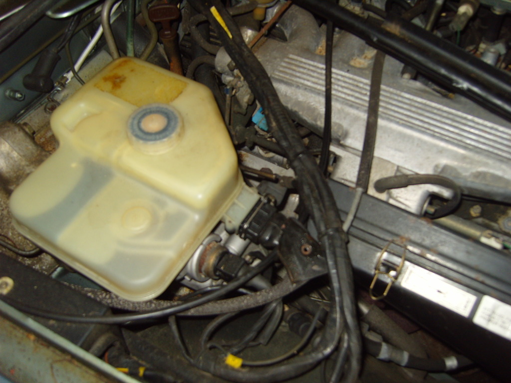

The ABS is "possibly" just a flat "bomb". Of course it could be any number of things, and ABS module failures are getting rather common on this year Jag now. So much so that many have simply bitten the bullet and backward fitted the Non ABS under bonnet system.
A good, and I mean a GOOD, brake fluid flush may be all it needs as far as caliper issues are concerned. I know you are in the UK (rust central), but that looks and sounds like a "dry storage" Jag.
Post up the issues one to a thread, and we will sort it.

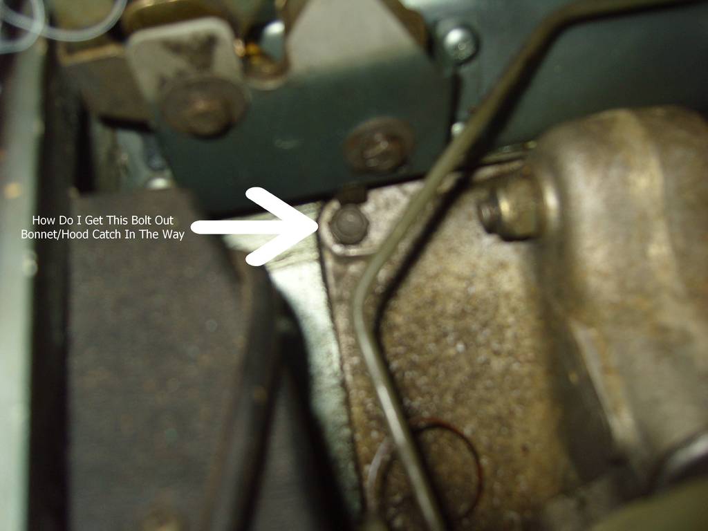

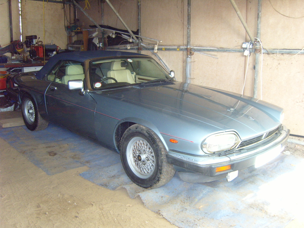

The 'Princess' is now in the Garage, so that I can get all the way round her as in the UK (rust central) its Sunshine and Showers every day.
Having got the wiring loom out of the way (I've got a set of Star Keys) but not one to fit the Star Bolt near the Windscreen! (seems a strange size)
No matter as it was quite easy to push out of the way and last night I undid a Caliper nipple so that the old fluid could drain away and loosened off the Plastic reservoir thingy.
Spraying all and sundry with WD40 to protect against any Brake Fluid spills and put a load of the GF's best bath towels underneath the Actuator to catch any brake fluid drips.
And soaked and keep on soaking the 4 bolts that clamp the Pedal Box assembly to the Car in the Special Mixture!
So now with just those 4 bolts to undo, I should be able to Carefully lift the Pedal box assembly together with the Actuator out.
But there is one thing stopping me! and that is the bolt that is right underneath one of the bonnet/hood catches.
What the hell were they thinking! why on earth did they put that bolt there!
Do you think I should take the bonnet catch off? which looks a real 'Bar Steward' of a job, as those Phillips screws or whatever they are look like they're on there real tight!
Or will/should the bolt still come out without doing that?
After what you've been saying, if/when I get the ABS Actuator out! I am really tempted to 'Retro Fit' non ABS, which is in one of my other XJS's that won't be going anywhere anytime soon.
Is it an easy swop over, or would I have to make up different brake pipes, or move the existing ones to a different place?
Also where does the VAC Hose go? would I have to drill and tap another hole somewhere?

'The Ice Princess' in the Garage which I totally emptied out and even put a Carpet on the floor.
What's the best way to get this bolt out, should there be room to undo it, or does the Bonnet/Hood Catch need to come off?

Try a 1/4 drive socket. It might be small enough. Then use an adapter to 3/8 for touque. I have all those parts in a box I was going to sell to a member. Once I removed the parts I never heard from him again. Sounds like he was just messing with me and wasting my time.
Undoing the huge pozis that hold the catch is not at all easy, moreso with the brake actuator in the way. When I rebuilt I changed them for hex headed bolts that you can get hold of at least. Those pozis round over VERY easily and then you are really in trouble
HOWEVER there is a very much easier solution! Inside the car is the bonnet release lever, leaving the bonnet open, pull it closed as if you were closng the bonnet. The piece of steel blocking you will miraculously move!
It is the lever to which the release/close cable is attached!

Undoing the huge pozis that hold the catch is not at all easy, moreso with the brake actuator in the way. When I rebiult I changed them for hex headed bolts that you can get hold of at least. Those pozis round over VERY easily and then yuo are really in trouble
It is the lever to wich the release/close cable is attached!

Amazing! Doh! Why did I not think of that!
'Greg in France' to the rescue once again!
Yeah! As soon as I saw those Pozis, rounding them off was the only thing I could think of.
But then its not unusual to have to take the Car to bits, just to get to the part you need to take off.
Greg solved that mystery real easy. It took me days to think outside the box enough to do that back in '94. Something in the water in France, for sure.
The Retro is a time consuming efort, and a donor car with all the bits is mandatory.
From memory, and I was the "drinks guy" when my mate did it a looooooong time ago to his'88 Conv.
The vac is from the RH inlet manifold end plate, and his had a plug in the hole, so simple to fit a hose spigot. The end plate off the donor car is plan B.
The brake pipes simply reshaped to fit, again that is memory.
The distribution block down on the RH inner wing created havoc with bleeding, so was replaced with a simple brake spec "T" block purchased from a brake specialist. The wire was tucked out the way.
Thats about it.
It took us a good 10 hours, coz the donor car was 20kms away, and the number of "little bits" we forgot, got us both a tad testy near the end, but it worked out fine, and the car stops just fine.
