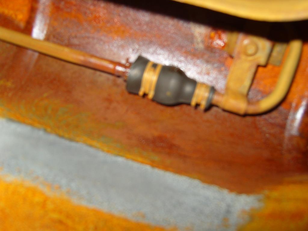

Hi Eric
This is what the inside of the Tank of a 95 Celebration Convertible can get like and the pump was as rusty as hell so no wonder it failed, so as you cannot see in the fuel tank to check you have to roll the dice and hope that its going to be ok and won't be causing a problem any time soon.
Its an absolute pain of a job to sort out and very expensive for a Garage/Shop to fix.
How you solve that? take out, clean and coat?
Tanks are always a problem for 2nd hand cars in this country, as dealers leave fuel levels below minimum, and the climate is hot and humid.
This is indeed one of the gambles, especially on a 30 year old car.
Old Feb 15, 2016 | 02:10 AM
orangeblossom's Avatar
Joined: Feb 2013
Posts: 17,809
Likes: 3,945
Hi Eric
Coating is not recommended, so I had to dissolve the rust with 10 gallons of Vinegar and then keep moving the Tank around every couple of weeks.

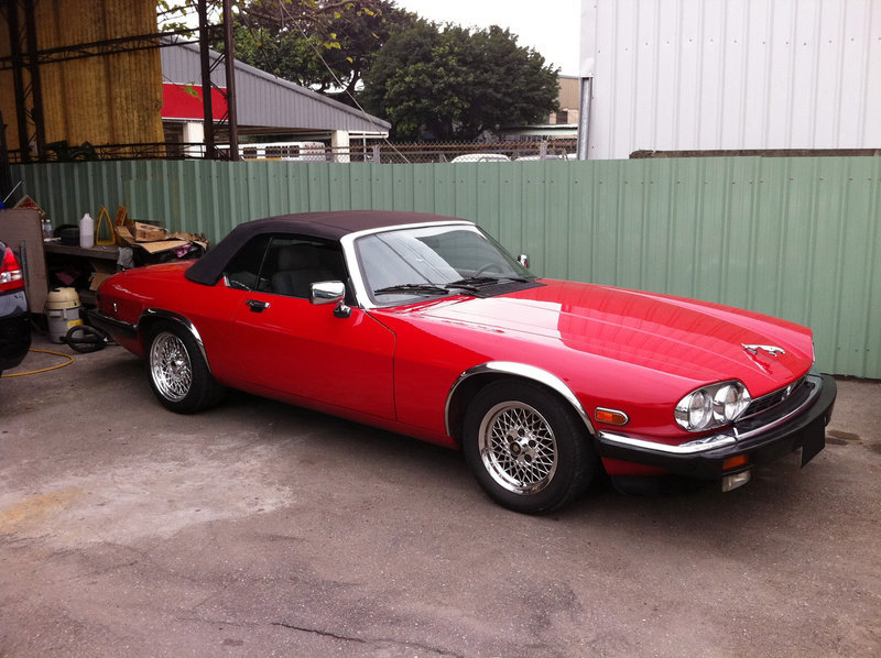

Well, I finally managed to have a look at the red V12.
A 1989 according the import papers, and in Taiwan since 1994, with 65.000mls, and including the much needed license plate.
Was too well dressed to dug really under the car, but no pools of liquid, and seems a hard body, except the driver floor.
Technical state 7/10, but engine super smooth on idle.
Seriously considerable, will open a new thread if full inspection & test-drive is successful next week.
And yes ... that leaper is the first thing to go ...

Old Mar 8, 2016 | 07:34 AM
  #29
JTsmks's Avatar
Joined: Nov 2012
Posts: 1,758
Likes: 723
From: Fleming Island, FL
Well, I finally managed to have a look at the red V12. A 1989 according the import papers, and in Taiwan since 1994, with just 65.000km (40.000mls), and including the much needed license plate. Was too well dressed to dug really under the car, but no pools of liquid, and seems a hard body, except the driver floor. Technical state 7/10, but engine super smooth on idle. Seriously considerable, will open a new thread if full inspection & test-drive is successful next week. And yes ... that leaper is the first thing to go ...
Hopefully the dreaded fender trim will be the second! Be sure to check if someone drilled those in and weather the paint is ruined underneath or rusted.

Old Mar 8, 2016 | 09:52 PM
  #32
ericjansen's Avatar
Joined: Dec 2013
Posts: 3,256
Likes: 1,371
From: Taiwan, R.O.C.
I said the leaper was the FIRST thing .
Those fender trims seem to be nicely installed at least, and what's underneath, I have no clue ... and I am not going to remove them as part of the coming purchase check.
Anyway, if I should buy the car, a respray is on the list, and by that time those trims will reveal what they are hiding ...
