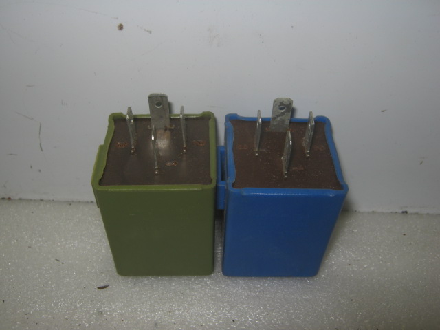

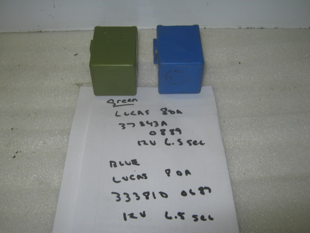

The illusive wiper relay.... (Jon and I are chatting offline about it)....
David
shop.EverydayXJ.com
Attached Thumbnails Looking for Electrolux wiper delay relay DAC6534-img_1471.jpg   Looking for Electrolux wiper delay relay DAC6534-img_1472.jpg

Old Mar 11, 2016 | 08:39 PM
davidboger's Avatar
Joined: Jan 2007
Posts: 699
Likes: 263
From: North Carolina, USA
Doug....
Beats me... they are both marked 6.5 seconds (delay)..

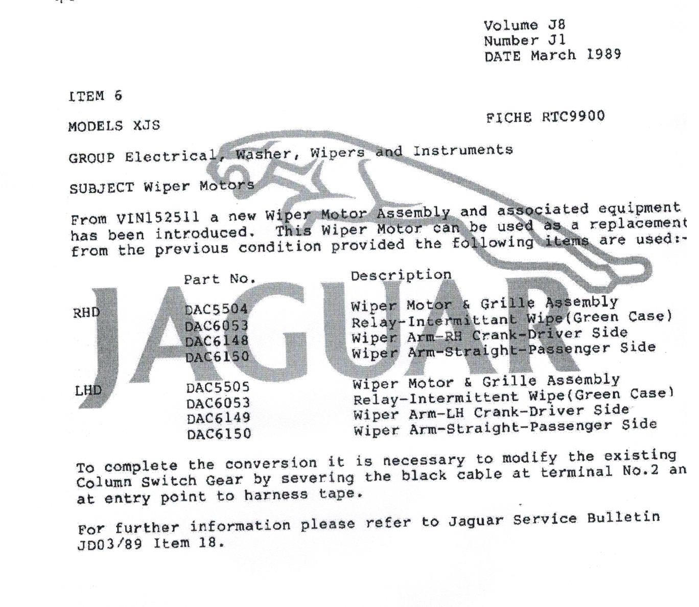

There was a TSB introducing the new wiper assembly... and it notes that the green relay has to be used....
David
shop.EverydayXJ.com
Attached Thumbnails Looking for Electrolux wiper delay relay DAC6534-001.jpg

I found this picture
Attached Thumbnails Looking for Electrolux wiper delay relay DAC6534-%24_57-3-.jpg
