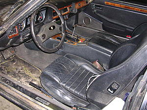

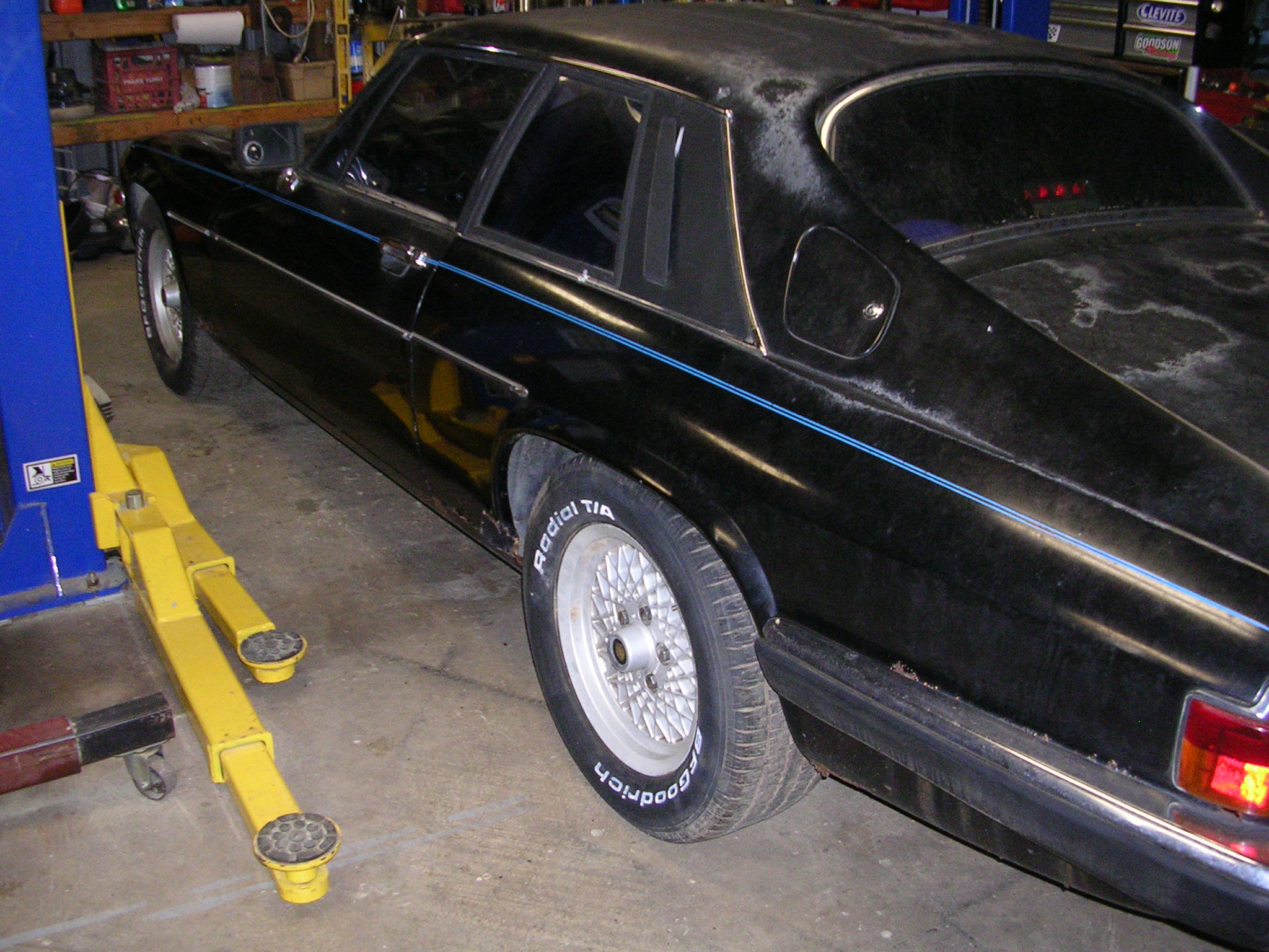

Well I finally got lucky, and found a 89 XJS Parts Car. Virtually identical to mine. The biggest difference is this one hasn't been on fire and I've even gotten it to run. So I'm way ahead of where I was when I started this thread. I promised pics so here they are.
The interior is very usable and looks much better then the pics. It's nice and black, not gray as it looks in the pics. So everything to repair mine, is there. Even the wood trim is decent. It will need a little refinishing, but it's at least intact. I wish the parts car wasn't so rusty, as I would be tempted to use the whole car, but coming out of New York originally, and having made regular trips between Louisiana, and New Jersey. There's just way to much rust, I had to put a piece of 2x4 between the right front lift point, and the pad on the lift. To raise it off the ground so I could inspect the underside. and wow is it gone. So It's a case of rip 2 cars apart, and build 1.

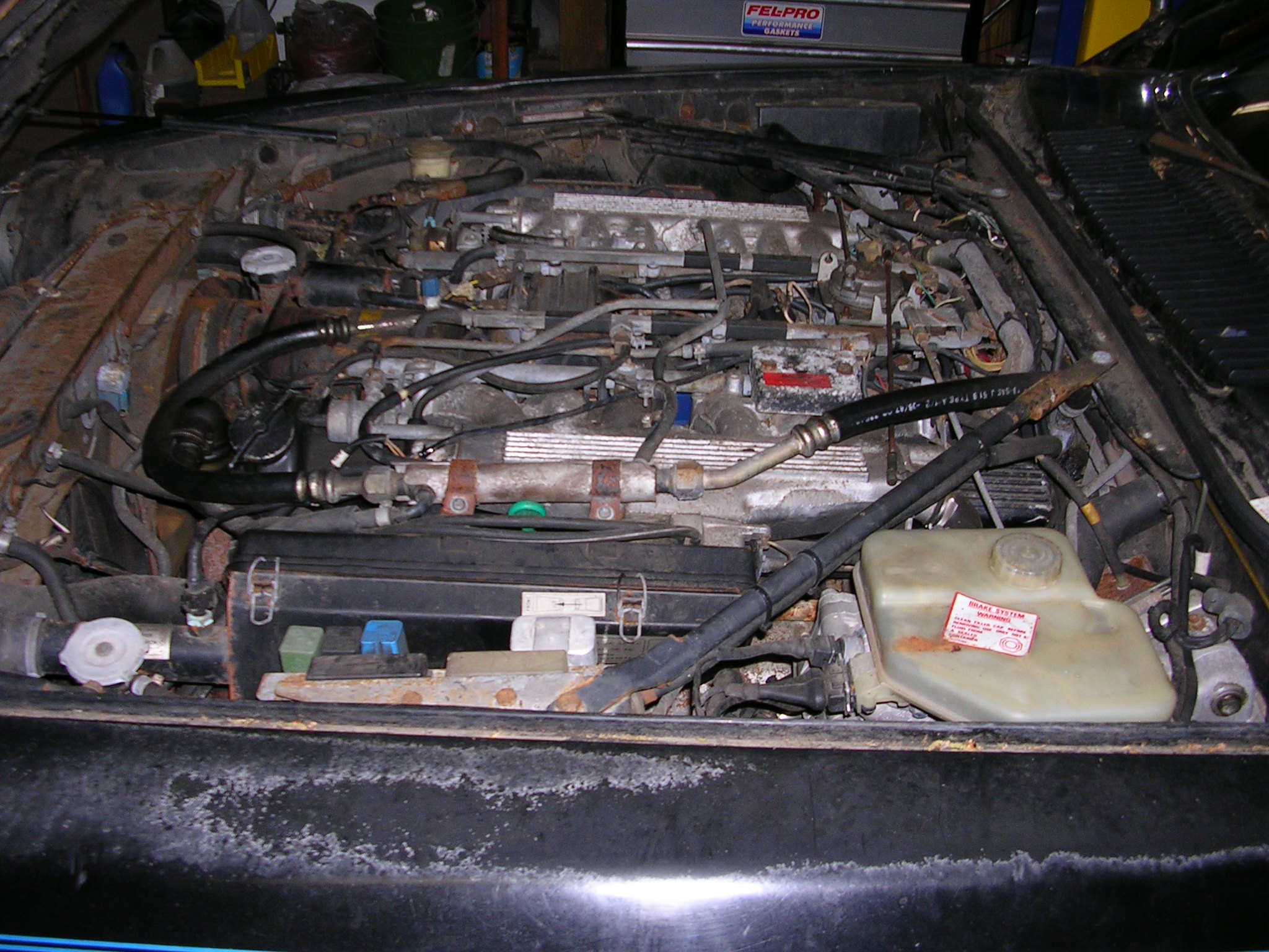

So the build has slowly continued. I have worked on getting the engine to sit on the mounts, and had to create mounts of my own design, as "NO ONE" makes parts, or a kit for what I'm trying to accomplish. Here are some pics of the engine compartment where I had to cut the rear portion open, due to the exhaust comes out of the Ford heads at roughly a 45 degree angle opposed to the V12's going straight down. I have simply cut open areas that weren't critical, in that they were just dead space. Nothing vital thank God. So I went to work building the motor mounts. Trying to use the Jag mounts if possible. I used the passenger side as it was, and constructed a mount to go back to the original mount bolts but since the Ford mounts are set back 10 to 12 inches behind the Jag mounts it was a challenge. The drivers side was more challenging as you have the Oil filter coming out the left front corner on the block, and constructing a mount means it must go around the area and still be strong enough to hold this Monster. So The DS, mount has about 10 hours fab time, and the PS, has about 6 hours fab time total. but I utilized the Jag biscuts, and the engine is sitting solidly on the mounts. Now to see if I can modify the Jag trans mount to hold the back end up, and it will officially be installed.
