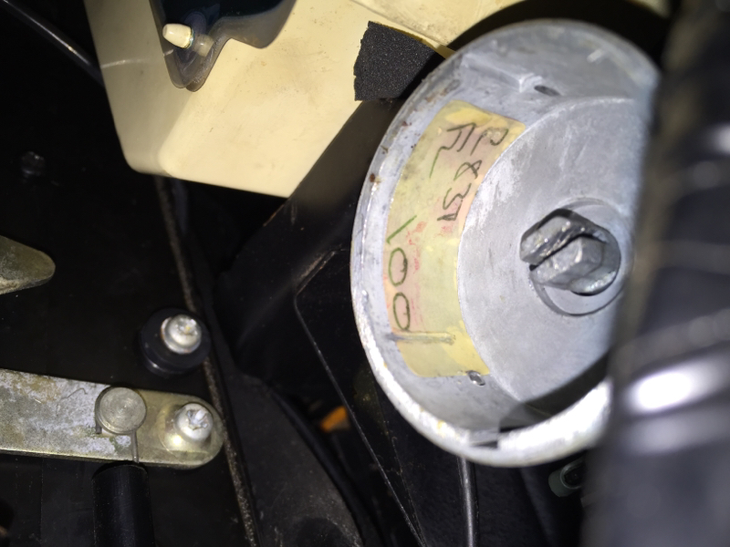

On the back of the ignition switch under the dash is a grub screw on the side, loosen it and the back will pull off, on the inside is a sticker with numbers inked on it, it's the code the locksmith needs to cut your key.

Did not find a sticker so if i have to change the lock how do i remove it, i can see 2 what look like pins holding the lock against the steering column.
