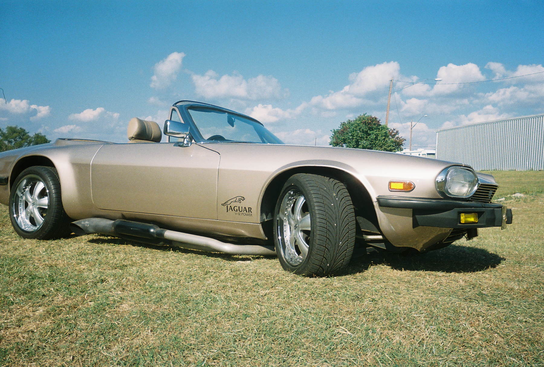

the wide tire look accented!! plus an exhaust you can hear.
might be a little over the top,tho.
Attached Thumbnails Mags/rims on an XJS-r1-07368-013a.jpg
