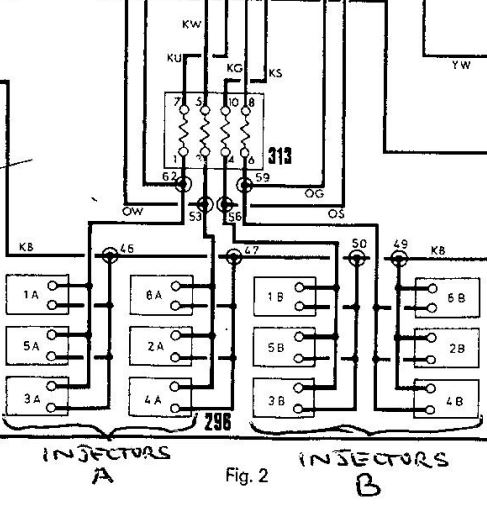

That looks an Amazing Job but what are KB wires?

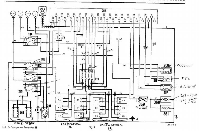

If you look back further in the thread it will make more sense but the KB wire is the wire common to all the injectors. KB = Pink/Black in Lucas Terminology. I adopted the name for my "KB" wire but I just used plain pink as it was all I could get.
Check out the print down the bottom and you will see. It is switched through at the left, goes to each injector then back to the ECU on the right.
So basically you have voltage on one side of your injector coil ready and waiting as soon as switch 312 is on. Then, the circuit is complete once you get a firing pulse from the ECU (one of the other 4 colours) which will energize the coil inside the fuel injector for the specified period of time.
Attached Thumbnails Making a new Injector Harness for the H.E-injector-loom.jpg   Making a new Injector Harness for the H.E-injector-loom-zoom-out.jpg
