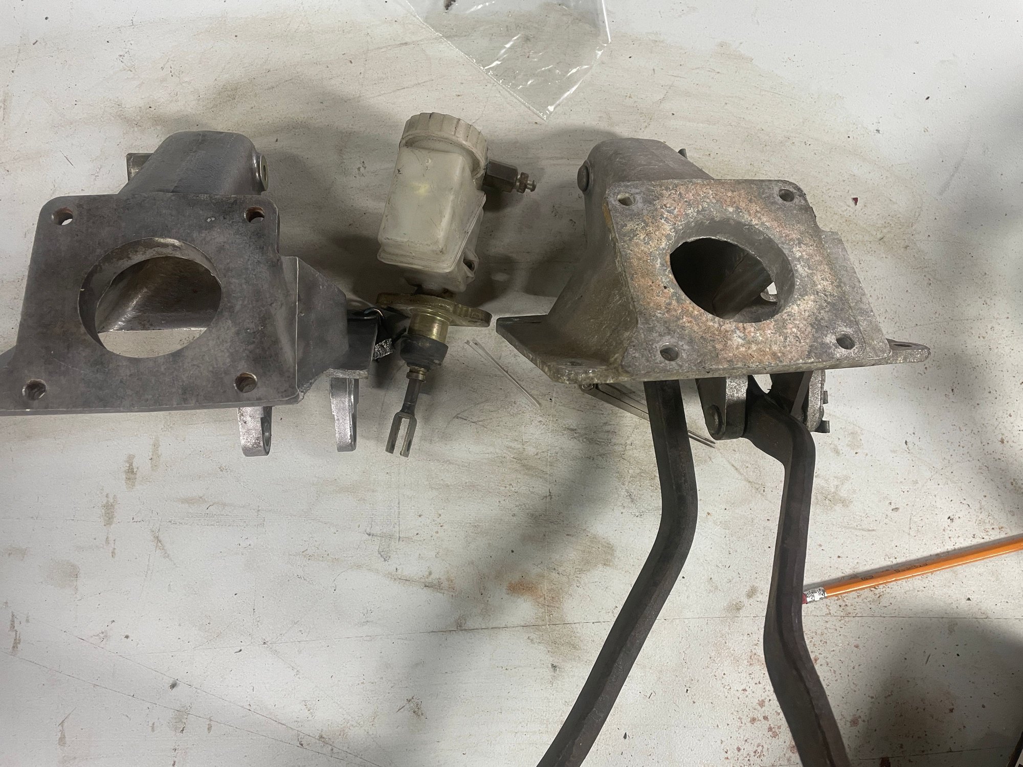

I had been collecting parts to do a manual swap.
Eventually I got a Cabrio with a manual in it already.

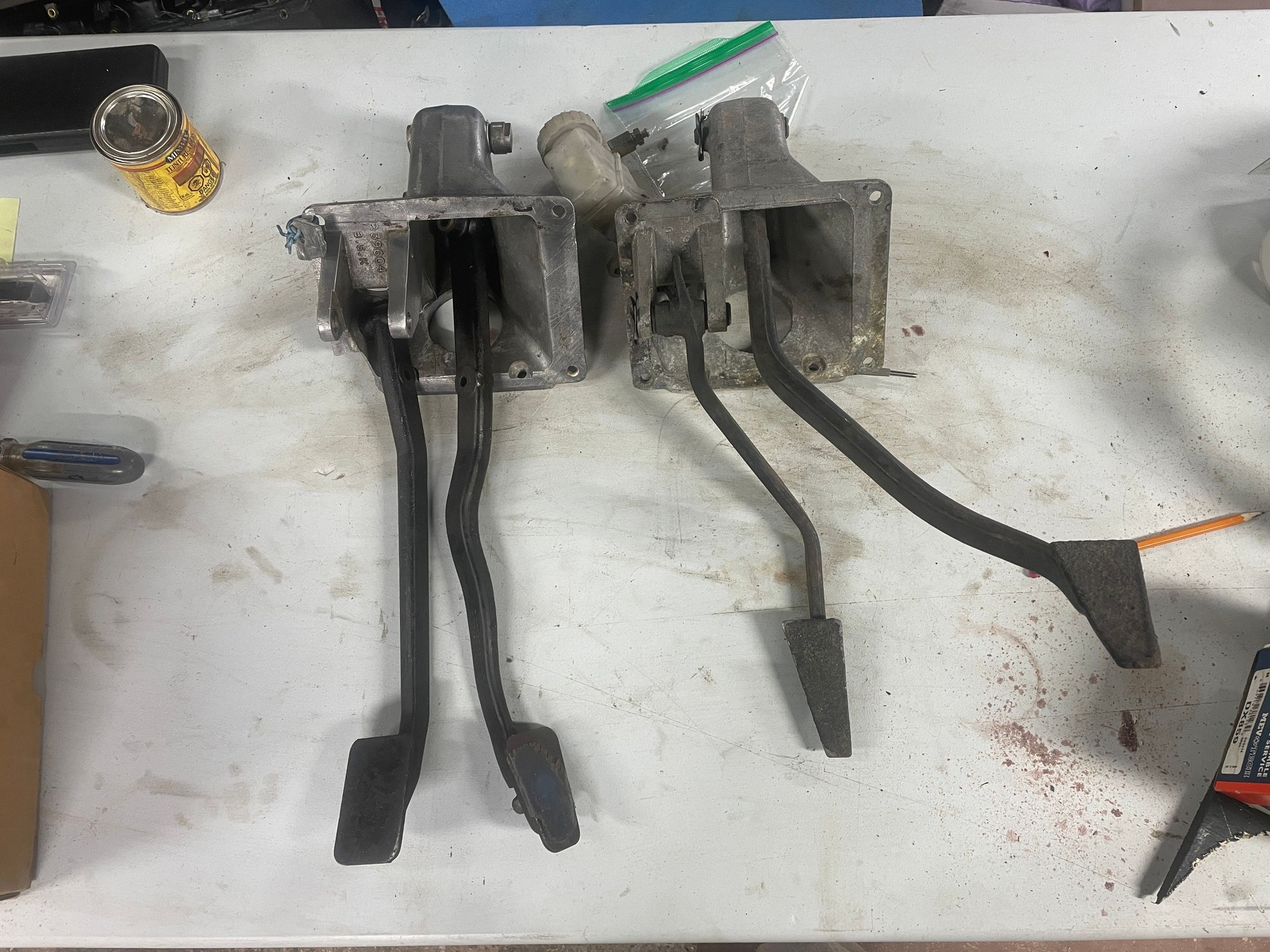

I'm going to sell these, but can't tell if the pedals are correct and useful.

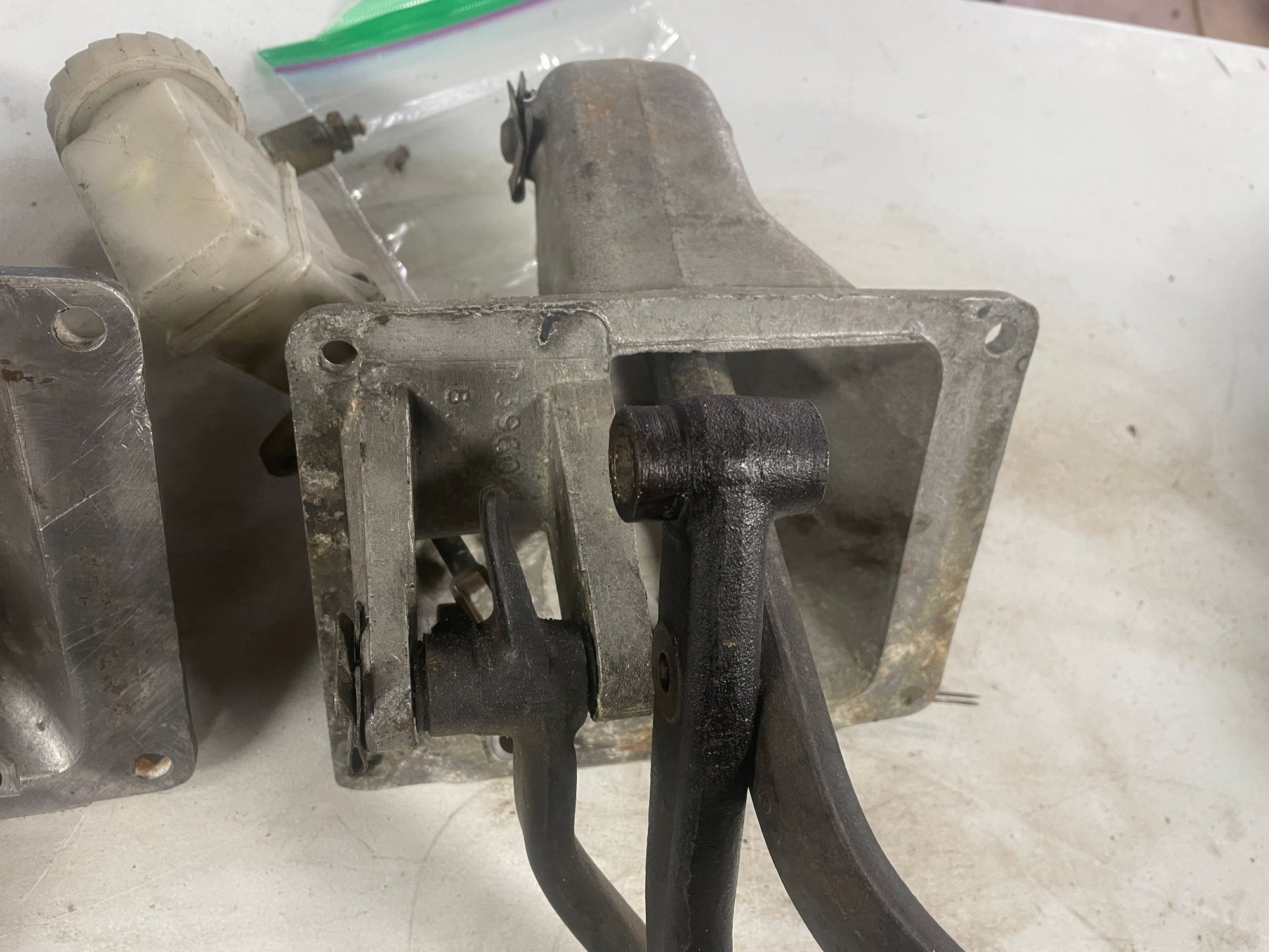

The box on the right seems correct, it has a spring to return the brake pedal, and has a tang to operate the clutch cylinder, although it's broken. I can't tell if the pedals are for RHD or LHD.

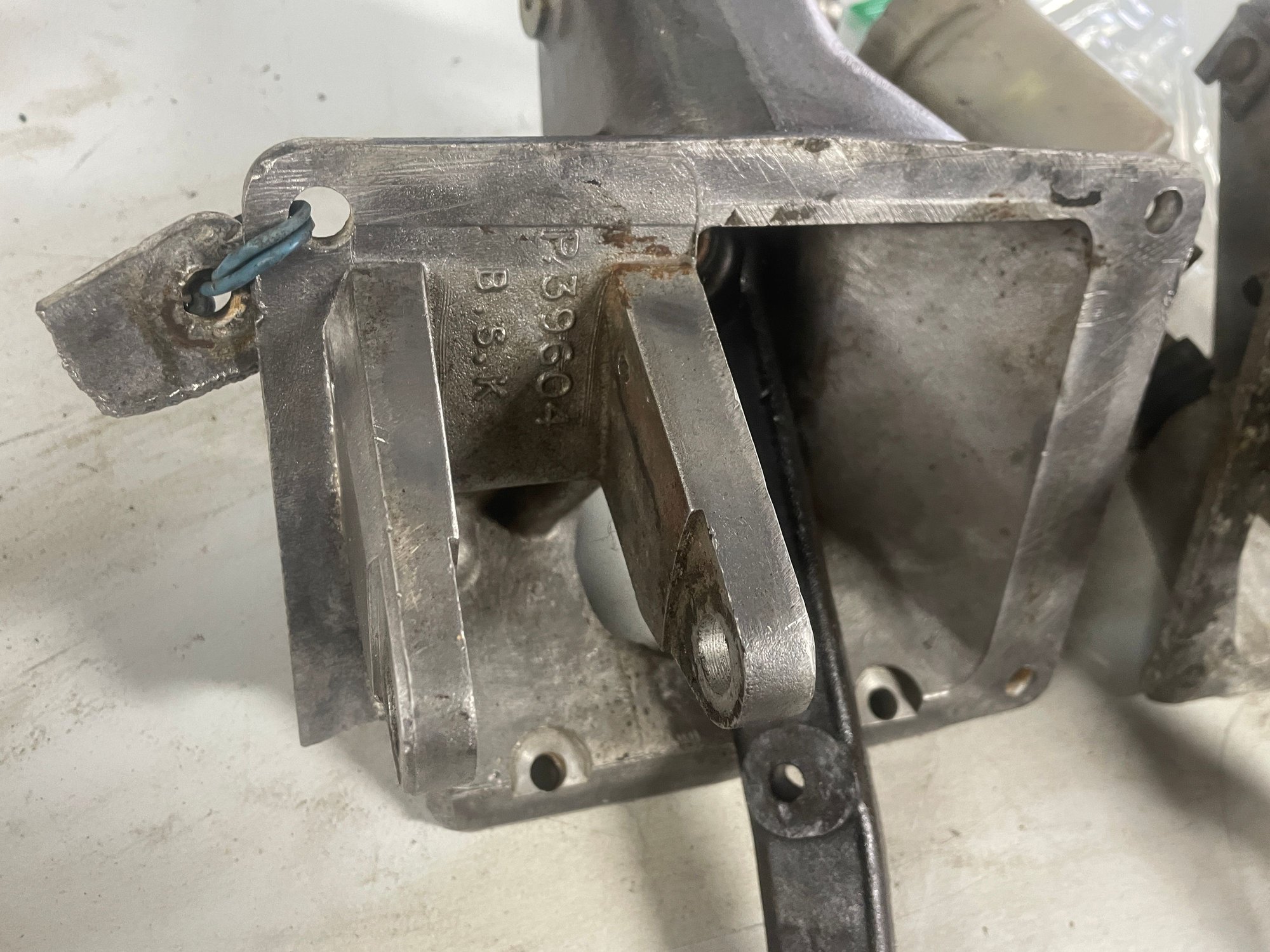

The left box has a broken corner, wrong length clutch pedal without tang to operate the clutch cylinder, incorrect shaft to hold the end of the brake pedal to the box, and the brake pedal is bent differently, perhaps to change it from LHD to RHD?
This is a bit of a mess I'm afraid.
Can anyone tell me what's good here, and what's wrong please.

Looks like you've got a mix of some very old pieces (the right side box in the first pic looks like early XJS) and the left side looks like a manual pedal box casting (although broken), a mismatchedbrake pedal, and an odd clutch pedal, maybe from a different Jag model.
I might be interested in the set here if reasonable- maybe I can make one good LHD box out of it all. Send me a PM with what you're asking and we'll see
