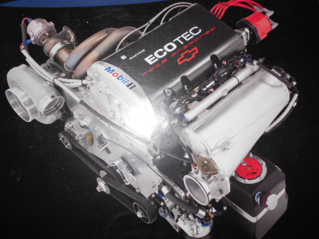

pic of large plenum ,big TB, 2.0L produces over 1000hp, TURBO.
Attached Thumbnails Minimum to run Lucas EFI on 5.3 v12-chevy-ecotec-turbo-002.jpg

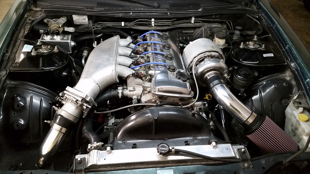

I'm a sucker for turbo 4cyl motors, here's mine in my 240sx, I think I mentioned it earlier in this thread.
The manifold was made using mandrel bent 4" tube and plate. 57mm turbo, 90mm throttle body, 750cc injectors. I'm currently building a new crank case vent system as you can probably see.
